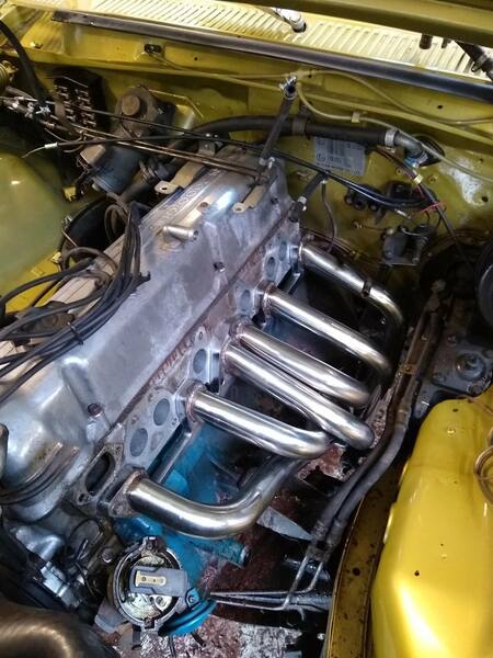

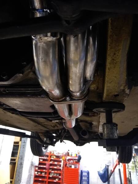

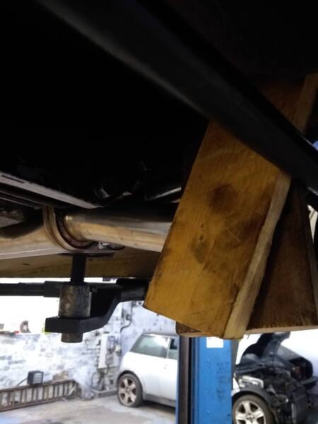

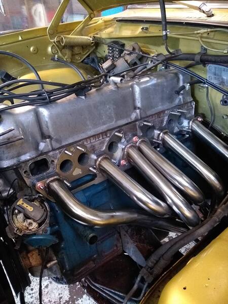

Heidel_Kakao Posted October 20, 2019 Author Share Posted October 20, 2019 Spoiler alert, I made it fit Here's the story of how I got to this point. I started by attaching the exhaust manifold and inlet manifold, I used new stainless studs and copper nuts for every hole, rather than the original combination of studs and bolts.Halfway there. Then I made the 2-1 collector fit. It took a combination of hitting it with a hammer Roadkill style to clearance it a bit and using some wood to wedge the manifold closer to the chassis rail while I installed it. It touches the transmission sump pan which isn't ideal but I think it will be ok, I might be able to make some clearance when I get the rest of the exhaust line done. It will be a little while before I get it completed though as I need to save up some spare cash. The 02 sensor was further back than before but I rerouted the cable and got enough slack for it fit. On 10/13/2019 at 9:30 PM, 320touring said: Fair point - carbs back on please and a video of it without exhaust:) Just for you It sounds brutal like this lol. Shirley Knott, JeeExEll, Skizzer and 12 others 15 Link to comment Share on other sites More sharing options...

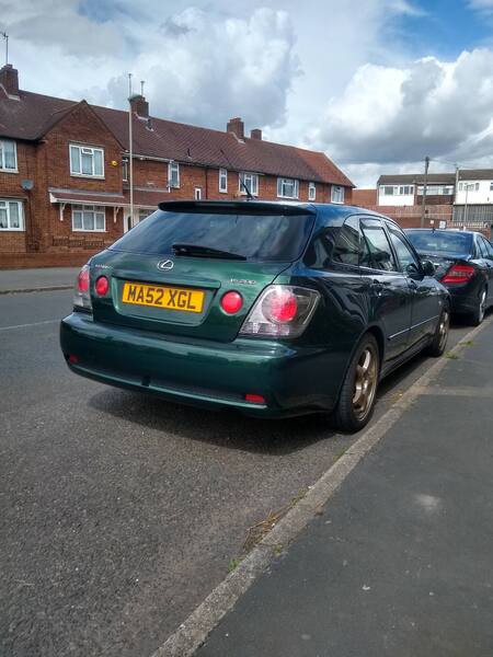

Heidel_Kakao Posted April 28, 2020 Author Share Posted April 28, 2020 No exciting updates to report I am afraid ☹️ Lockdown combined with a mild case of mojo loss has put paid to that. However I have started to think about what my next estate will be so I thought I would crowd source some suggestions. After driving the Lexus for the past few months and getting used to it's "modernness" (it's the first car I have owned without a suffix or prefix plate) I've decided my next wagon should be a late 90's to early 2000's model and my short list is currently BMW E39, Vauxhall Omega, Subaru Legacy, a Mercedes from that period etc. My preference is for big petrol engined RWD executive barges though after the Impreza I would like to try it's bigger brother which is why the Legacy is on the list. So does anyone have opinions positive or negative on the cars on my shortlist or have any suggestions for cars I may have overlooked? Over to you richardmorris 1 Link to comment Share on other sites More sharing options...

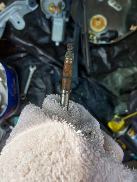

Heidel_Kakao Posted March 16, 2021 Author Share Posted March 16, 2021 Some actual car working on took place today! The Sportcross has been a nice reliable daily driver but had recently developed a fault with the rear wiper motor in that it was very slow to wipe and got stuck also. Pretty annoying when you are used to having a rear wiper. I bought a whole tailgate from a local Lexus breakers as I thought it may come in useful anyway. It was certainly helpful in figuring out how the old motor assembly came out for sure. Here is the offending unit, after a lot of faffing I got it off the car and also got the one off the spare tailgate, turns out the one off the spare was completely dead. So in for a penny in for a pound I took apart my original unit to see what was going on inside. Initially it looked fine but the issue was the output shaft was almost completely siezed causing a stupid amount of friction. A lot of brute force later and I got it punched out of the casing and you can see how corroded the shaft was. So a bit of cleaning up with some emery cloth and plenty of grease later I got it reassembled and it now works perfectly 👌 In fact it works better than it ever did, it must have been getting progressively worse for a while until it finally siezed. Cheers to Jez @tommotech for lending assistance, tools and advice. Asimo, Dick Longbridge, Jenson Velcro and 8 others 11 Link to comment Share on other sites More sharing options...

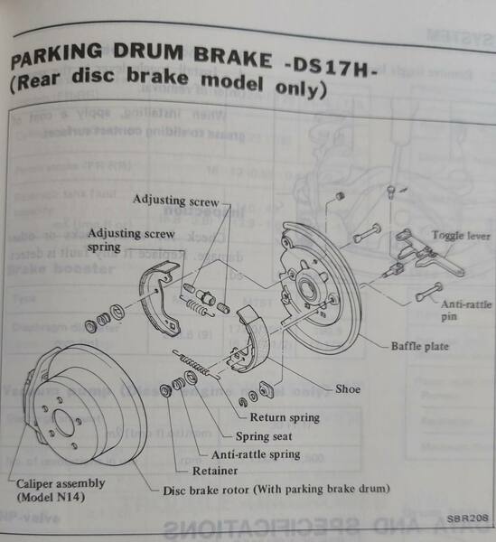

Heidel_Kakao Posted April 9, 2021 Author Share Posted April 9, 2021 So with my recently improved motivation I have been doing the few jobs that have been keeping Cedric off the road for well over a year now. Jez helpfully made me a rear brake pipe as the old one just twisted when trying to undo it. We tried to bleed the brakes today but realised the rear calipers on both sides were doing nothing and the pistons are totally siezed, so I will be dropping them off at Bigg Red in Worcester next week to be completely overhauled. I also need to find a way of protecting the power steering hoses as the new manifold runs very close to them. I was thinking of wrapping them in reflective heat shield tape. https://www.ebay.co.uk/itm/164140123634 Anyone got any experience of this stuff? I also need to repair the throttle linkage that I ham fistedly broke when refitting the carbs. And then just need to take the car round to the nearest Powerflow exhaust center to get the rest of the system finished and then it should be ready for the road. Can't wait to hear what it will sound like 😀 Don't think I have put these in the thread before, Cedrics looking super cool while being rally support vehicles! Shite Ron, Spottedlaurel, Dan_ZTT and 9 others 12 Link to comment Share on other sites More sharing options...
somewhatfoolish Posted April 9, 2021 Share Posted April 9, 2021 On 3/16/2021 at 7:50 PM, Heidel_Kakao said: Some actual car working on took place today! The Sportcross has been a nice reliable daily driver but had recently developed a fault with the rear wiper motor in that it was very slow to wipe and got stuck also. Pretty annoying when you are used to having a rear wiper. I bought a whole tailgate from a local Lexus breakers as I thought it may come in useful anyway. It was certainly helpful in figuring out how the old motor assembly came out for sure. Here is the offending unit, after a lot of faffing I got it off the car and also got the one off the spare tailgate, turns out the one off the spare was completely dead. So in for a penny in for a pound I took apart my original unit to see what was going on inside. Initially it looked fine but the issue was the output shaft was almost completely siezed causing a stupid amount of friction. A lot of brute force later and I got it punched out of the casing and you can see how corroded the shaft was. So a bit of cleaning up with some emery cloth and plenty of grease later I got it reassembled and it now works perfectly 👌 In fact it works better than it ever did, it must have been getting progressively worse for a while until it finally siezed. Cheers to Jez @tommotech for lending assistance, tools and advice. Fixing the rear wiper motor on the family chariot was my teenage introduction to shite maintenance; it was a montego estate and exactly the same thing had happened, and likewise it worked better than ever afterward. Heidel_Kakao 1 Link to comment Share on other sites More sharing options...

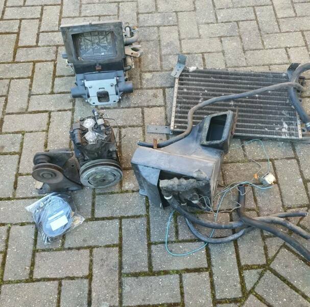

Heidel_Kakao Posted April 18, 2021 Author Share Posted April 18, 2021 https://www.ebay.co.uk/itm/174728433095 Just won this for £5 on Ebay, no one else even bid. Will be the basis of an A/C install on Cedric at some point in the future. Is anyone nearby to Wallingdon that could collect it for me? Would save me having to drive to London. Cheers. puddlethumper, mat_the_cat, LightBulbFun and 5 others 8 Link to comment Share on other sites More sharing options...

RobT Posted April 19, 2021 Share Posted April 19, 2021 18 hours ago, Heidel_Kakao said: https://www.ebay.co.uk/itm/174728433095 Just won this for £5 on Ebay, no one else even bid. Will be the basis of an A/C install on Cedric at some point in the future. Is anyone nearby to Wallingdon that could collect it for me? Would save me having to drive to London. Cheers. I'm 8 miles from Wallington, assuming it's the one near Croydon. Happy to collect for you, PM the details if so. Heidel_Kakao and Skizzer 1 1 Link to comment Share on other sites More sharing options...

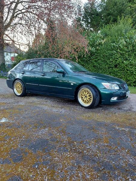

Heidel_Kakao Posted April 22, 2021 Author Share Posted April 22, 2021 The wheels that came with Cedric suit the Sportcross much better! Just need to buy some centre caps. @tom13 @sims00 Pat Earrings, Dave_Q, mitsisigma01 and 3 others 6 Link to comment Share on other sites More sharing options...
tom13 Posted April 22, 2021 Share Posted April 22, 2021 41 minutes ago, Heidel_Kakao said: The wheels that came with Cedric suit the Sportcross much better! Just need to buy some centre caps. @tom13 @sims00 Yes dude. Looks ace. If you want to sell the wheels that came off it let me know. I spent ages refurbing them. Link to comment Share on other sites More sharing options...
Heidel_Kakao Posted April 22, 2021 Author Share Posted April 22, 2021 11 minutes ago, tom13 said: If you want to sell the wheels that came off it let me know. I spent ages refurbing them. Will do mate. Planning on keeping them at the moment. Link to comment Share on other sites More sharing options...
tom13 Posted April 22, 2021 Share Posted April 22, 2021 27 minutes ago, Heidel_Kakao said: Will do mate. Planning on keeping them at the moment. No worries dude. You should definitely tint those lower fogs yellow. Would look ace with the gold. Link to comment Share on other sites More sharing options...

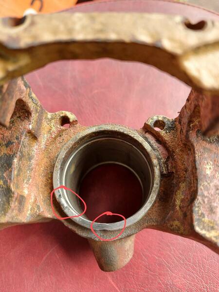

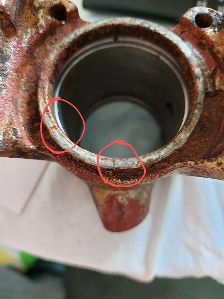

Heidel_Kakao Posted April 23, 2021 Author Share Posted April 23, 2021 Potential hurdle, Bigg Red just sent me this picture, one of the rear calipers has a hairline fracture in it 😞 Already put the call out on the Datsun Facebook group and checked ebay but no joy yet. Any ideas where else I can try? Link to comment Share on other sites More sharing options...
