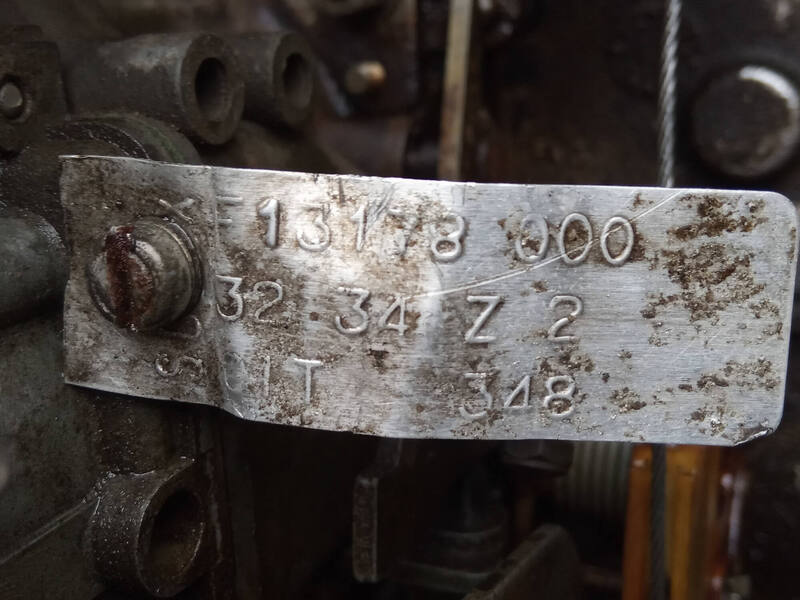

strangeangel Posted March 5, 2020 Author Posted March 5, 2020 So, today @djimbob and I did have at it again. First off, new spark plugs. What are the gaps? Fuck knows, and the interweb reveals nothing remotely useful, so we text the ever-obliging @Cleon-Fonte (who is busy elsewhere with his own problems). Much later, we discover the not one, but two HBOLs in the boot, along with the jack and about 11 hubcaps... We have great difficulty getting the plugs out of the head, because our plug spanners are either too short to reach the hex bit of the plug, or are the length of the Iraqi Supergun and thus impossible to deploy thanks to the orientation of the suitcase engine. After some thought, Jim goes to the garage, and returns with a big fuck off reciprocating saw... With great precision*, he lobs one of the plug spanners in half, beats one end flat with his best hammer and proceeds to drill a hole through the flat end. Sorted! We remove the plugs, and replace them with the new ones, after gapping them and attaching the big extension things that allow them to sit so low in the head. The old ones, while very sooty, don't look that bad. On to the HT leads. The set of leads - so carefully identified by number as being the the correct set - bear no resemblance to the ones on the car. Outstanding. The rubber boot things on the dizzy cap ends are completely different, and we have to swap these over to make the new ones fit. The coil lead supplied was about 3" long, with the wrong plug on both ends, so we'll have to buy another one to replace that with. All this done - and a ropey looking low tension connector to the coil replaced - we fired her up. It started quickly, and idled quite well, if a bit fast. Once warmed up, we tried revving it and, to our dismay, the misfiring is still present. Mucho coughing and farting. Bastard. Much as I enjoy the man's programmes, I didn't feel like rebuilding the carb Keith Floyd-style on a trestle table in Jim's yard (although by this time, a large glass of red might well have been welcomed). So, off it came and into the boot of the BX it went. It's on the bench in my garage at the moment, with all the screw heads soaking in penetrating fluid in anticipation of my attacking it, hopefully next week. I really hope rebuilding the old Solex cures the problem, because we're all out of ideas if it doesn't. Skizzer, somewhatfoolish, egg and 9 others 12
Dave_Q Posted March 5, 2020 Posted March 5, 2020 I hear @Cleon-Fonte has got loads of old Solexs now, one of them will surely fit ? Cause the French were always quite good at making things interchangable. Right? somewhatfoolish, Cleon-Fonte, strangeangel and 1 other 2 2
vulgalour Posted March 5, 2020 Posted March 5, 2020 If your misfire is a lack of fuel rather than a lack of spark could it be a sticky carb component or a weak fuel pump diaphragm? Perhaps both.
strangeangel Posted March 5, 2020 Author Posted March 5, 2020 21 minutes ago, vulgalour said: If your misfire is a lack of fuel rather than a lack of spark could it be a sticky carb component or a weak fuel pump diaphragm? Perhaps both. The pump was something we spent a lot of time on when it was at @KruJoe's place, and it seems to deliver plenty of the good stuff up to that point. I have bought a rebuild kit for the carb, and that's the next action. If that doesn't work, then we'll be throwing the floor open to anyone with ideas!
vulgalour Posted March 6, 2020 Posted March 6, 2020 Could be a worn and/or sticking needle then at that. Or something else entirely, because old cars.
Cleon-Fonte Posted March 6, 2020 Posted March 6, 2020 Sorry I couldn't make it over today, I was dishing out abuse to spark plug spanners with you in spirit. The whole plug lead saga sounds like a fucking nightmare. Hopefully a carb rebuild sorts things, considering the terrible reputation with which old Solexes suffer I've found that you can usually swap out anything that could potentially cause trouble and parts availability for these BX carbs appears to be good. High idle does sound like it's out of adjustment which won't be helping. 3 hours ago, Dave_Q said: I hear @Cleon-Fonte has got loads of old Solexs now, one of them will surely fit ? Cause the French were always quite good at making things interchangable. Right? All we need to do to instantly solve our running issues is swap this BX for a 1970s small Renault, then we'd have a lifetime supply of new carbs (along with a lifetime supply of ferric oxide, probably). Amazingly the French managed to make them relatively non-interchangeable even with an identical engine, much as I'd love the BX to serve as a dumping ground for my excess Solexes. If only we were in Bordeaux and could pop to the Solex shop in town to get it sorted. Dave_Q, stonedagain, strangeangel and 2 others 3 2

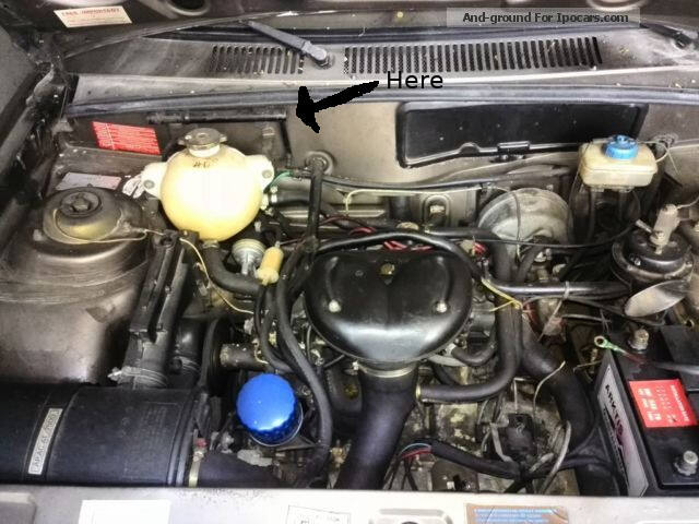

Talbot Posted May 11, 2020 Posted May 11, 2020 On 3/5/2020 at 8:29 PM, strangeangel said: We have great difficulty getting the plugs out of the head, because our plug spanners are either too short to reach the hex bit of the plug, or are the length of the Iraqi Supergun and thus impossible to deploy thanks to the orientation of the suitcase engine. IIRC there should be a spark-plug tool supplied with the car. Just about every suitcase engine'd car I've seen has one. If yours is missing, that's what the two random clips under the bonnet are supposed to be holding. It's pretty basic, as it's just a pressed tubular socket with a handle welded in to it, but it is of course exactly the correct length. strangeangel, rob88h and somewhatfoolish 3
strangeangel Posted May 11, 2020 Author Posted May 11, 2020 29 minutes ago, Talbot said: It's pretty basic, as it's just a pressed tubular socket with a handle welded in to it, but it is of course exactly the correct length. I know the sort of thing you mean, but I don't recall seeing one... which is not the same as saying it's not there, I know!
Talbot Posted May 11, 2020 Posted May 11, 2020 I can only find a picture of a samba with one online. I'm absolutely sure I've seen the same in a BX engine bay with a suitcase engine, Just can't recall where. Are there two clips with nothing in them anywhere? if so, that's where it should be. strangeangel and somewhatfoolish 2
