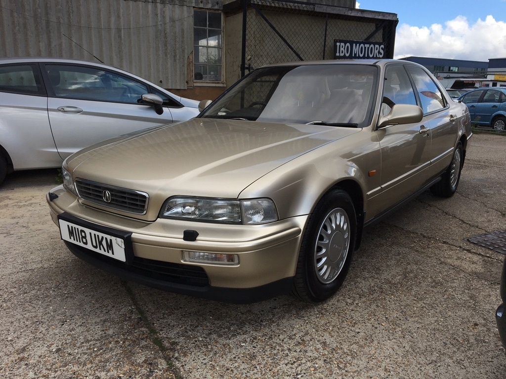

But it's a Honda. Not only a Honda, but a Honda from the correct generation.
Did I mention that it's a Honda??
