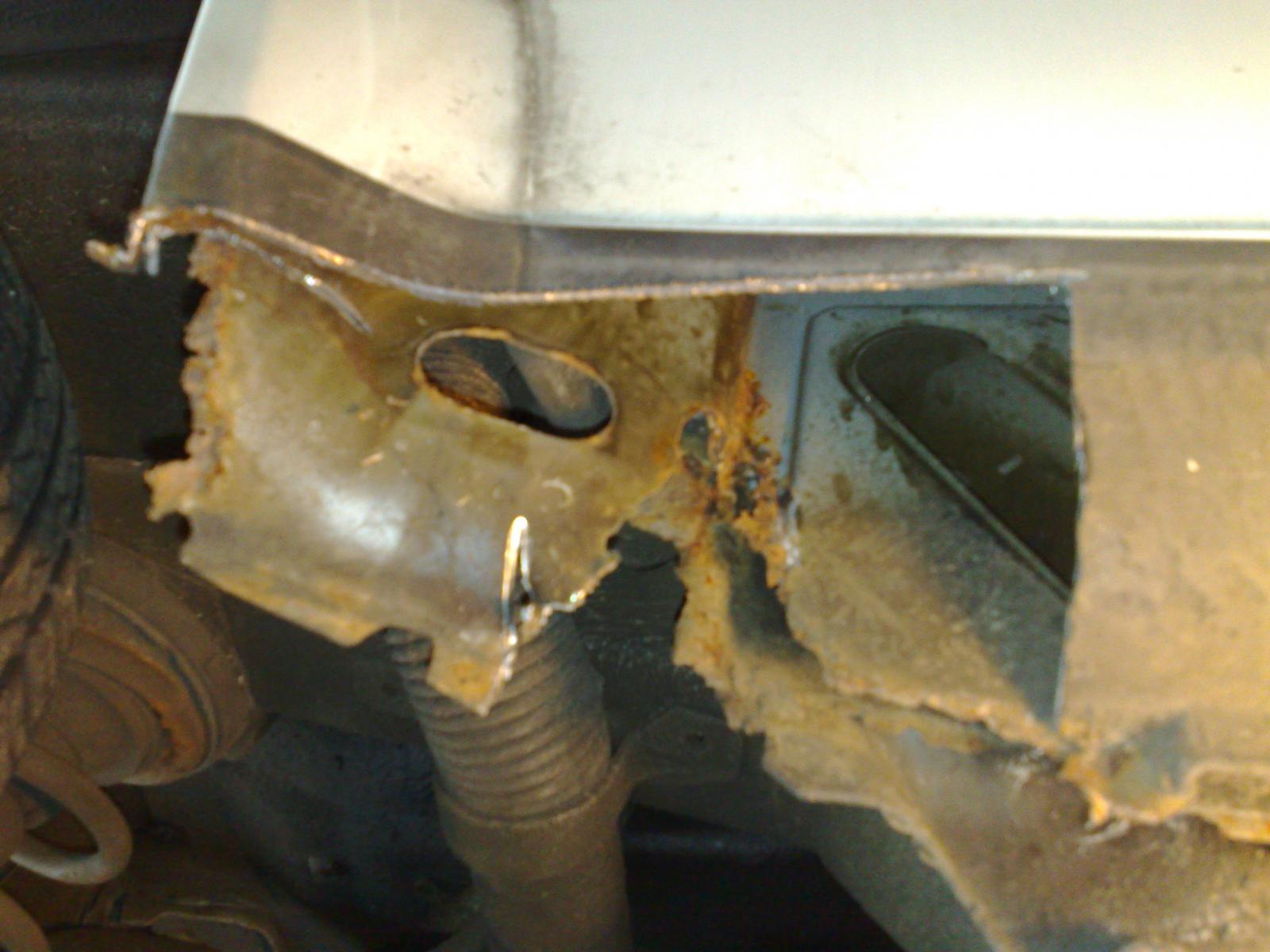

As has been said, its the rust thats the primary concern, the inner sills rust away from both the floor and the outer sill and theres complex (ish) reinforcement panels sandwiched in the rear, plus the suspension training arm prevents access from the inside. In places its a 4 layer sandwich with fold-over tags and spot welded together. I did mine about 5 years ago and initially cut away the outer sill, then found there wasnt enough access, so had to cut up into the rear wing about 3".
There was also a patch further along the sill along the front edge of the sill that had gone, I used the top roll of a Jag XJ40 door skin to repair it as it has a very similar profile.
They also go at the front of the door step just under the weatherseal (usually a 1" patch).
I have got a pair of roof bars I got for mine, but I`ve not been able to bring myself to drill holes in the roof to fit them, so they might be available..

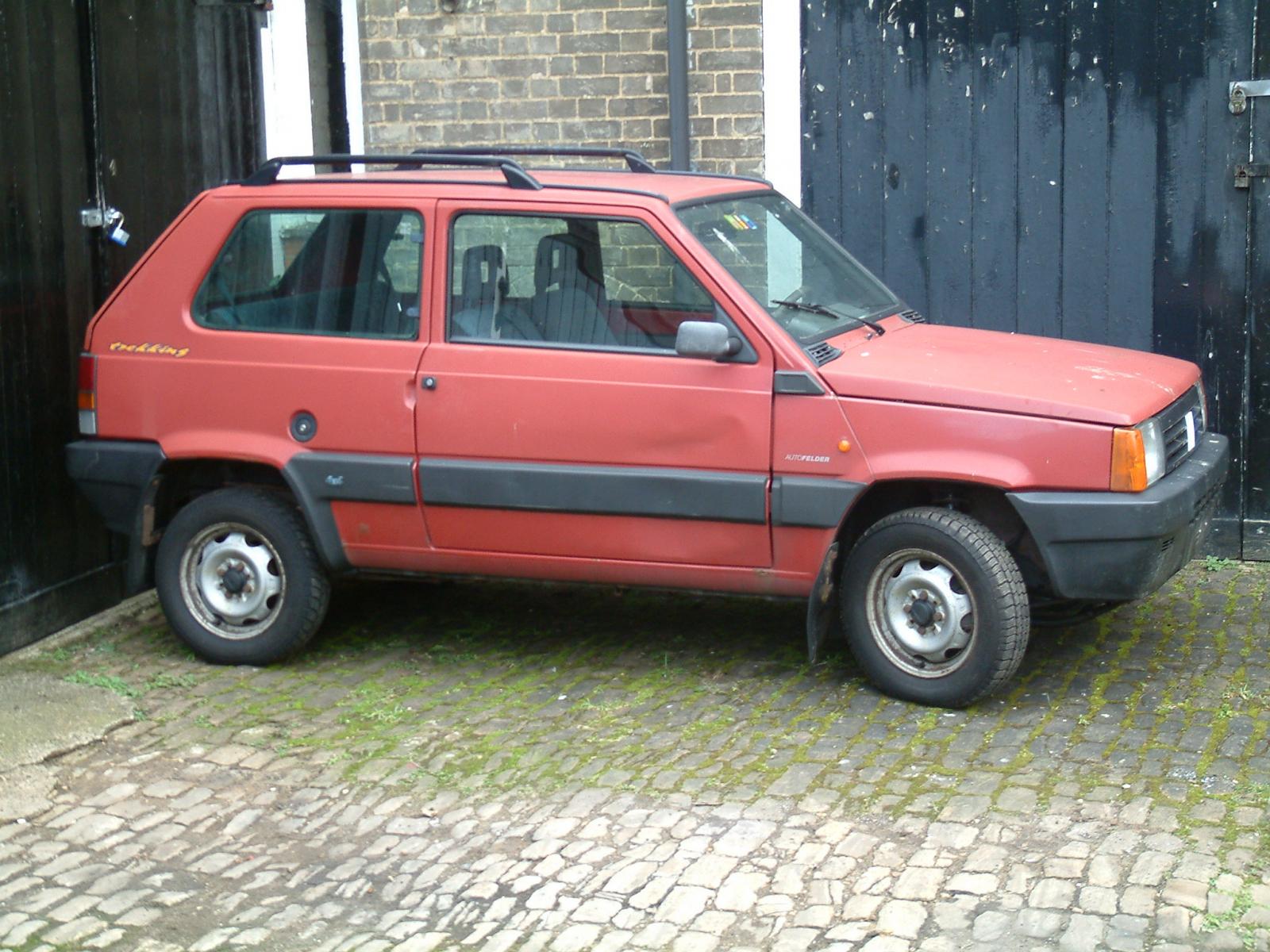

Allow me to confuse you even more.  There were Pandas elsewhere in Pandaland and there still are, here below is a Swiss Panda, in parts of Pandaland they reserve salt for their chips and not as a road dressing so it is possible to find less rotten ones also the back street Panda butchers are banned so the quality of the remaining ones is high and the ratio 4x4 to non-4x4 was higher.
Here is my Swiss Panda 4x4 trekking (it is the model with the fire engine) which cost £0  (in Swiss Euros) for a running no mechanical fault but dented door (you can see the damage) so the cost of the door repair was more then the car was worth hence £0 including the set of winter tyres.  They left their plates and their anydriver insurance for a couple of weeks so I drove I back to the UK  through the Autobahn snow.
post-7239-0-90535300-1492793476_thumb.jpg.
I have a few things available like an original but new set of UK spec headlights still in their boxes.  Have you bought it yet?

Hats off to you that's quite an involved piece of work , I would guess that the labour cost would make it a non starter if you were running one on a buget

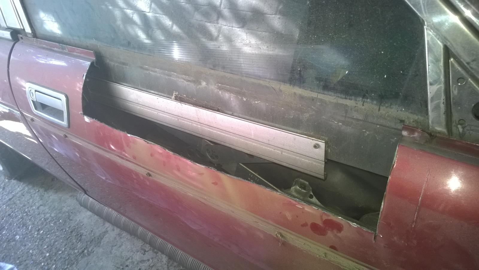

Thats just some of it, had to weld the bottoms of the doors up as well (funny enough, Jag XJ40 door skin & frame bottoms are almost an exact match for the Panda door bottoms too).
I`m a long way from being a great welder, as can be seen from the pics, but I can burn metal together which is pretty necessary if you run 80`s Fiats as dailies.
If you were paying someone to do it, it probably wouldnt be financially viable.
