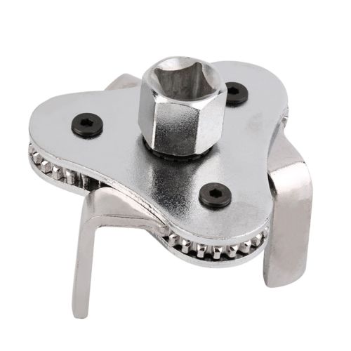

I've got one of these for oil filter removal and it's greatpost-17864-0-26385200-1488917937_thumb.jpg

I've got one of these for oil filter removal and it's greatattachicon.gifs-l500.jpg
I have one of them and have found the need for extra hands to hold it to get it tight enough on the filter is a pain.
Also I can get it to slip,,,,
Chain filter remover is good for removing filter housings.
Got one of those too, great if there is room around the filter.
