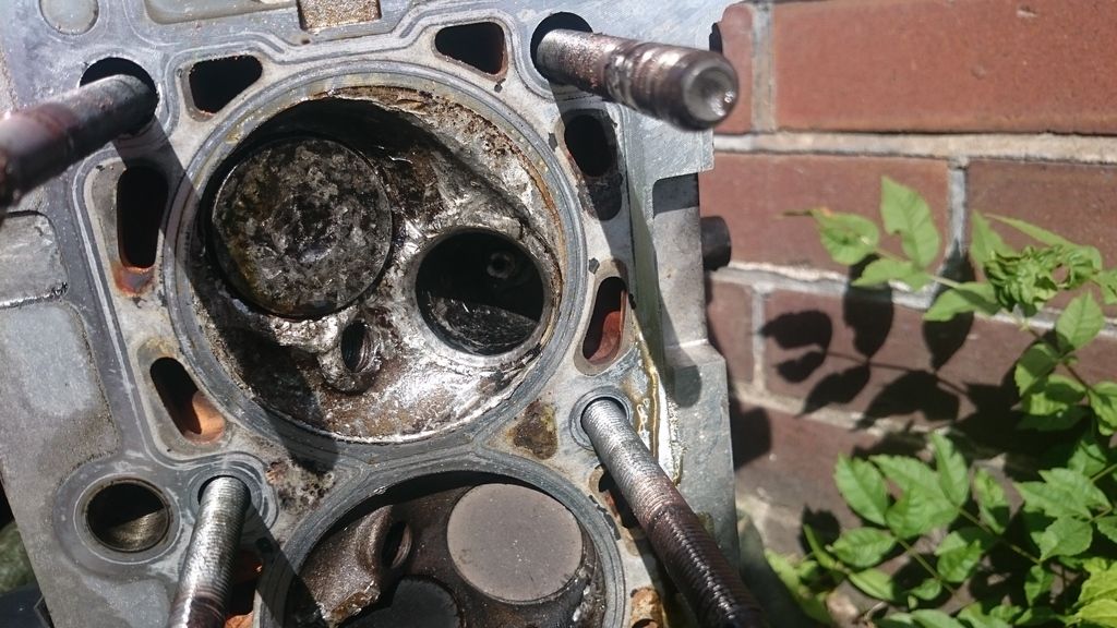

When the water pump on a 1.3 Polo engine hasn't been fitted properly and the belt skips.
Looks exactly like mine did after a snapped cambelt bent a valve. I put a new belt on & drove it, the noise got better for a while & then the head fell of the valve.
They don't run very well like that do they?

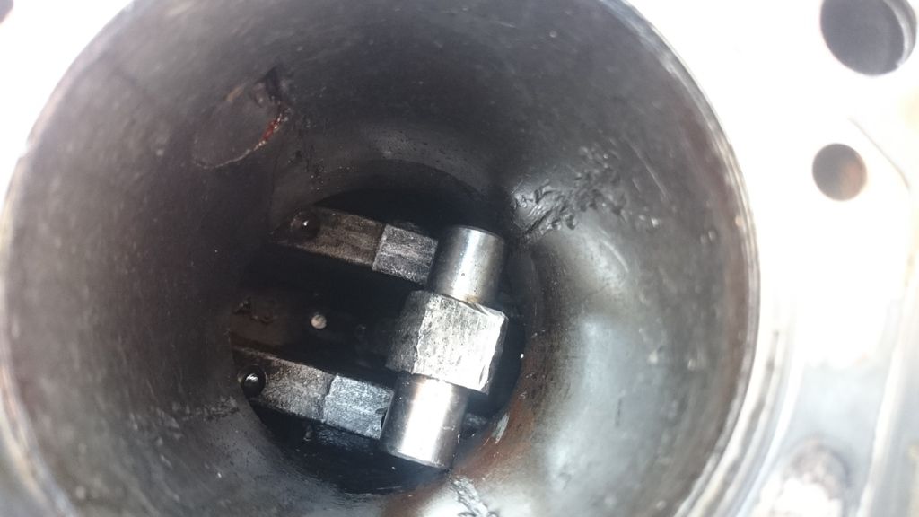

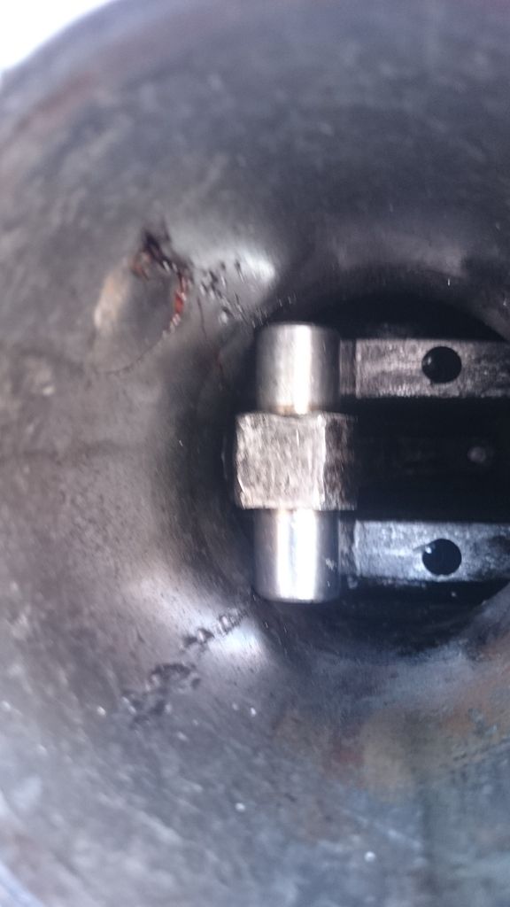

My still current Land-Rover series 3 petrol. It was noisy when I bought it. Why I convinced myself it was okay at the time of purchase will remain one of those great mysteries, however, I managed to drive it for about three years without problem. That is, until one time I was driving back from the Mourne Mountains (by the Northern Irish border for those that don't know) to Belfast when it made an almighty racket. I turn the engine off, give it a minute's thought, and tried starting it again. Oddly the 'death rattle' disappeared as quickly as it had appeared so I drove back home without any further problems.
Fast forward at least another 1000 miles when I'd moved back to my parents' house in South London/Kent way. As I was 'resting' from employment I thought I'd rope my dad into looking into what was causing the noise. We took the head off and immediately saw a crack through the whole of number three piston. On dropping the sump, I then found lumps of metal. When the pistons came out half the skirt of number four was missing - the metal in the sump. The aforementioned noise must have been these bits of metal letting go and then dropping down. It transpired that the previous owner had had the head converted to unleaded and the garage had proceeded to fit the head gasket round the wrong way blocking some of the water ways at the rear. The temperature gauge is at the front of the block hence the rear half of the engine cooking itself without any sign on the temperature gauge. It wasn't some two-bit garage, but a well-known Land-Rover specialist. Anyway, Dad and I rebuilt the thing after Turner Engineering machined and honed the block. Pictures of the mess below including a couple of rebuild shots.
