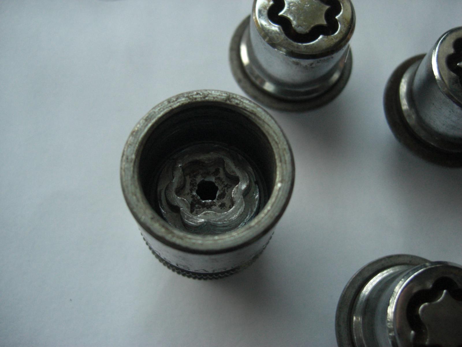

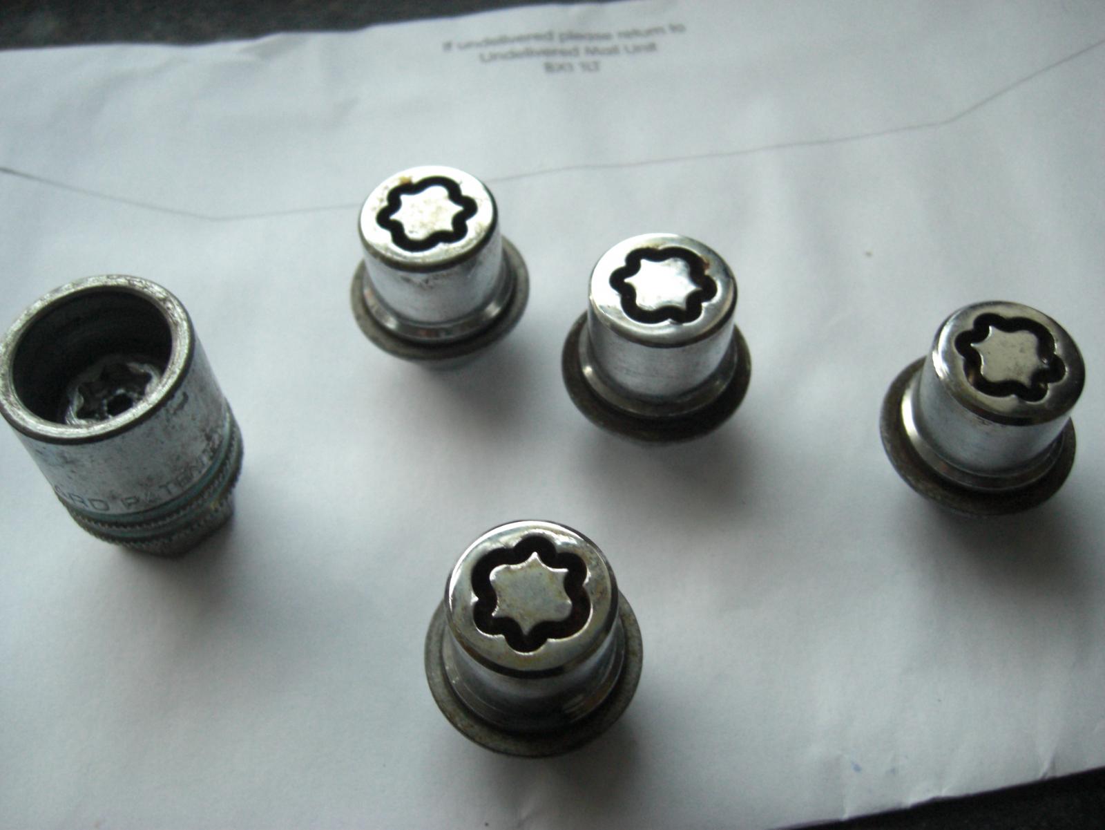

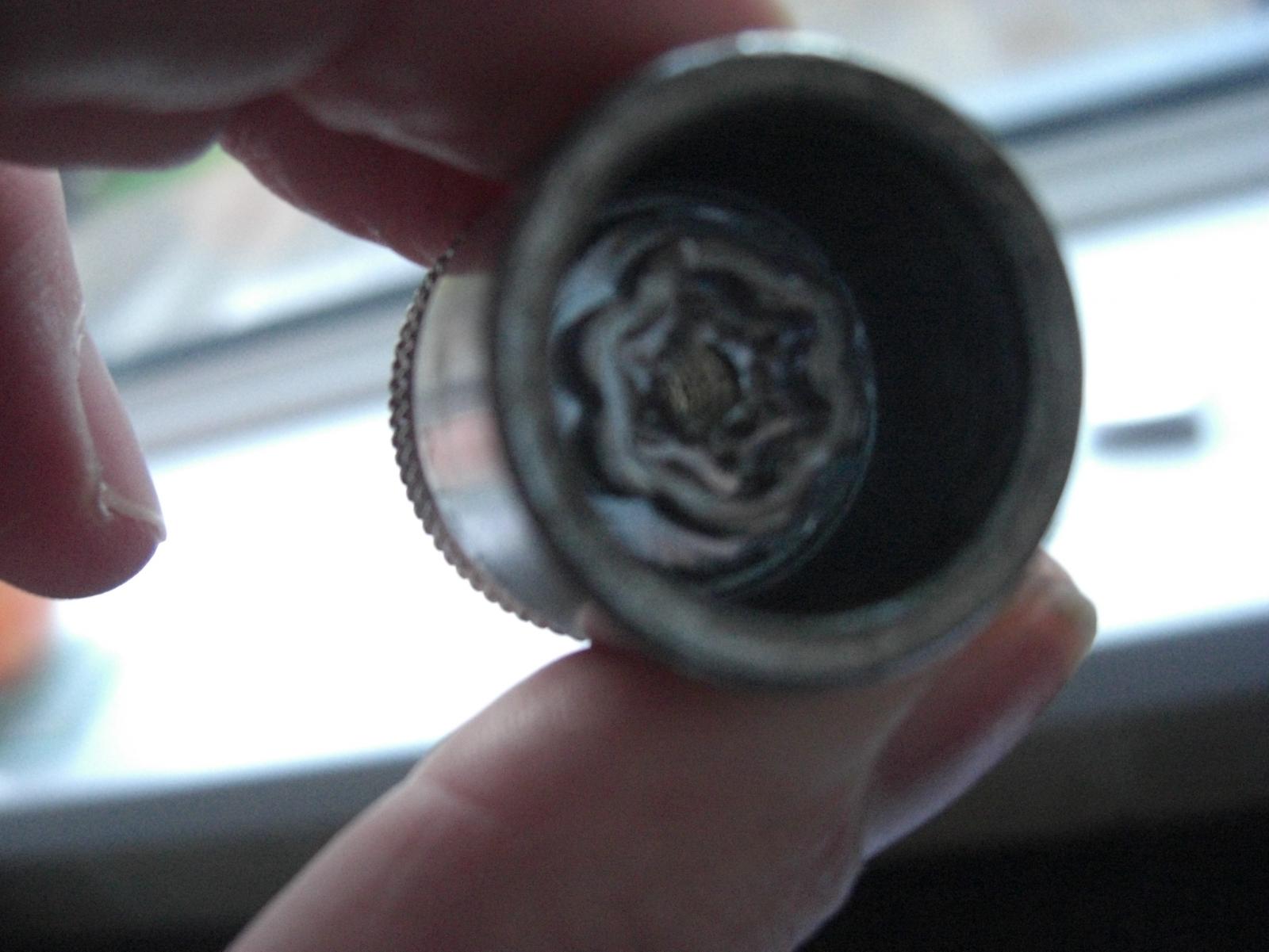

Andy these are the locking wheel nuts that came off my S-type.
A code runs around the lock key:-McGARD 4.664.000 or A66A.000.

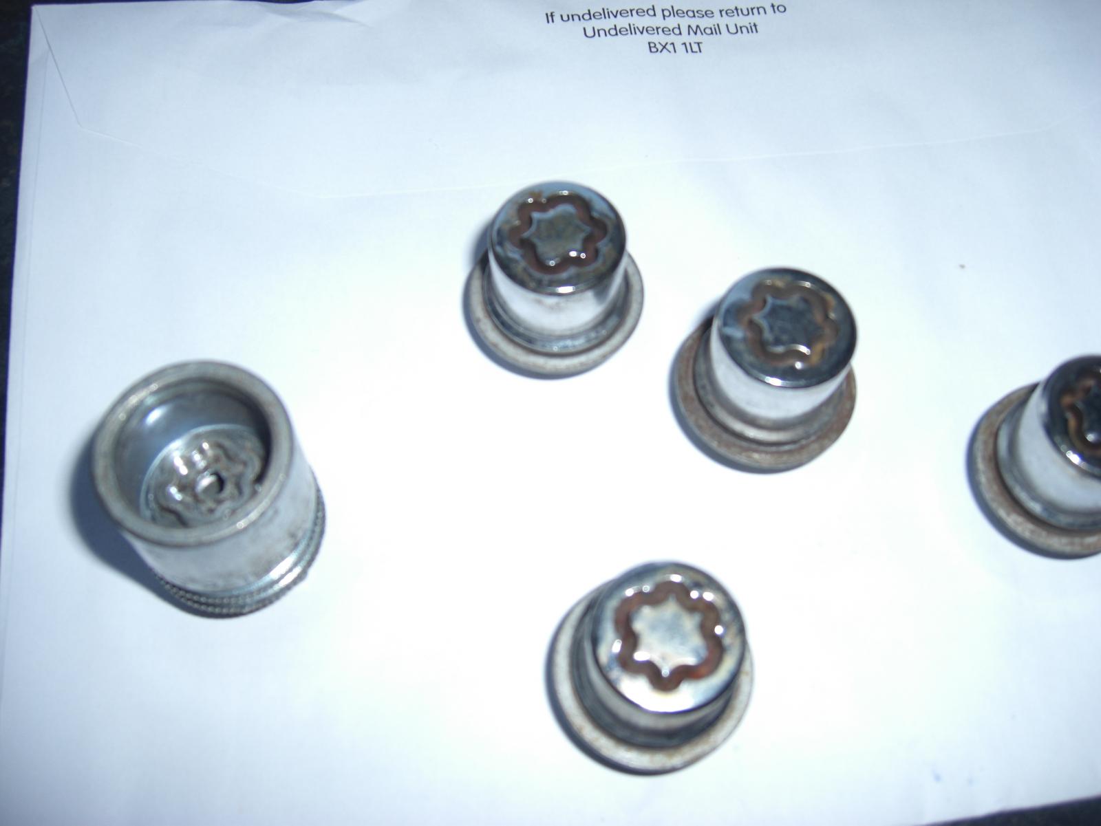

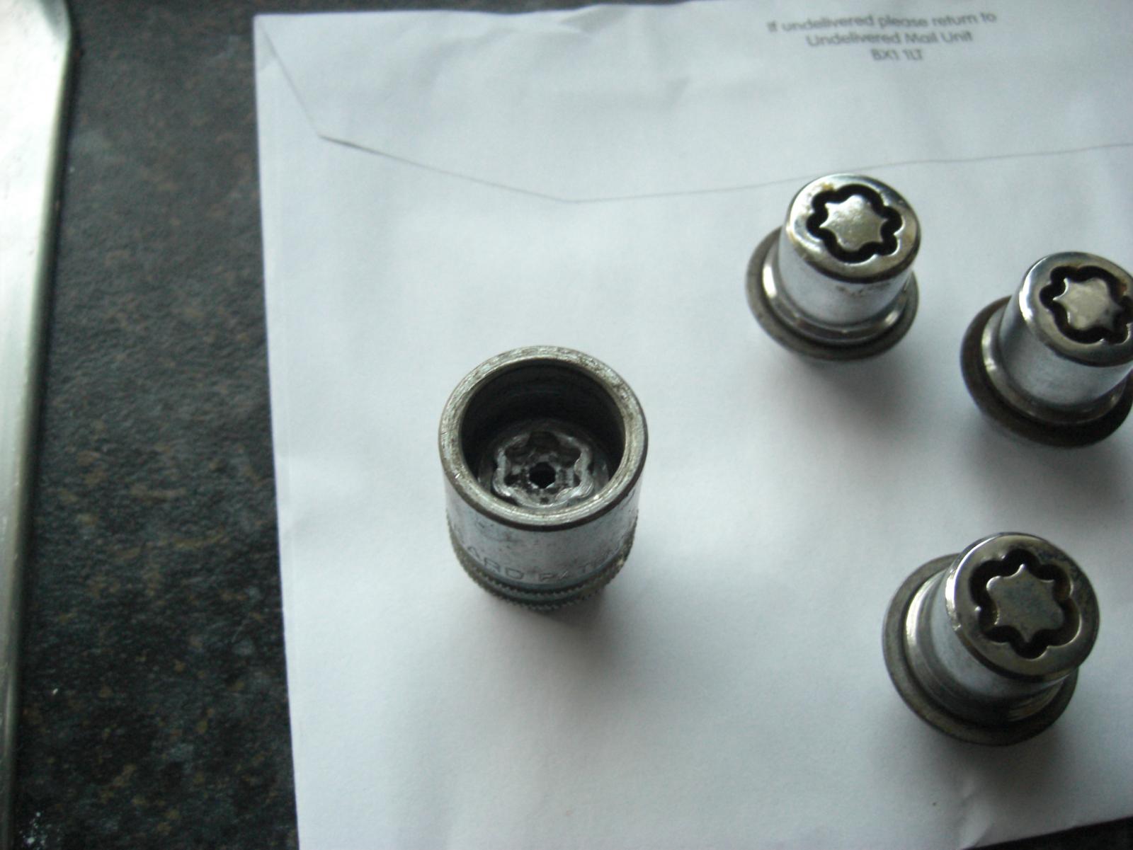

See above for the locking set that came from my Jag.

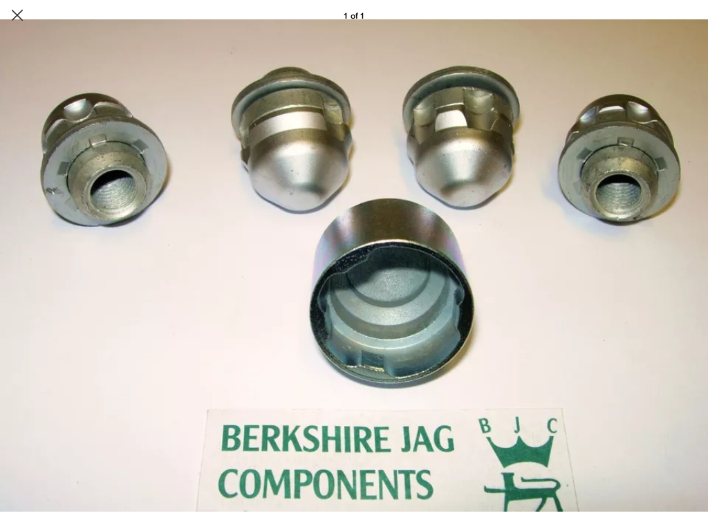

Andy, I might have a set of my old S-Type in the garage, if you want I can dig them out for you to see if they're any good?
They are, or they certainly look like, ford locking wheel nuts I think (most likely as a lot of bits on the s-type are ford). They're exactly like the ones on my ka that have a little ford brochure with them.

Those ones with the wiggly line around are 100% identical to the ones on my old Mondeo. Ford deffo used them, although they won't have been made specifically for Ford by McGuard so I bet they hawked them around every manufacturer.
They're also factory fit on Volvos....the dealers normally have a master key set to remove them. If I remember correctly, there's only around a dozen or so patterns.
Ford do use McGuard, as do several manufacturers but not JLR. I'm not counting X-Types which probably do now I think about it.
exactly the same as the ones on my Merc.
That'd be good.
