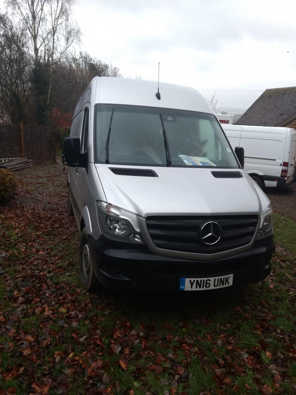

I was driving this a few days ago.
It's a bioethanol powered Sprinter. The chap who owned it (and the white one behind) deals in gas powered vans and had booked us for a removal with our van which wasn't big enough to carry everything. With lots of delicate things on board I didn't really test the available power but it was fully loaded and made it up steep hills without complaint.
