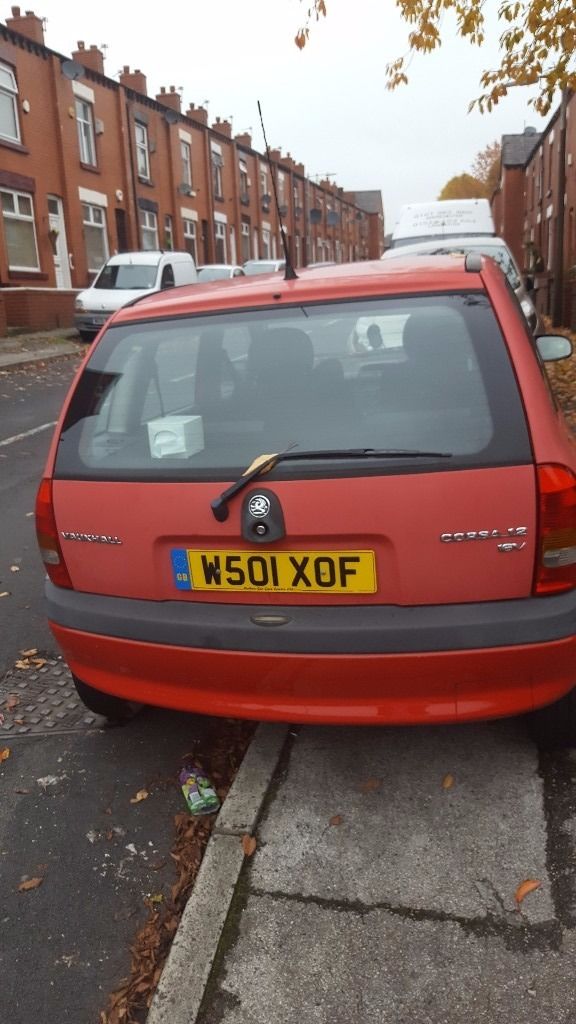

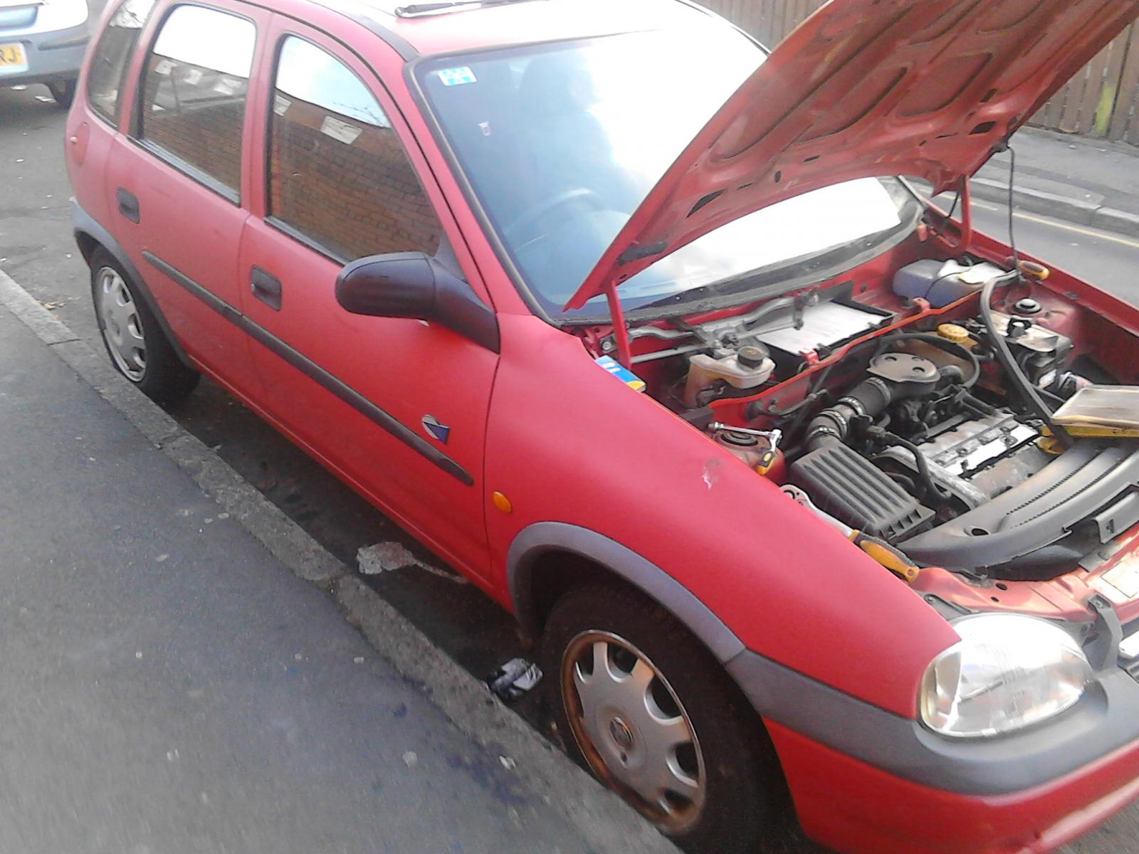

new shite incoming,typical bread and butter vauxy
very very short test,but only cost £10,,, :-D :-D ,luckily only 10 min walk away,pickup 2.45,...

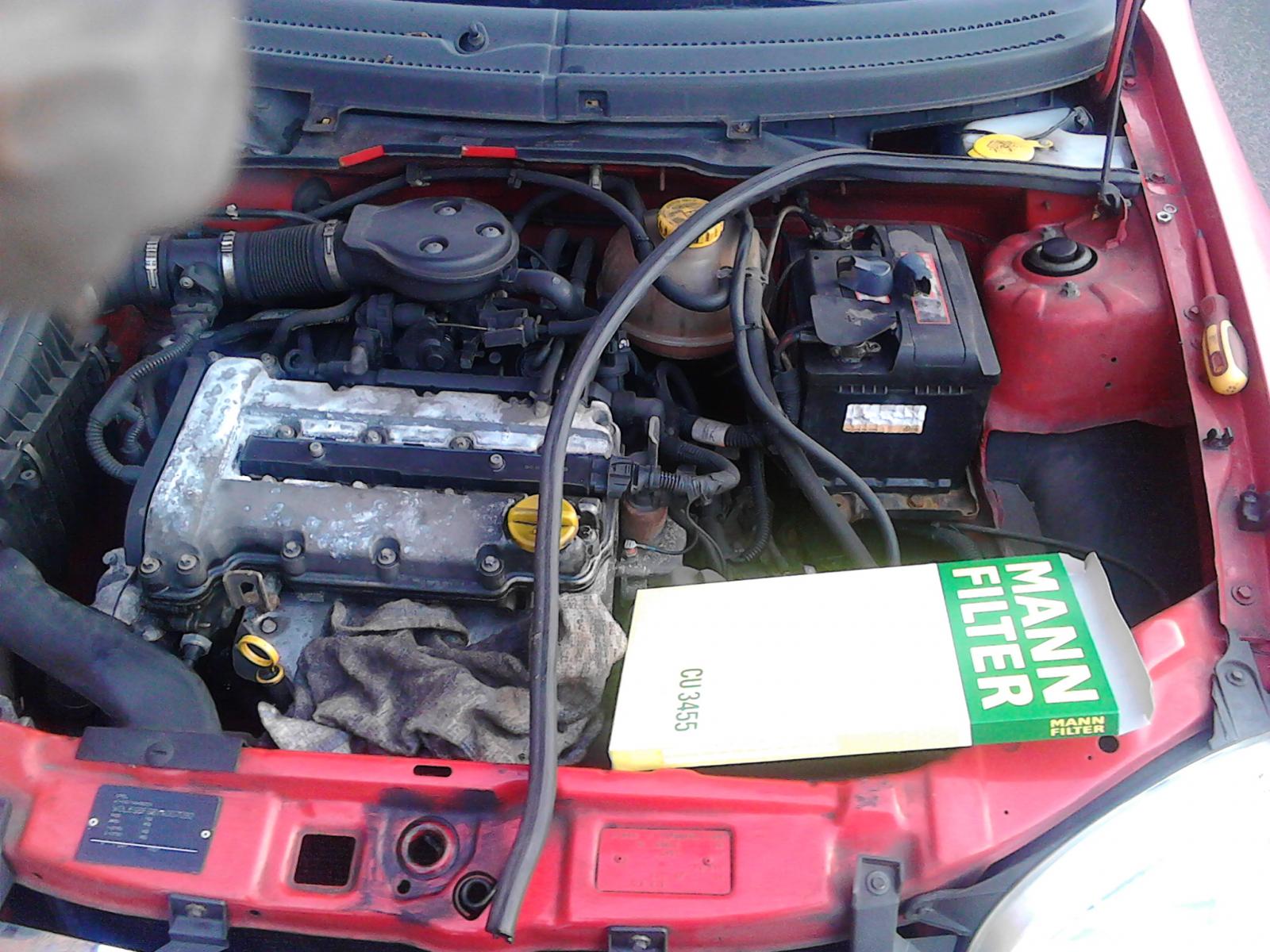

well of to get service kit from chris/or dave at euro,eml light on,no petrol of to get that as well,here is some pictures,more to follow, :-D

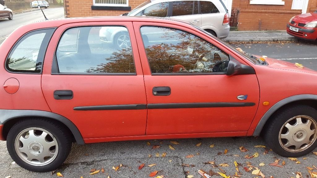

Well, those wheels must be worth a tenn.....oh wait, there are only three of them. Never mind.
theyd owned it for few years,he paid just over a grand back then,thay have upgraded to honda jazz!eml light gave it good run up the bypass,speed camera friendly,up that part,has gone of,mot due 14th or 15th dec,..seems to like ecp few bills from euro over years,for exhaust,shocks etc.will order more bits from micksgarage as  whilst special offers are on...
Ten pounds. For a whole car.

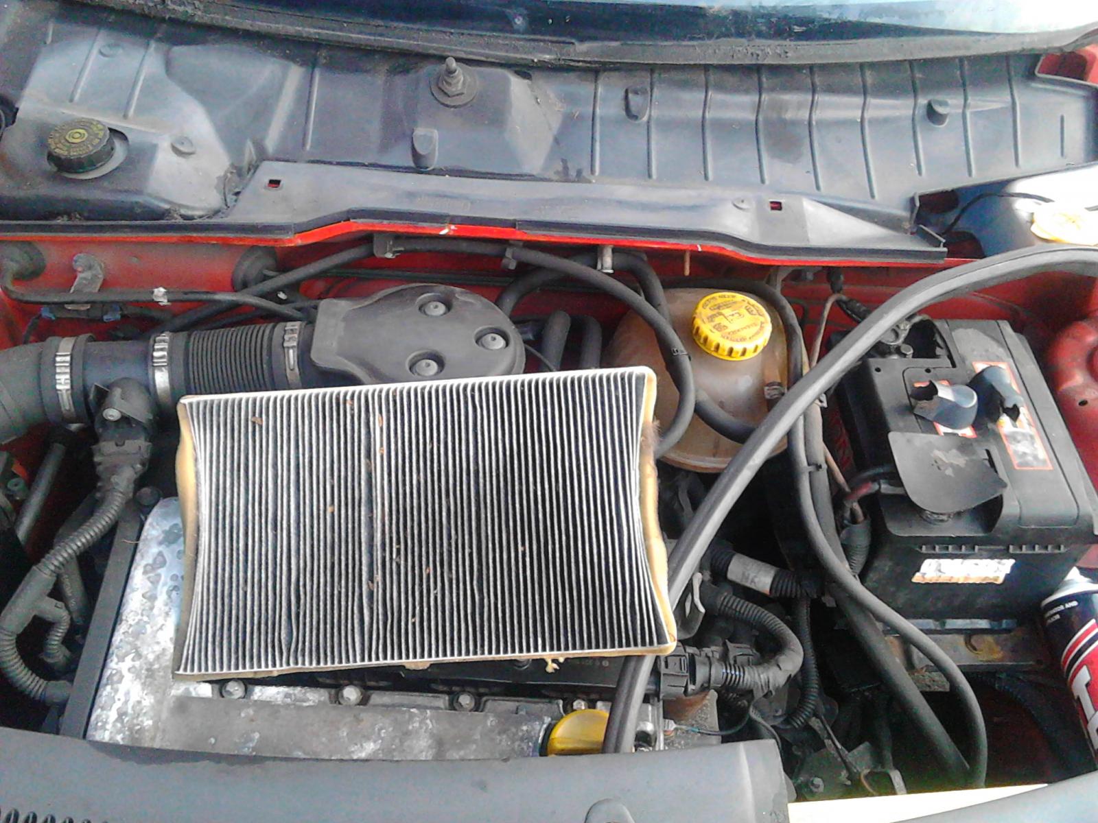

well changed the pollen filter,airfilter,eml light still comes on traced to idle air control sensor,will get one from scrapyard tomorrow,the one on it no name shite,it seems to have come from euro,few bulb changes done,ready for mot sun,have to do tyre yet,changed both front wipers,one a trico,the other bosch,the rear one is good,need plastic gubbins to hold headlights more solid
Looks like an automatic too. CASH BONUS.
yes auto too,bit of oddball has alloys,sunroof,but the good keepfit windup windows,70,000 miles,skimped on some things one shocker on front not both,..ordered headlight clips,icv valve,been over it,no welding needed..
These don't like cheap pattern ancillaries for the engine, good shout on used OEM stuff.

just been to my usual mot place ,passed no problem,good on the emissions,had to get icv valve to get the eml light  off all fine now,so driving fine :-D may tcut it yet..

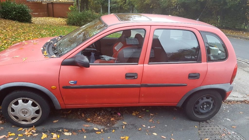

steering was pulling to left slightly,went to my cheap tracking place,was done for tenner,now driving great,radio/cd has a mind of its own,still works,changed the fuel filter ufi,previous was a fram,may t/cut,have managed to borrow some,at the tracking place,up on ramp,no rot anywhere..clips came cheap chinese crap,look for better,
