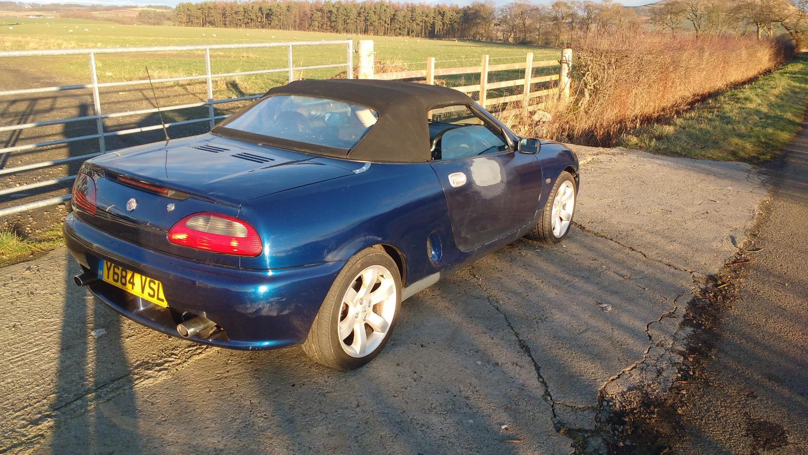

Barry Cade Posted December 2, 2016 Author Posted December 2, 2016 The more I look, the better this thing gets, had some fettling time earlier and got a few things fixed. It's quietened down a lot and the engine sounds as healthy as a VVc gets. Box and clutch are good, no overheating and no stored codes.everything electrical now works apart from the abs- some #&@£ had removed the bulb... Needs a rear sensor. It's growing on me every time I go out to it. dome, Sigmund Fraud, M'coli and 11 others 14

Barry Cade Posted January 3, 2017 Author Posted January 3, 2017 The MGF is coming along nicely, all the mechnical stuff that needed done has been done and I'm getting the bodywork better. The neighbours must think I'm mental spraying on new year's day at 2 degrees- halfords aerosol in one hand and heat gun in the other.its now taxed and insured so gave it a run and went along to my local tyre place and fitted a couple of budget 215/40/16s on the back. As they were quiet I got to play with the Hunter alignment setup so now it tracks straight and true front and rear and drives lovely. I may leave it looking a bit unloved and just use it. List so far:2 front wishbonesFront discs and pads2 track rod ends2 rear abs sensors2 rear tyres2 new wingsHeater resistorWiper linkageComplete hoodBonnet cableAlternator belt All the callipers were stuckBroke 3 front subframe boltsBroke both abs sensor boltsTemp gauge didn't workAbs didn't work richardmorris, Mr A Lawrence, Vince70 and 5 others 8

Isaac Hunt Posted January 4, 2017 Posted January 4, 2017 Coming together nice. That 'fillage' on the front wing was proper shite, must have taken ages to make such a hash of it. Oil filters rusted through, you can't beat that for a full shitevice history 'FSH' to 'FFS' Keep us updated Barry Cade 1

Barry Cade Posted January 4, 2017 Author Posted January 4, 2017 It's mems3. Seems pretty sprightly, but getting a shunting hesitation at about 2k. Still got plugs and leads to do, and run a couple of tankfuls through it. The filler was smeared over that tape you use on plasterboard..Duck tape would have been a stronger, better looking repair. Got a good jrj drivers door coming as the one on it now has a lot of filler in it and is a darker blue.I think if you want one of these, buy one now..I could live without the VVC though, my 1.8i was near enough,smoother and quieter than this one, cheaper to insure and tax as well.

Barry Cade Posted January 5, 2017 Author Posted January 5, 2017 VLU started out not too dissimilar.... This one made it home under its own steam at least.. Pillock 1
