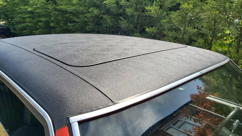

One job I've been meaning to do for a while is give the vinyl roof a proper clean and remove all the paint and polish residue.  I've also attempted to waterproof it a little with various silicon based products.  There's plenty of epoxy primer on the roof but I'm not taking any chances!

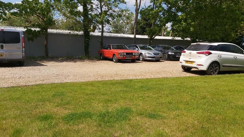

Have also booked in for FOTU.  Not too far from me and car will manage alright, should be a good trip.  Been to so many shows over the years but never had anything to show myself.  Looking forward to it.

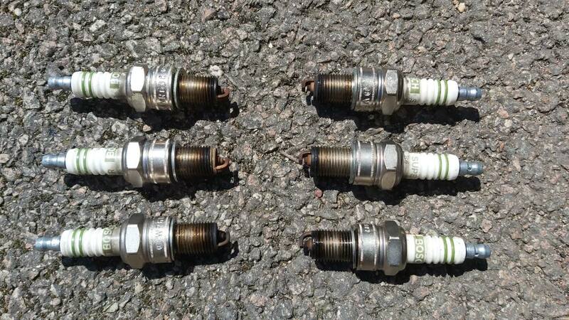

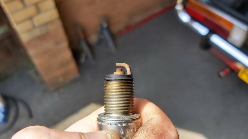

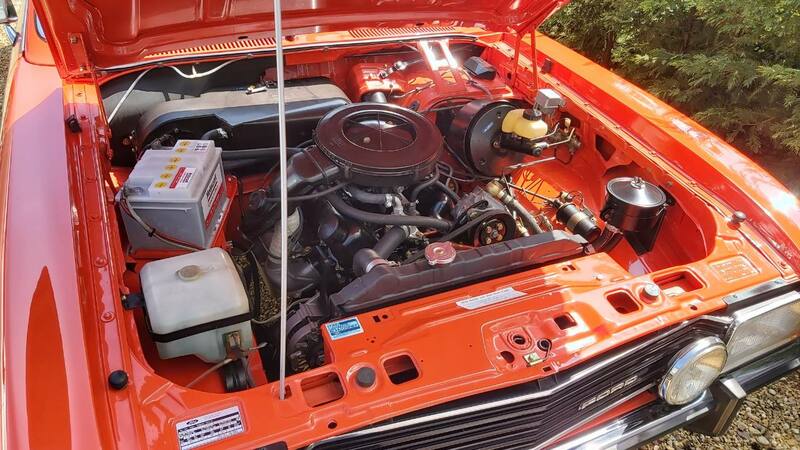

Checked over the engine and pulled the plugs.  I'm no expert when it comes to reading plugs but these certainly look happy to me.  Timing looks close too with a colour change right on the 90 degree part of the strap.
20210605_122757.thumb.jpg.2d60738957983a7f2834252ce0906f9e.jpg20210605_124654.thumb.jpg.af9381a78a6086317893734648c7f349.jpg
I also tightened the rocker covers as they were starting to weep a bit of oil.  Checked the fuel filter and changed a section of line I wasn't happy with.  Also performed various other small jobs.

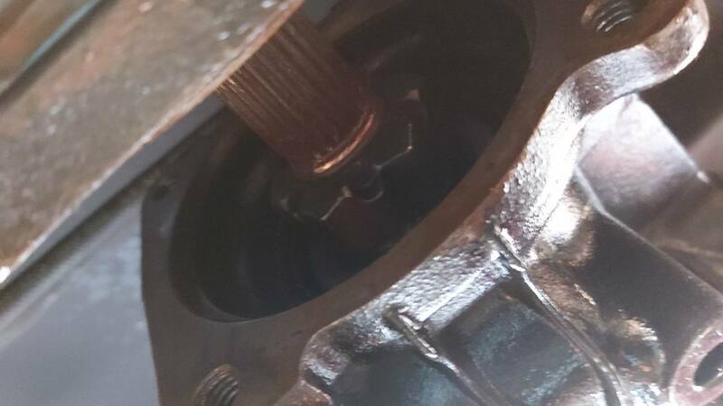

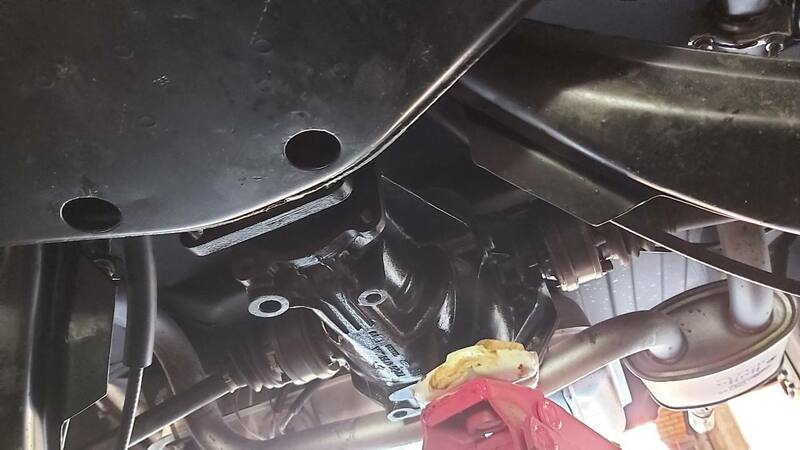

A bigger job concerned the diff.  Whilst driving in 3rd or 4th gear at anywhere from 20 to 40mph there was a noticeable whine from the diff when you let off the throttle.  I decided to sort it out as it can become quite annoying once you notice it's there.
To fix I need to tighten the pinion nut a faction more.  The will increase the preload and reduce or stop the noise.  On a Granada this is a pain to get to as you have to split the diff to reach the nut.
Drop the driveshaft, unbolt the diff from the beam, removed the large rear bushing bolt, remove the bolts attaching the extension housing to the diff and you can then tighten the pinion nut.
I marked the position and added a touch more preload.  Put everything back together and went for a test drive.  Pleased to say 90% of the noise has been eliminated, I'll keep an eye on it but I'm happy I managed that on the first go.  It's not something you want to do twice!

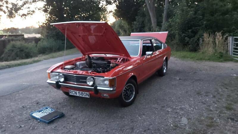

I've done about another 300 miles since the last post.  Generally using it as a car and mostly going back and forth to work.  As the weather has been getting increasingly hot I've noticed the engine temperature creeping up a little bit each time.
Was out for a jolly on a hot evening and the temp climbed over the 3/4 mark.  This resulted in some quite spectacular vapor lock which lead to me being stranded in the middle of nowhere!  I took the airbox off to have a look and the carb sounded like frying bacon.  All the fuel in the engine bay was either boiling or full of bubbles.
While the engine didn't actually overheat the fuel just couldn't handle the heat.  Modern fuel boils at lower temperatures than the old stuff.  Results are vapor lock being a much more common issue than it used to be.  Nothing I could do apart from wait hours for the car to cool.  So with it getting dark I phoned a mate and got a tow home via his trusty Rover Tomcat.  Unfortunately it was so dark I didn't take any more pictures.
I've jammed the thermostat open as a temporary measure.  Car now runs at a quarter on the gauge in 30 degree heat and seems just fine.  I've ordered a cooler stat and that should solve the problem.  One fitted was an 87 so I'll go down to an 82 and see how things go.  Apart from that I've no major issues and the car seems to be running very well.
