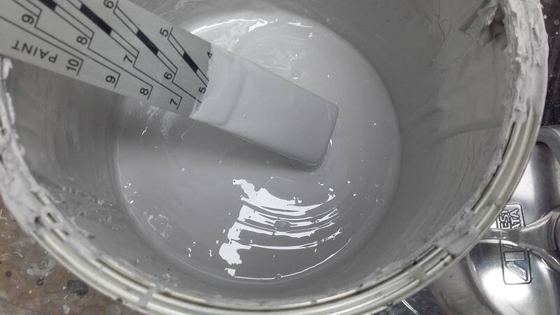

Mixed up the primer in a 4:1 ratio.  You can see just how thick this stuff is in the can.  I've had to thin it by at least 20% just to get it to spray properly.  On the plus side it's almost impossible to get it to run so even a novice like me can't mess it up.

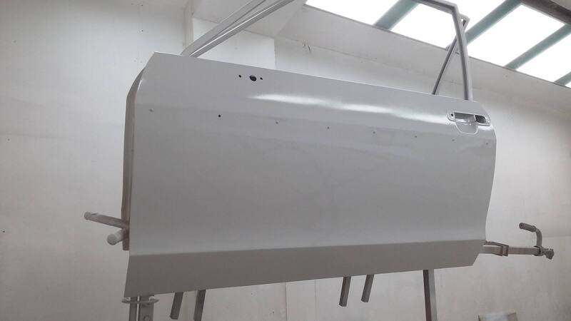

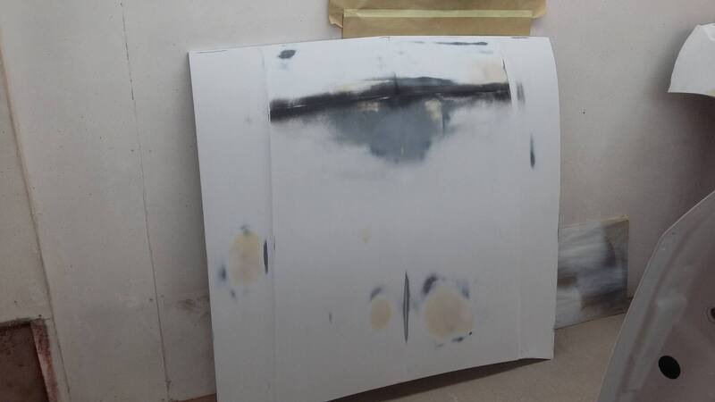

Painted everything in about 2 coats of primer paying particular attention to the bonnet and doors.
20181215_104437.thumb.jpg.a55e51708bf592af63e371f45bb2978f.jpg20181215_104447.thumb.jpg.9db47b0471009d7a43037dd1377a5603.jpg20181215_104458.thumb.jpg.691e0519c33dcd7e0a386fde7b689718.jpg20181215_104629.thumb.jpg.b895c42994c10c3f853afbabcc196457.jpg
Very pleased with the drivers door.  I had to do a lot of repairs to the bottom of that.

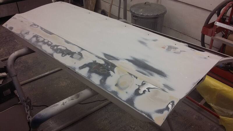

I've been spending time filling & sanding all the panels first.  Being off the car they are much easier and more convenient to work on than the shell.  I'm a novice at this so I figured doing these first would be a sensible option.  Theres a few rules and techniques to follow which I'm learning as I go. I'm using regular filler, finishing filler (sometimes called top stop) and finishing putty.
I'm following the below and taking my time.  If I don't get this right I'll be rubbing the paint down and redoing so it’s important to take time to do this properly.

So far I'm pleased that my metalwork hasn't needed very much filler to put straight.  The worst panel is the driver’s door which is hardly surprising but even so it hasn't needed as much as I thought.  It takes time and I'm finding it very boring but it's got to be done.  Including rubbing all the old paint off the car I've spent 45 hours on the paint process so far.  I'm really looking forward to getting past paint and onto the rebuild!

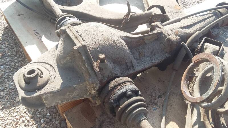

The brakes need a complete overhaul.  Rust is everywhere to the point that the friction material on all four shoes has fallen off.
20190420_114448.thumb.jpg.347ba295f190ccf798c9238f5917abfb.jpg20190420_121322.thumb.jpg.debc48b88b6f802aaf17ac900f5e66b1.jpg
I remove the differential as a unit and will look at it later.  These are tough units and this one has only done about 50k.  Amazing that such a massive heavily built diff was coupled to just over 100hp.  You won’t find that in cars of today.
The rear end is now broken down.  I just need to get the bushes out and pull the wheel bearings.

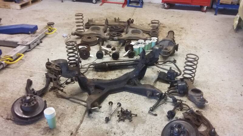

The front sub frame takes longer to strip.  Took plenty of reference pics and salvaged the brake lines so I can copy the shape when making new ones.
20190420_135743.thumb.jpg.e767fbcea88db82832fb74bde4c74d40.jpg20190420_140338.thumb.jpg.de0c2300a4502f7ed75f6739d16d1a22.jpg
20190420_140343.thumb.jpg.d07e8e6a2acad516227a9b1c1a4bcdd8.jpg20190420_143318.thumb.jpg.0e7bc63cc02f0c43895f11208003a223.jpg
The springs come out with a bit of a struggle, with the right tools its much easier but you still have to be careful.  Obviously an impact gun is essential for taking these sub frames apart.  You'll be there forever and end up hurting yourself with spanners and ratchets.
Still more do but the bulk of it is now stripped and much easier to work on.  I've got to get this all cleaned up and painted, replace all the knackered parts and check the diff over. Its nice to be working on something different.  The engine is waiting for me in the corner and I look forward to putting that back together.

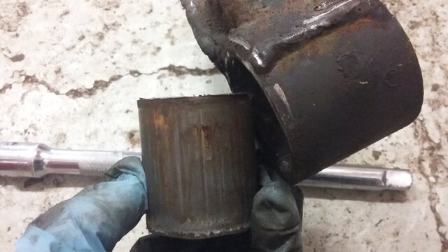

There are two metalastic bushes on the car that are quite hard to remove.  They only come out one way and that way is impossible so you have to grind off the top hat and then it will push out the other way via the press.  Even so they fought me for every mm.

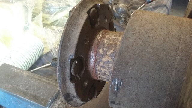

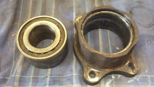

With that done I set to breaking down the front and rear hubs.  Everything here is very rusty and many parts were stuck on.  I had to use the press to get rear back plates off after removing the bolts.  I'll be replacing as much as I can mechanically.  The rear wheel bearings were probably fine when parked but that was 25 years ago.  The seals are missing or perished and plenty of rust flakes were visible in the bearing grease.
20190427_140255.thumb.jpg.4872b13df19c61d710be0da3f550af3a.jpg20190427_142822.thumb.jpg.a2573171c2f5e12dd06c88ea2b1e9105.jpg
The front hubs are also in a poor state.  The brake disk is part of the assembly and should separate with a tap from a screwdriver (after removing the bolts and hub nut).  These ones were so rusted I had to just beat the crap out of them with a hammer until they finally came off.

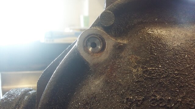

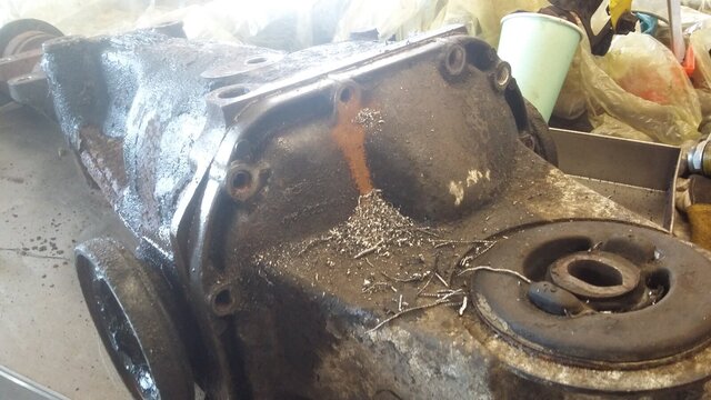

Today I finished stripping down the remaining small parts left on the sub frames.  All of that is now ready for sand blasting and powder coat.  As tempting as it is to start on things like the engine I stuck to the plan and put the diff on the bench for a look.  Its very rusty and I expected to have a few problems with it.

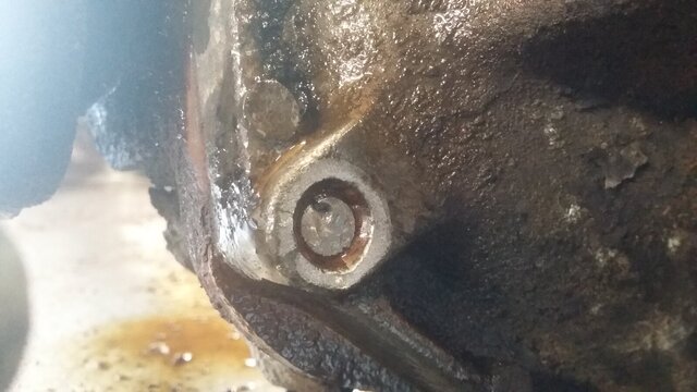

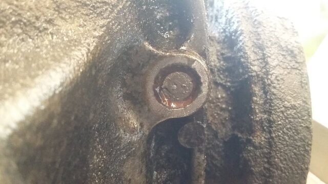

There is no drain plug on these and obviously I need to change the oil at the very least.  The car only did about 50k before coming off the road in the 90s so I expect the oil has never been changed.  I need to remove the bolts holding the aluminium cover on which will allow the oil to drain.  I can then take a look inside and make sure everything is rust free.  I've seen these get very bad internally if moisture has got in there.  One customers diff we had was so pitted inside we had to junk it and use a different one.
Taking the cover off proved very troublesome.  Galvanic corrosion has ruined the bolts and six off them sheared right off.  The corrosion is so bad that the cover remained stuck fast to the remains of the bolts.  I can't get violent with the cover as it will likely break so the only option is to drill out the bolts and gently try to tease the cover away.
20190511_123550.thumb.jpg.b268dd0b6dcf88e47e871c0a8fbfe1c3.jpg20190511_125614.thumb.jpg.d9d5fbf2060525c28d2c38c9bcf9c5b1.jpg20190511_125622.thumb.jpg.ce791fddce14339f612b275fb2050007.jpg20190511_125630.thumb.jpg.462510112356b20331452dd6c3caf868.jpg
Its not something I enjoy doing.  Some decent drill bits, steady hand and eventually I drilled out the worst of the bolts.  I drilled a 3mm pilot first and followed with an 8mm bit to finish.  I find I have more opportunity to get the hole in the right place if I pilot drill it first.  You only get one shot at these sort of jobs.
20190511_130405.thumb.jpg.4bcc074507784ae864155544918bc7bc.jpg20190511_131250.thumb.jpg.b3057329c0ae00d2db6ac00d5dc33985.jpg
20190511_132416.thumb.jpg.5613cf7eb46b6e867e6b44050481d622.jpg20190511_152149.thumb.jpg.6a3df66b3e0223832f30a55ba7c77a7a.jpg
After a few hours I managed to get inside the diff.  Was pleased to see that it was still full of oil which has preserved the internals.  I'm not looking for signs of wear as these are very heavily built units.  I was worried about corrosion from the years of sitting but the oil has done its job well.  I now have a new problem.  I don't really need to take this thing apart now I've seen the condition but those bolts need drilling out.  Crap and swarf will fall into the case and potentially damage things in the future.

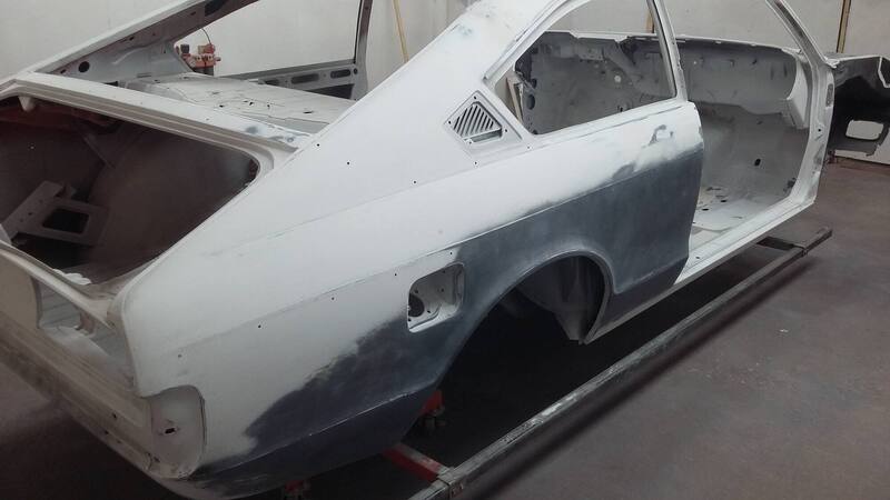

Progress on the car has been steady.  A great deal of work has been put into the shell and panels by the painters and myself.  Without their help I would have struggled and been much further behind.  Applying and sanding filler correctly is actually quite difficult and I've learn't a lot over the past few months.  Currently have another Mk1 for company, you can see the differences between LHD & RHD below.
 Most of the help was focused on the quarter panels.  While these were being done I worked on various easy areas around the shell that needed smoothing out.
20190608_150612.thumb.jpg.367cebfef505396a40d2aa8bb52b9e25.jpg20190608_150626.thumb.jpg.6d3284f10fc98b6203abc32d74d6d528.jpg
20190608_150639.thumb.jpg.e634551939df0a98caae31fd76cc2e77.jpg20190608_150708.thumb.jpg.ead0682b75d8ddda1824825a8eec2d55.jpg
Then after we had completed the work I re-primed the shell and was very happy with the results.  A few tiny areas needed finishing off so I put the shell aside to do those bits later.  Next were the panels which I also got some much needed help with.  I put a few days work into these and past them over to the painters for a good going over.  Once happy I re-primed these and will give them a final check before painting at a later date.

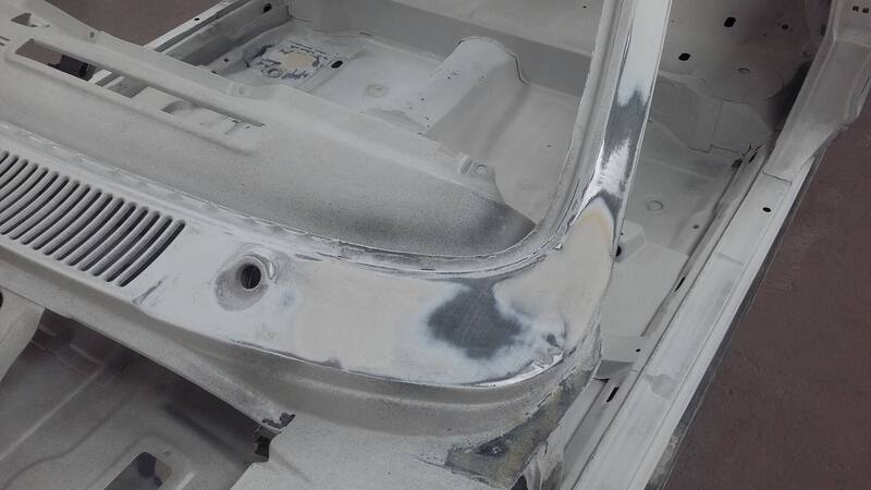

Here you can see how much work has gone into the various panels.  Many were dented and beaten up from years of storage.  You can see there are many skims of filler in a number of places to finish them off.  All this takes hours of feeling, filling and sanding.  None of these panels have filler trowelled on, most has been sanded off leaving thin skims which can be seen below.  Any serious dents or damage were beaten out when I did the metalwork on the car.
20190615_112756.thumb.jpg.8a0bdb6bffc72467347b75cd6ce2d9d4.jpg20190615_112804.thumb.jpg.f567e38f547cd73c2be9cdd84f9dc7b0.jpg
20190615_112817.thumb.jpg.31d2076968fe95f047caadb5cb442a71.jpg20190615_114539.thumb.jpg.cbf40db38245ebfa7097f0a982dc0897.jpg
I went over them again this morning and put another few hours of filling and sanding into each panel before getting everything ready in the booth for primer.
20190615_115830(0).thumb.jpg.0fbd31f76bb7e5eca2084f730a456c42.jpg20190615_132653.thumb.jpg.b3f4453ae4e37ebdf94282c94afac6e2.jpg
First impressions look good but I wont know for sure until I have time to go through them again.
