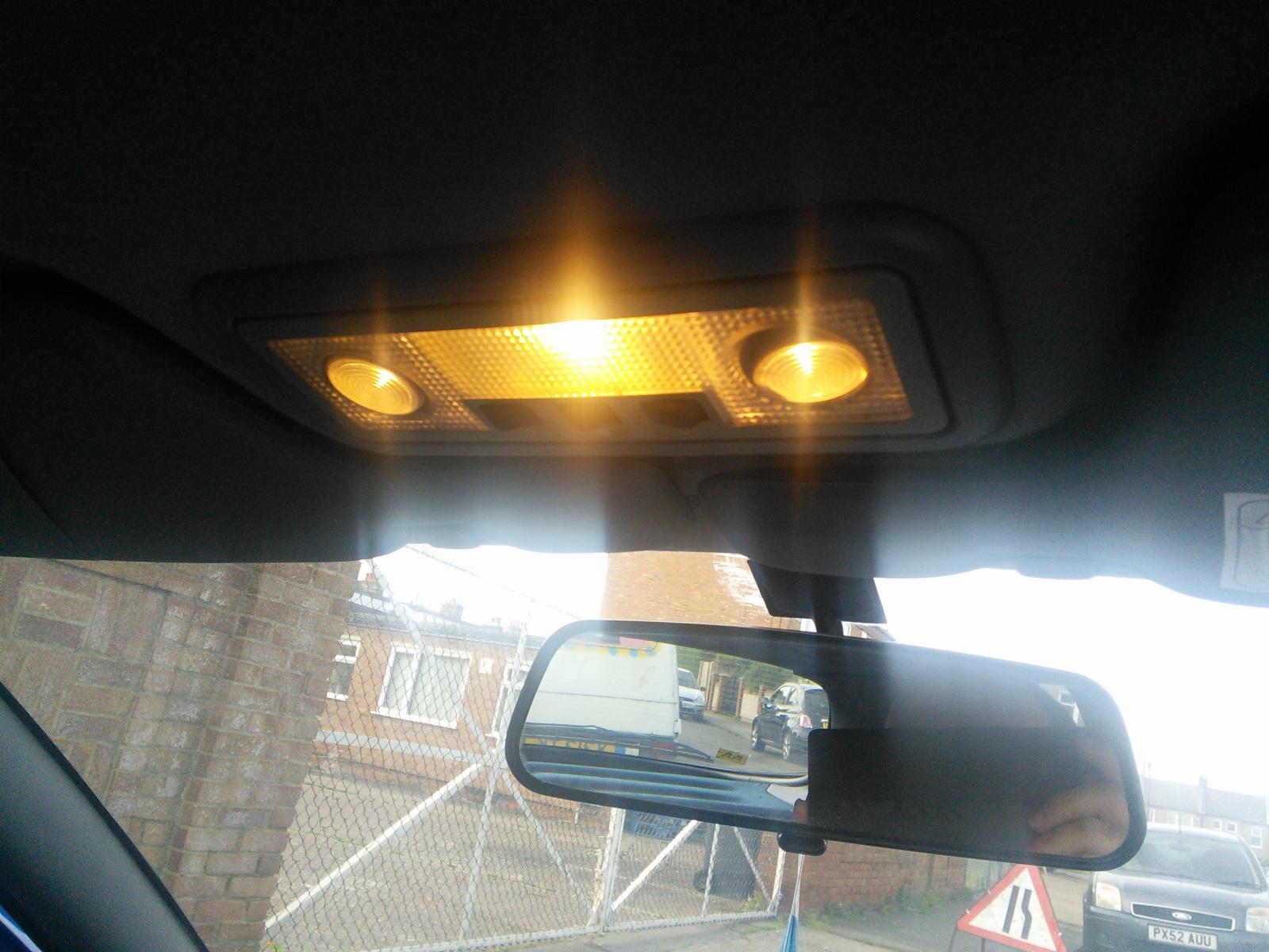

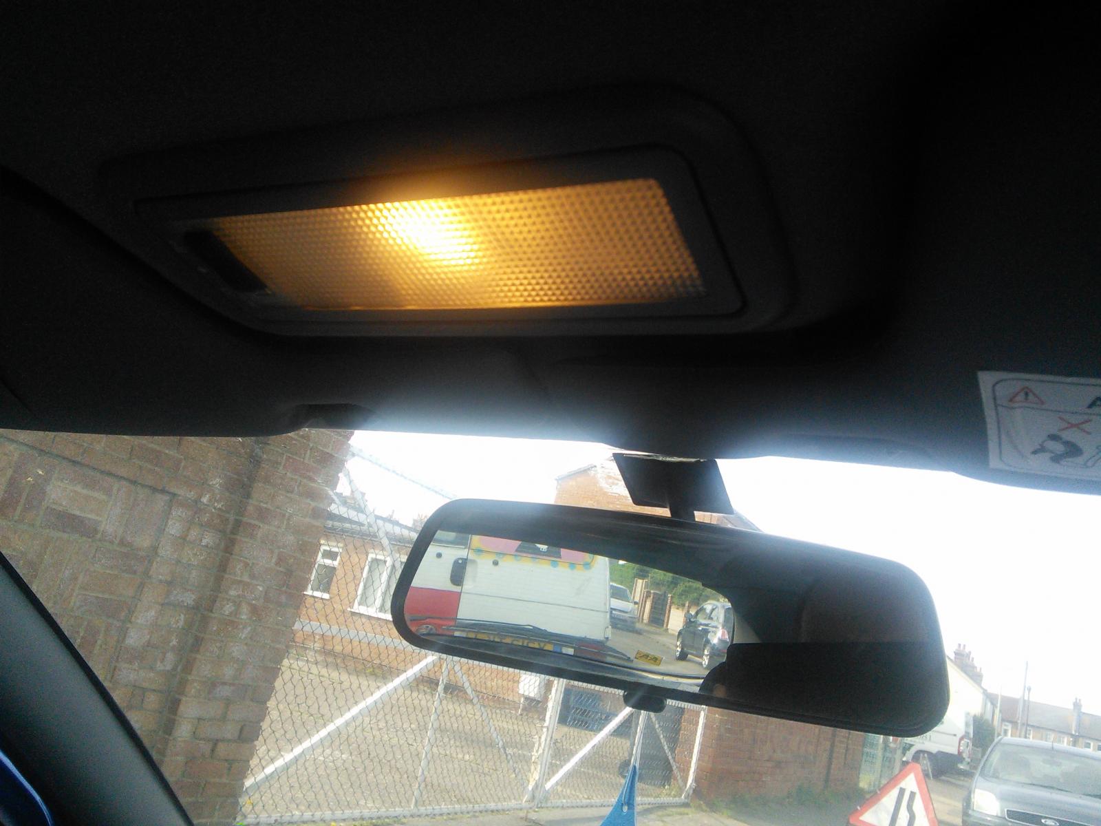

I always upgrade interiors from a better equipped model. It's more fun that actually buying the better model to start with. I've also added things like cd holders, cup holders etc.
Absolutely nothing to do with performance though.....
The Volvo has got a complete black interior to replace the tired beige one it came with,including leather gearknob & cupholder upgrades.I also changed the single disc cd player for the 3 disc version,& added a multichanger in the boot as the cables are already there.There's a chunkier steering wheel from a later model too.
