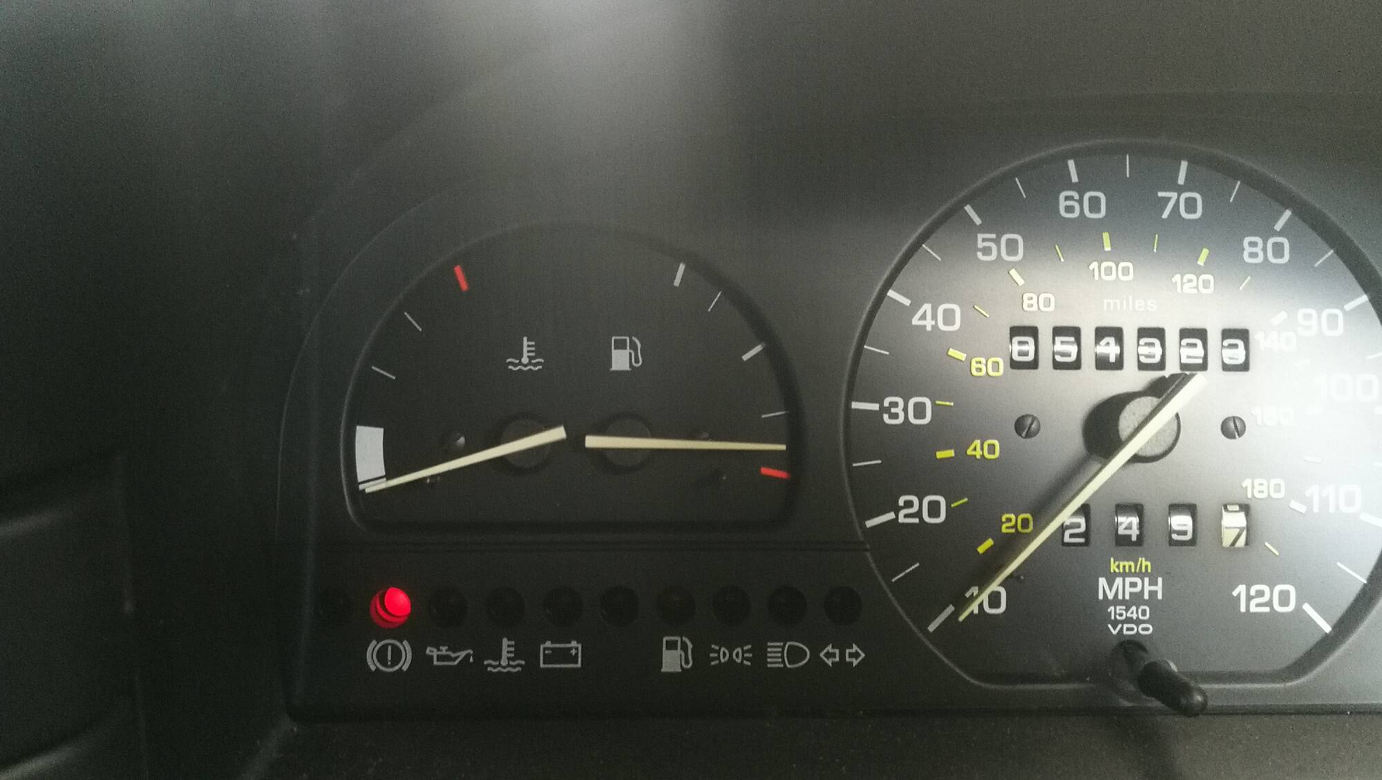

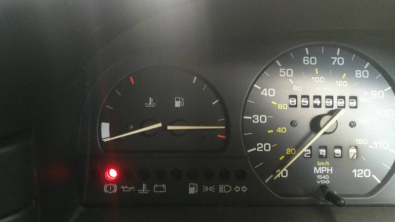

I drove for home, and about 5 miles away, I noted the brake warning light glowing - not fully lit. A gentle saunter home.
Handbrake onIMG_20200719_190000.thumb.jpg.5f40eee52894874c252cad56dd9b073f.jpg
Handbrake off
The brakes feel fine. I have parked it outside the house on tarmac so I can see if there are any leaks.

First up, the glowing brake light was resolved.IMG_20200724_134704.thumb.jpg.e5577d9942f80c3ead09f4be2f7dd858.jpg
To sort it, I pulled off the connector and cleaned both sides using a cotton bud. Reconnection and firing it up showed the light went out.
Result.

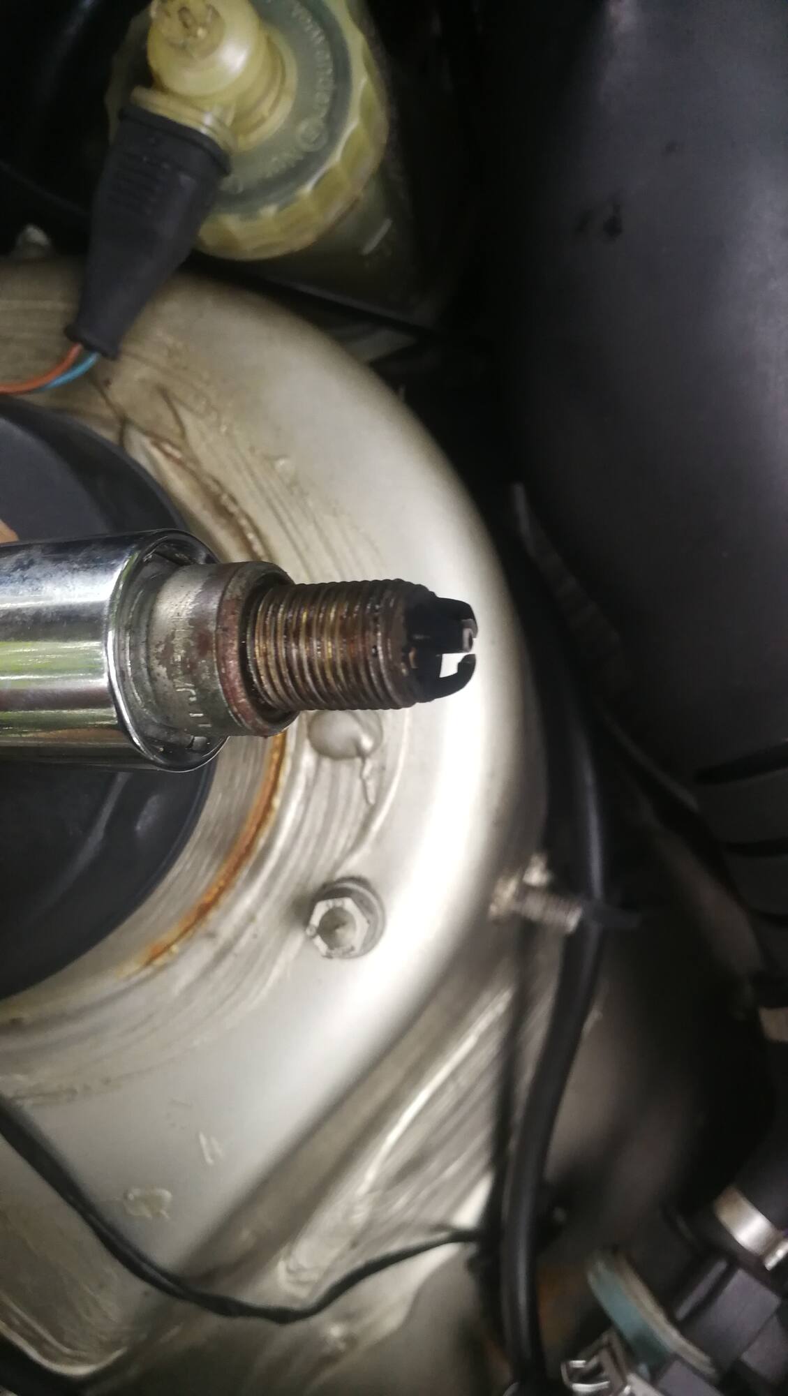

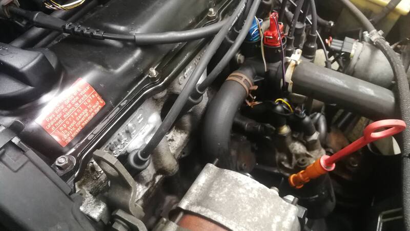

Next up was sorting the grumpy performance. Despite the new gasket on the inlet to injection unit, it still suffered from a delay and some rough running.
My suspicions were all located in this picture:
Firstly, I was sure the sparkplugs would be sooted up due to the rich running caused by the fuggernatit gasket.
Suspicion confirmed.
All four were removed and cleaned.

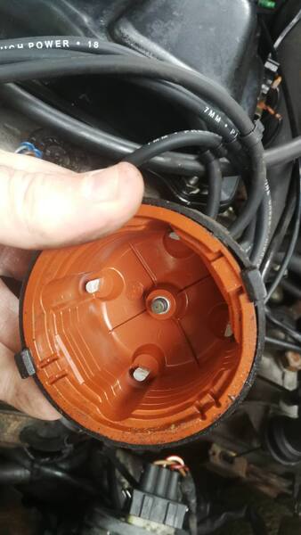

Next up, the Dizzy cap and rotor arm
IMG_20200724_135816.thumb.jpg.cd4c780bd096810a99fe43d44845c517.jpgIMG_20200724_135810.thumb.jpg.778b16e7f1c2879c1d14d24b4aadca4b.jpg
Aye, that needed a wee skate with some Emery paper.
All back together and a test drive proved that improvement has been achieved!

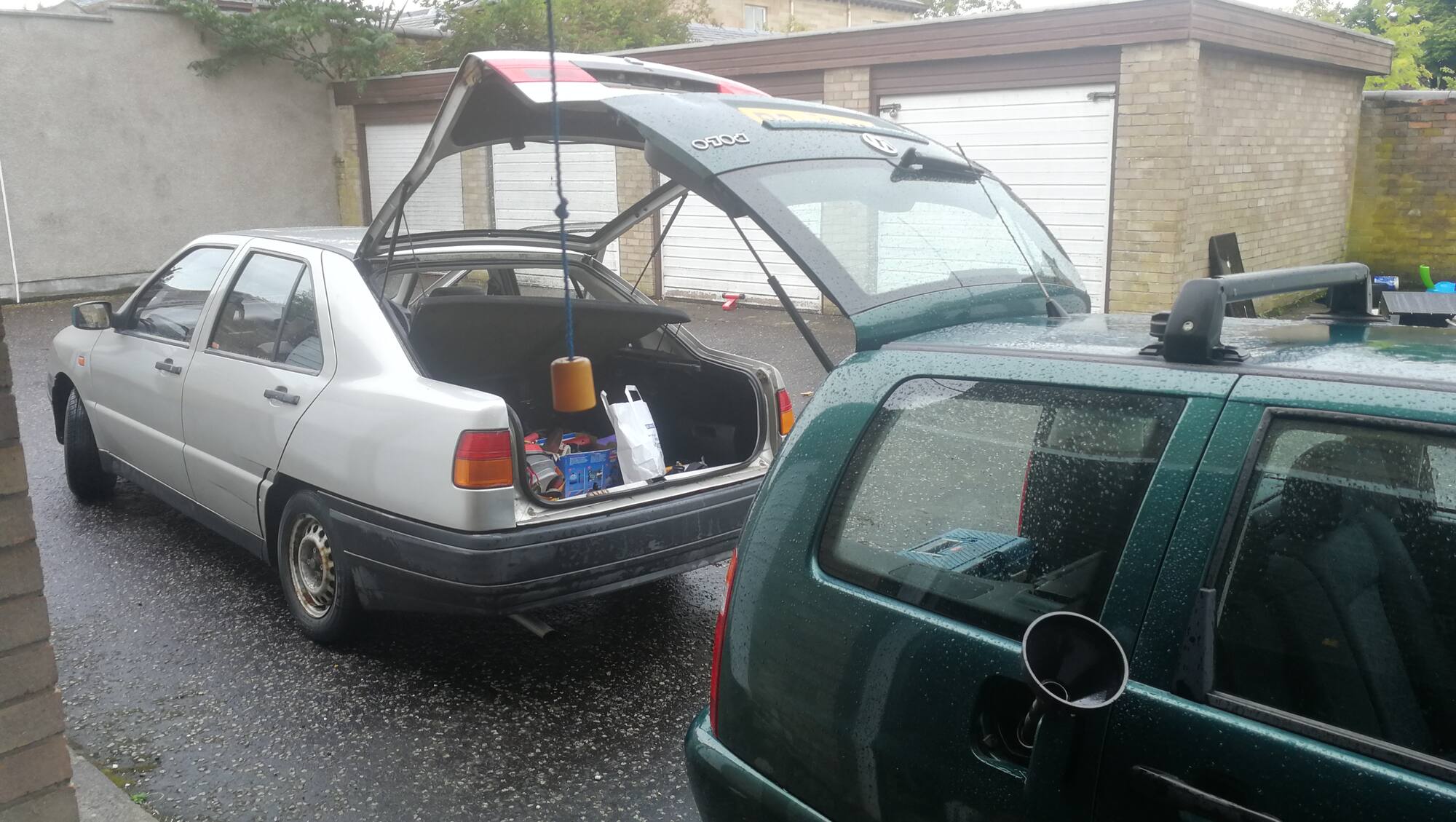

Not much done on this today - it was the service wagon for taking me to tinker with the Oxford - update to follow.

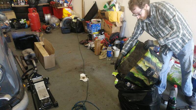

One thing I did do was get the boot tidied - it's been a midden ever since I had to clear the ML boot into it.
This was part way through emptying it. The boot holds a lot of stuff, some would say too much.. my personal record with the original one I had as my first car was 1 tonne of bricks in the boot.
Here we see @captain_70s mid shuftery bopping as we sorted out the myriad bags and boxes that littered the boot.
I then took the opporchancity to deploy the hoover - leading to a clean boot space.
This was promptly polluted with shite that needed taking on a tip run.
When we got back and had finished our repast, the boot toolery was rationalised and loaded.
After this shot, the shiny new jack was loaded in too. The boot on this is tremendous:)
Slowly getting there!

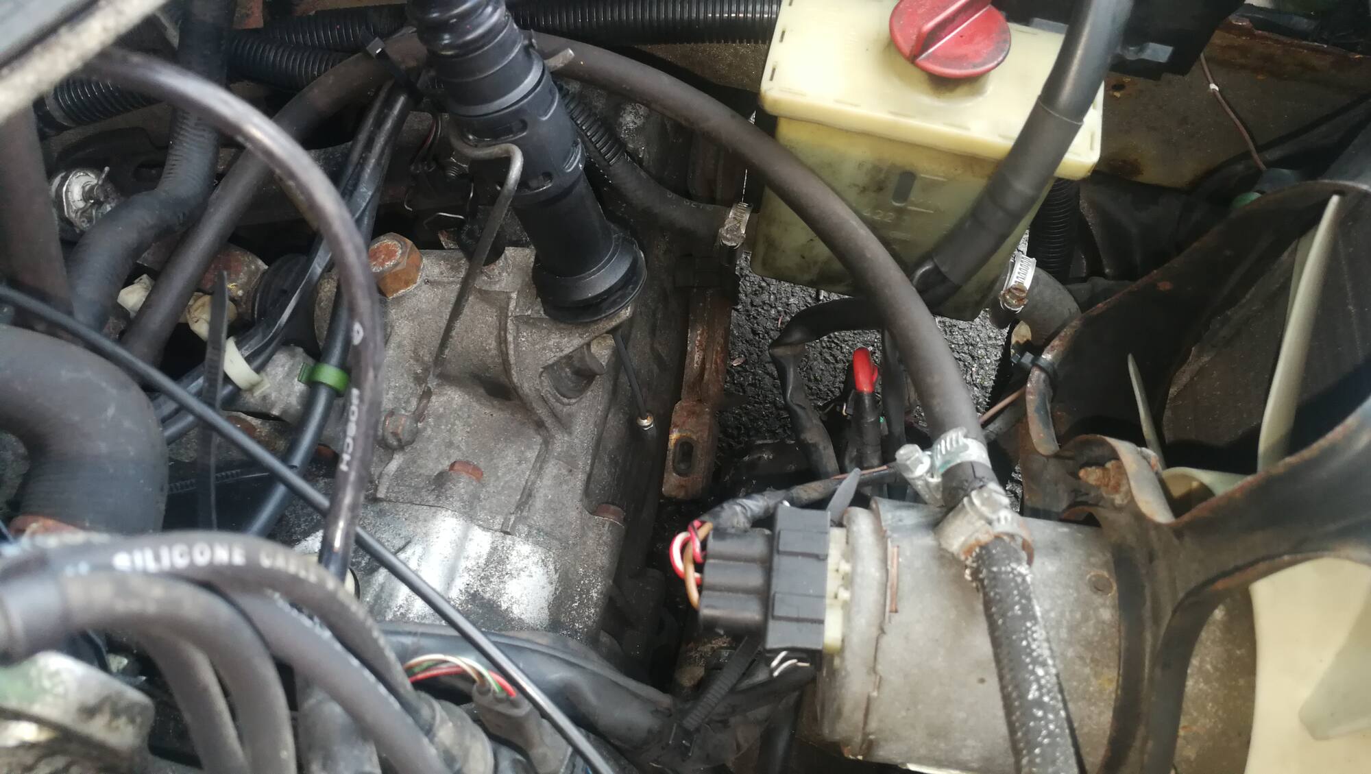

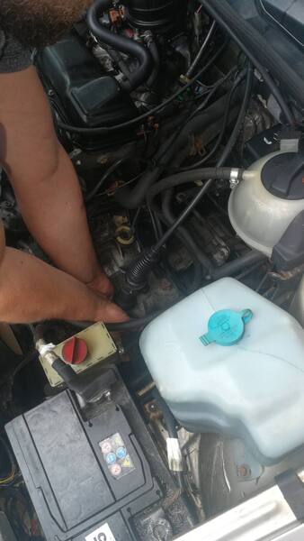

When the Clutch was first done, the clutch pedal was lovely and crisp.
This then slowly degraded into a floppy pedal with no feel. However the clutch still worked well, and the gearchange was good.
It seemed that the "Self-adjusting" clutch cable just wasn't. @Mk2 Craig wasn't pleased with that. To his considerable credit, he decided that it would be best to switch to a manually adjustable cable.
This was collected on Wednesday, and he came over to fit it.

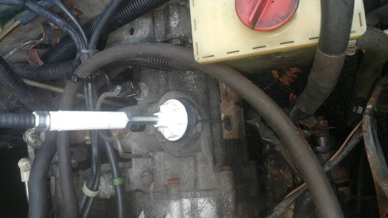

First up, the "self-adjuster" was removed from the gearbox end. The cable is only held in place by a clip that slides into the end of the cable
You can see the release arm has dropped and the end of the cable is the silver bit just above the release arm
The other end of the cable was removed from the hook at the top of the pedal, and then it was pulled through the bulkhead.
The clutch cable is the top cable with the shiny metal on it. It passes through the bulkhead above the pedal, and then through a grommet and hole in the scuttle panel
Whilst doing this, we discovered that the ECU was loose, so it was reseated
The new cable was made ready
Thankfully it slipped in easily (ooh err) and was clipped onto the pedal.
Lastly, it was fitted to the gearbox end, adjusted and locked off.
Biting point is where it should be, and the pedal feels lovely!

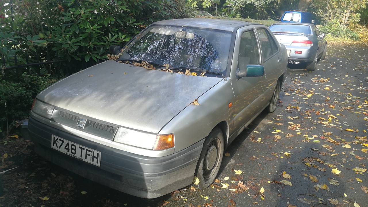

Resurrected this today. Been sitting under a tree since early August. Battery has been connected all the time.
Straight to running first turn of the key😀
Luckily it was waxed before being parked up..

This has been sitting a while, but what with the dismal Saab MOT failure, and an alarming lack of available alternative conveyances, it was time for it to step  once more unto the breach!
Time sitting had not been kind to it, as you can see here:
She was damp as a damp thing, and the paint was honking...

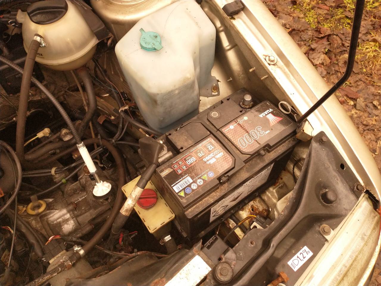

Before starting her up, it was time to treat it to a new battery.
Out with the old 075..
And in with the "whitever the fuck" from the Saab. It's a big bastards, and is hard up against the power steering reservoir.
Luckily, it's the right depth so fits in the appropriate clamp locations, and the terminals line up.

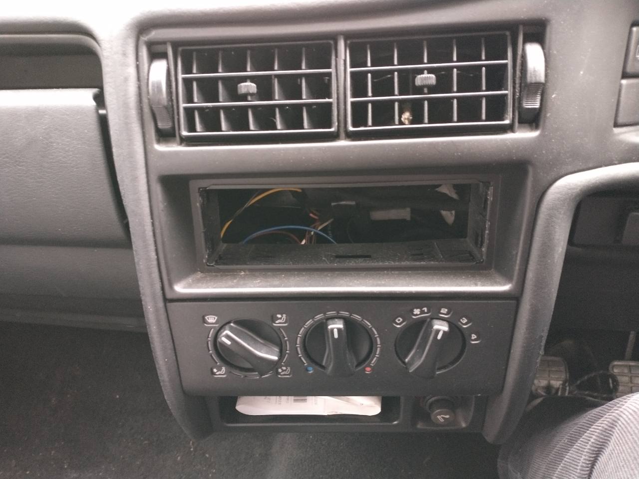

In the interim, a technical fix was attempted.
Firstly, assemble the parts:
Identify where the solution is to be deployed
Extract appropriate attachments
Test fit to the solution
Deploy to live
Obviously, it doesn't work. For the moment.
However it looks ace! I bought it off a shiter (think it was @ProgRocker ?)- thanks to them!
