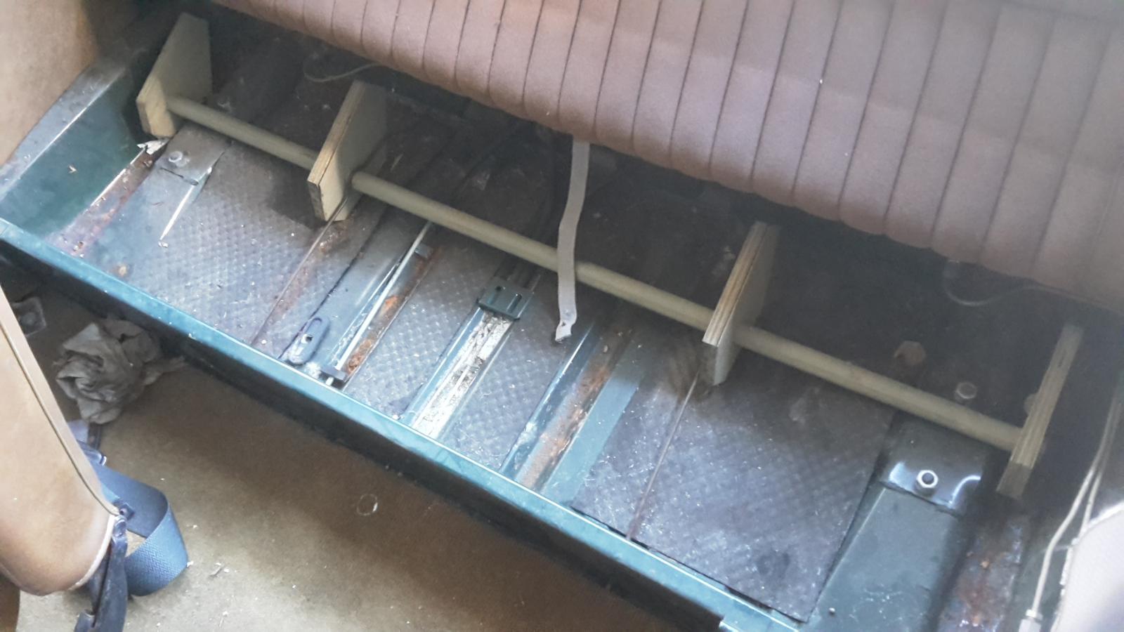

Did a bit more investigation work on the 96 this weekend. The fuel tank has been disconnected, I removed the rear seats too. The tank appears in remarkably good condition, nevertheless I think I'm going to seal the outside and probably the inside too, don't want to have to pull it again, at least for a while.
Saabs of any variety are an unknown to me, the whole of the bottom of the car is virtually flat, I imagine this was to improve aerodynamics and protect the running gear, engine and fuel system on Sweden's gravel roads; the 96 design is little different to the original Saab car of 1946, back then Sweden had very much less tarmac I guess.
The panel underneath the fuel tank is a rot spot on these Saabs so I was pleased to find it virtually rust free. Because the tank sits on the panel with only a small hole for draining the tank straps are short and very flimsy.
The join between rear offside wing and inner wing is not quite so great...
These Saabs are almost like homemades or kitcars, with their bolt on wings and simple furnishings, after all Saab was a tiny company, about 1/10 the size of Volvo cars.
The rear seat sits on a freaky dowel/plywood arrangement that I'm yet to understand. The back of the rear seat, which tilts forward had these brackets, not yet sure what they're for neither...

That plywood and broomstick arrangement is even more half-baked than the rear seat mountings of the XJ-S, which were thrown together by Valerie Singleton on Blue Peter.
