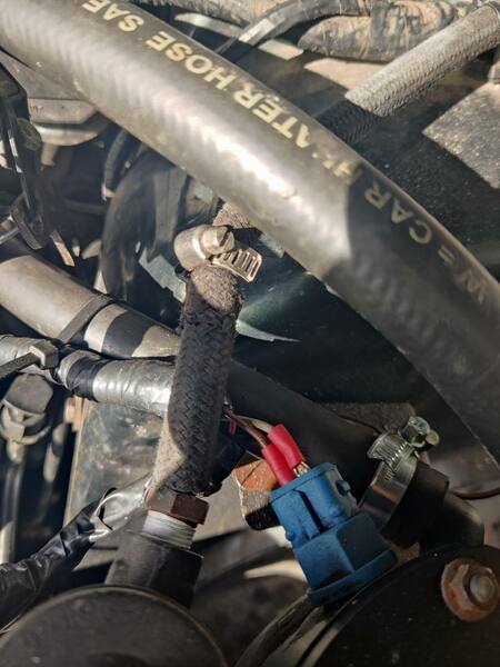

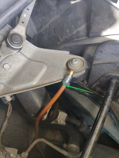

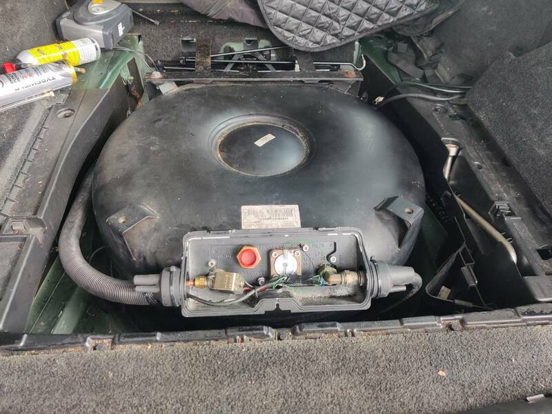

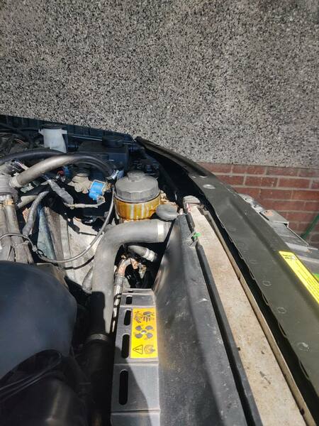

dome Posted April 10, 2021 Author Posted April 10, 2021 Range Rover next. The LPG system on it had been partly removed at some point and the recommissioned by the guy I bought it from. While it worked ok I wasn't happy about the hose used in the engine bay. I found a local specialist and too it to him to get it assessed. He pointed out a couple of things needing done and sold me the require parts to do it. The system runs copper pipe to the engine bay and then hose to the vaporizer. As you can see though, the unions and hose were questionable and not LPG suitable. New correct LPG hose cut to size with unions fitted. On at the pipe coming from the tank. And at the vaporizer. Routed correctly under the scuttle, out of the way of the wiper mechanism. Much better. That existing setup was extremely shonky. I'm glad I changed it before it failed. At the tank end I removed the connector to fit some ducting over it leading to where it exits the car. The idea is is there's a leak from the tank valve it'll carry the gas out of the car. While in there I replaced a single flare on the copper pipe with a safer double-handily this was familiar territory after doing the fuel and brake lines on the Jag. It's on the left here, heading round the tank to exit at the front of the spare wheel well. On firing it up I found one of the oil leaks... Never seen that before! I had oil and filter in stock so dropped that and replaced the filter and oring. Hopefully that'll help. Once warm it switched onto LPG ok and a quick test drive confirmed all was working. Whew! Saabnut, blackboilersuit, Cooper1 and 11 others 14

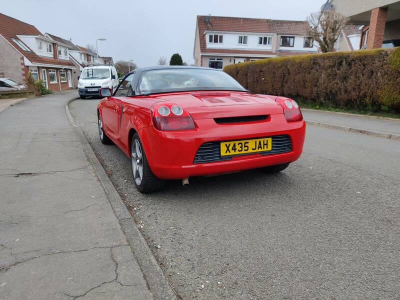

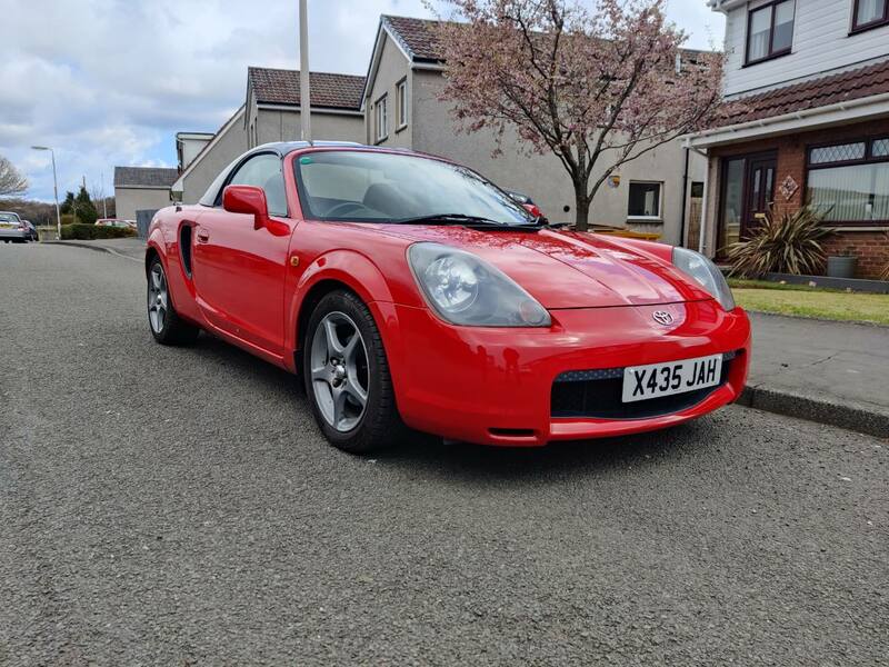

dome Posted April 10, 2021 Author Posted April 10, 2021 Oh, and Duncan popped by with the MR2, which he's gone and had painted without telling me. Its looking braw! privatewire, rainagain, Broadsword and 21 others 24

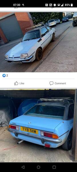

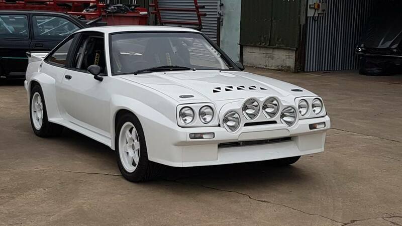

dome Posted April 29, 2021 Author Posted April 29, 2021 I've been poring over the classifieds and crying at the prices complete sheds of Mantas were going for. Yesterday morning one hove into view which had potential and a more bearable price. Messages were exchanged with more pictures and by yesterday afternoon a deposit was paid and collection booked. So, what have I bought? Here she is. Good points. Non sunroof coupe shell Tax and MOT exempt soon I think Been on the road certainly for the last 10 years or so at least. Bad points Rust Rust Rust Rust Rust is inevitable on one of these-the mot history shows plenty of welding over the years so it'll be doubt be a patchwork quilt underneath. Plans(look away now purists) Strip it and get the shell blasted to reveal the state of the shell Cry at the state of the shell Drink heavily for a while Add metal to make shell whole again(may involve professionals) Buy a 400 bodykit and fit it(more professionals required) Paint it white(again, professionals) Find a suitable* running gear-big modern NA 4 cylinder is the plan, to keep in the spirit of the original. Honda S2000/Ford Duratec or the likes is on the list at the minute. By the time it's anywhere near going on the road though petrol might be extinct so I may need to rethink this. Interior wise TBC but comfy and insulated for long distance cruising Completion time? Yes GMcD, djim, aldo135 and 37 others 38 2
cort16 Posted April 29, 2021 Posted April 29, 2021 Nice! What's the difference between the early ones and later ones other than the body kit? It it just the front panel? Are you going to weld it yourself? dome 1
Dick Cheeseburger Posted April 29, 2021 Posted April 29, 2021 Munter looks a cracking starting point, and the 1 owner with original receipt is a winner too. That'll look lovely with a repaint in blue and subtle modifications for a sleeper look. Oh...wait....😉 dome and Tickman 2
dome Posted April 29, 2021 Author Posted April 29, 2021 26 minutes ago, cort16 said: Nice! What's the difference between the early ones and later ones other than the body kit? It it just the front panel? Are you going to weld it yourself? Rumour has it the earlier ones used thicker steel, whether that's true or not I've no idea. Welding-likely not. Not only lack of skill but I'd planned to find myself a workshop/unit for the purposes of restoring it which I've failed to do. I did manage to buy a 4x4 rated to tow 3.5t and fit a towbar ready to go to the continent to buy one of these though, so I've got that going for me. Split_Pin and cort1977 1 1

CreepingJesus Posted April 29, 2021 Posted April 29, 2021 Can't say from memory whether the earlier bodies had thicker steel than the later, but I can tell you they all had thicker steel than anything Luton built. Working in GM parts at the time, the difference between Opel and Vauxhall in that regard was striking. I remember us having a clear out and coming across some old Rekord wings, which were a lot like the contemporary Carlton and Senator ones in make. Manta though...*dribbles* dome and Barry Cade 2
big_al_granvia Posted April 29, 2021 Posted April 29, 2021 it isnt that bad, was on the road until this year or was mot'd, fail sheet isnt that scary (compared to lots) get it welded to mot standard then treat as rolling resto. engine wise you must be looking at redtop on throttle bodies... the manta is still a popular rally car so parts are there. try talking nice to @DodgyBastard he is in your area plus he has just welded up a shovette of similar vintage Barry Cade 1
spartacus Posted April 29, 2021 Posted April 29, 2021 I'm pleased to see you've managed to find one locally and haven't had to travel to Europe, it would have made a great thread but ultimately been a pain. The shape of that one is very pure, I'd be wanting to make a sleeper but I can also see the allure of a 400 kit, a local had one back in the day with a RV8 fitted and he was a bit of a hero in it. Barry Cade and dome 2

dome Posted April 29, 2021 Author Posted April 29, 2021 25 minutes ago, spartacus said: I'm pleased to see you've managed to find one locally and haven't had to travel to Europe, it would have made a great thread but ultimately been a pain. The shape of that one is very pure, I'd be wanting to make a sleeper but I can also see the allure of a 400 kit, a local had one back in the day with a RV8 fitted and he was a bit of a hero in it. Thanks! There's some lovely clean Manta Bs and I wouldn't rule anything out but the allure of a 400 kit is probably going to be hard to resist. In one step I'll get new wings, arches and sill covers which will help hide a multitude of sins. Plus, just look at this😍😍😍 privatewire, Barry Cade, loserone and 8 others 11
