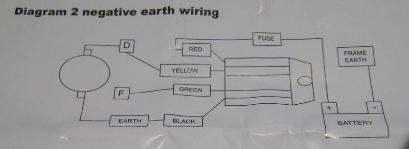

strangeangel Posted May 12, 2020 Author Posted May 12, 2020 So the new solid state regulator arrived today and I thought I'd have a crack at fitting it and the new battery. The first thing I noticed is that the starter still turns over reeeeeaaaalllyy slooooooooowly, so the probably isn't anything wrong with the old battery; it's the starter that's on the way out. Still, the old regulator needs to go as it was overcharging the battery significantly. The second unwelcome discovery was that the battery isn't charging. At all. Here's the wiring diagram, I'm pretty convinced I wired everything up right: Earth connected to black, DYN on the dynamo connected to yellow, F to green and the fused (15A) goes to the live wire (the remaining one attached to the old regulator. When you unplug the red wire, my meter was showing the output of the regulator as 0.6V at tickover, revving the car produced 2V. Also, when I revved the engine up, the big red charge light on the dash got brighter. Argh. If anyone's got any ideas I'm all ears. UltraWomble 1
strangeangel Posted May 13, 2020 Author Posted May 13, 2020 The plot thickens. I assumed that the dynamo was OK, given that it had previously been charging the knackers off the battery at 8V+. Once the mechanical regulator was replaced with a new, solid state one the system now produces a maximum of 2V - so, naturally I suspected the aforementioned regulator. I've just done the dynamo output test - join D and F together and measure voltage to earth - and the fucking dynamo is producing... 0.6V-2V when revved. So this points to the regulator being OK, and the dynamo being faulty, which must have only just happened?? Could the old, duff regulator cause damage to the dynamo by allowing it to output too high a voltage? Puzzling. Second hand starters boasting unknown provenance and no warranty are £150... so it seems as though the next job is to get the starter and dynamo rebuilt. The first place I rang in Huddersfield said they would normally do that, but not at the moment because lockdown. On the plus side, the BX is home. The cloud that goes with that particular silver lining is the 4-digit bill that accompanied the car: complete exhaust system front discs and pads bottom arm rear bushes 1 x strut top mount n/s/f inner CV boot n/s/r suspension gaiter o/s/r brake pipe n/s handbrake cable a lot of LHM some gearbox oil 2 x Uniroyals weldage to n/s sill "Just bring 'er back when you want the rear spheres doing!" "Yeah, that might be in a month or two" ? Cleon-Fonte, scdan4, UltraWomble and 6 others 9
