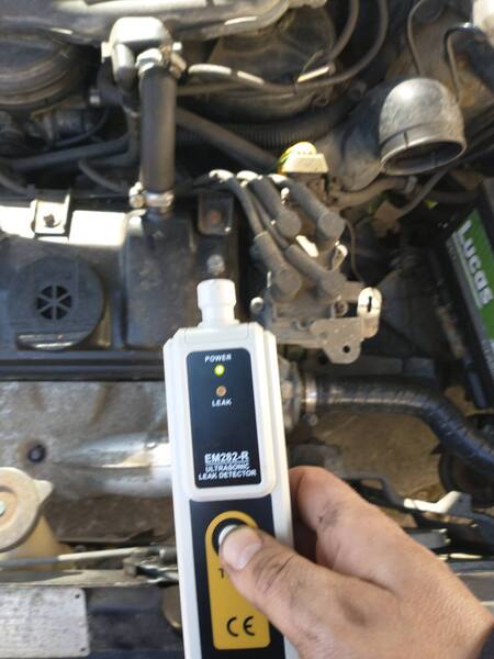

A few weeks ago I had been scratching my head to try and find vacuum leaks on the turbo mx5.  After looking at smoke tests I found they were £££. On eBay instead were ultrasonic Chinese testers.
Duly ordered and then forgot about.
Till this morning - a big package arrived for me.
It uses the principal that leaks emit ultrasonic waves and this can detect it.  With the headphones it sounds like a Geiger counter.
The second module is an emitter. If you have rain leaks or similar you can turn it on and put in the car, using the detector you can then find the leak.  In theory.
My mx5 wouldn't start with no fuel, so I borrowed bucketeers AX as a test mule.
Headphones on and then wave it over the engine
We have a hit!
Zoom in
Ohhh lookie
Split hose.
So initially it seems to work - could be a useful tool

Wow I've never seen one of those before. looks well useful, specially for investigating the classic 'just needs a regas m8' situation
That looks really useful. Previously I've just been spraying easy start around the engine bay and hoped engine revs picked up.
This looks a lot more accurate.
Ebay or Amazon purchase?
The sort of thing you might expect to see Edd using on wheeler deelers
I reckon it would be good to hunt down annoying vacuum and water leaks.
It was eBay buy - about £40. I was mostly expecting it to be pants - but seems to work.
I had been looking for a smoke leak kit but they are mostly USA and £££.
VOODOO GADGET.
Big want. Thanks Mr Puss, top tip.

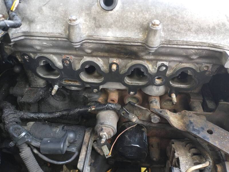

So fuel was getting into the cylinders. Although plugs were really really sooted up. Cleaned up and made no difference so left it to think about its actions.
Next day it was back to it - i decided to stick the old fuel injectors as that would reduce the number of variables.  First I had remembered I took an earth off to clean - so triple checked that i hadn't missed a connection.  Sadly it wasnt that simple.
Time to get the fuel rail off - it is just a case of ICV off then you should be able to hoik it out.
Lovely old job, until one of the injectors made a bid for freedom. Dropping down behind the starter motor... ffs
After much sticking my hands in tight places and waggling grabby things I decided to bite the bullet and pull the inlet manifold off again.
can you see the little blighter?
Peekaboo ...
I swapped over the seals from the new injectors on to the old ones as they were past their best.
The little hook tools make this a doodle.
I also took the opportunity to clean out the injector holes as they were a bit icky
Old injectors with new seals all back together
The old injector seals were definitely fit for the bin
