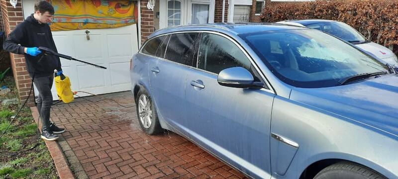

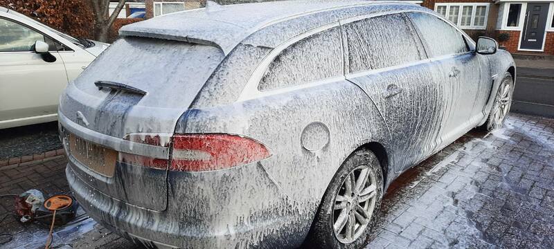

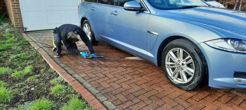

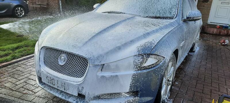

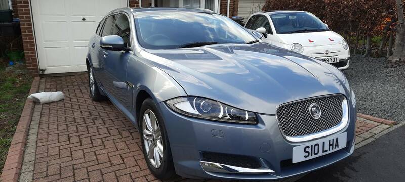

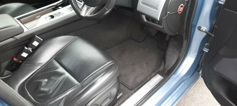

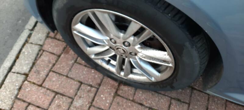

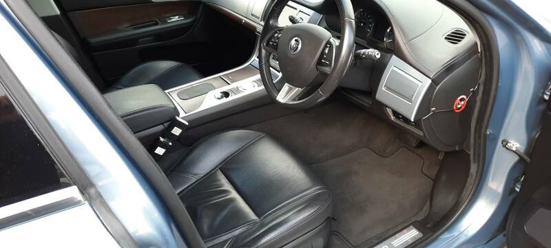

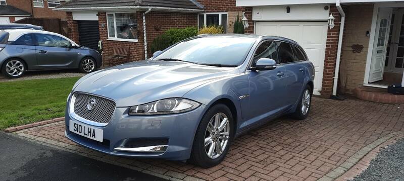

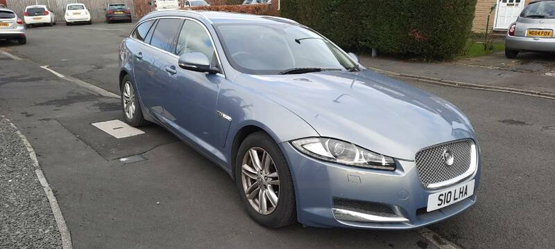

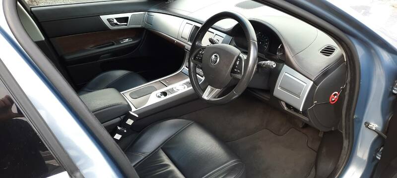

For Christmas my lads bought me a DA polisher. We took it out of the box for the first time last week.
My oldest lad did his Fiat that came up very well. My lad showed his grandad who said can you do my car?
So last weekend that was given the works. Grandad then showed his car to his brother who said would he do mine? I'll pay him.

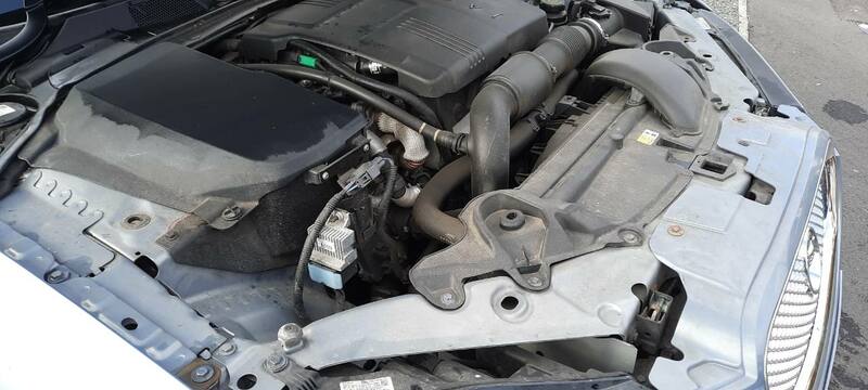

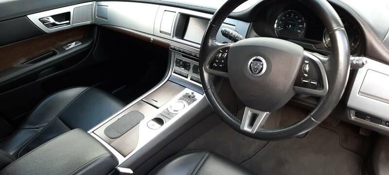

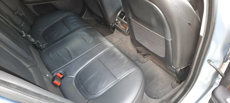

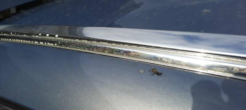

So this morning we picked this up.

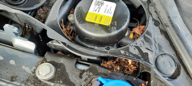

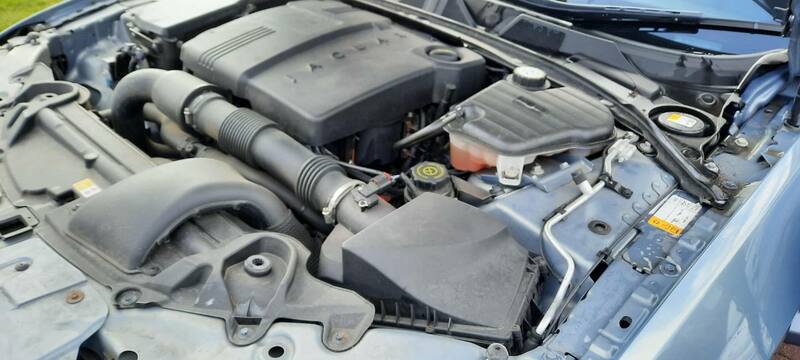

Under the bonnet was full of leaves
So we hoovered and cleaned
Then out came the drying cloths then the polisher.
 So jet washed, snow foamed,  washed,  dried , polished and waxed.
The XF was then delivered back to a happy owner.

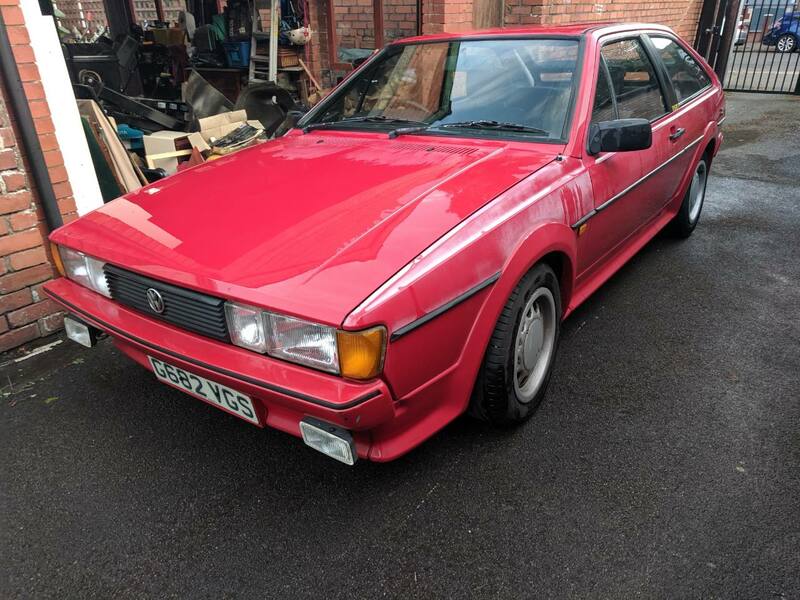

Two-bucket fetishists, I'm after advice.
What products should I buy to tart up the comedically pogweaseled Derv-rocco? I have no equipment other than two buckets, a mitt, and some clay bar.
Below is after a basic wash-and-wax shampoo job.
Best shampoo, wax etc?
You really need to machine cut the paintwork back with a rotary or DA (recommended) polisher then polish wax and seal, I use meguiars ultimate compound, then the ultimate polish then either bilt hamber double action wax or meguiars ceramic wax to finish.
It takes a lot of effort but once done you can just give it a lazy 2 bucket wash once a fortnight to keep it looking good.

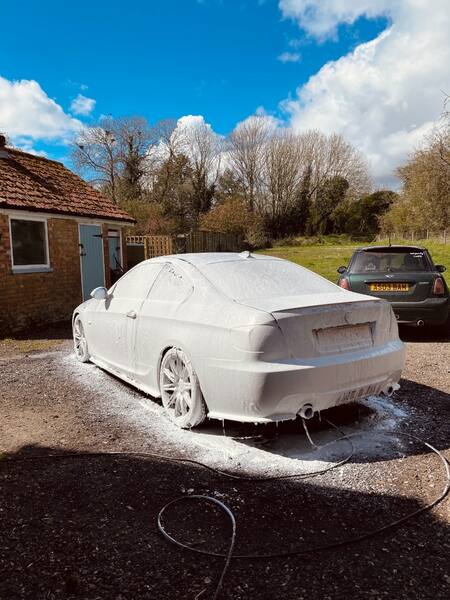

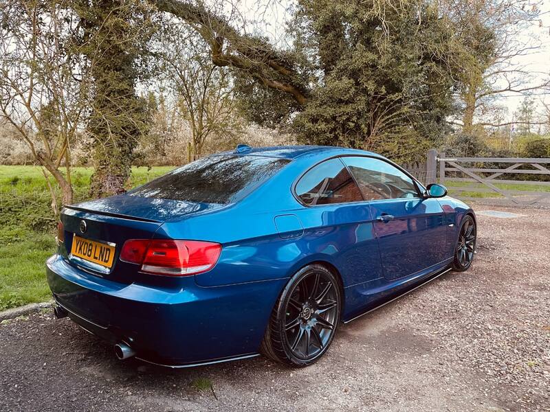

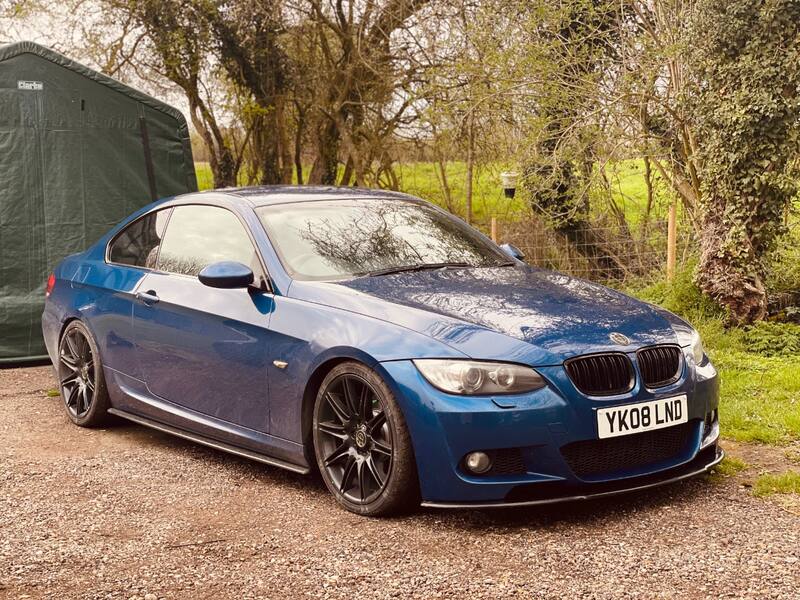

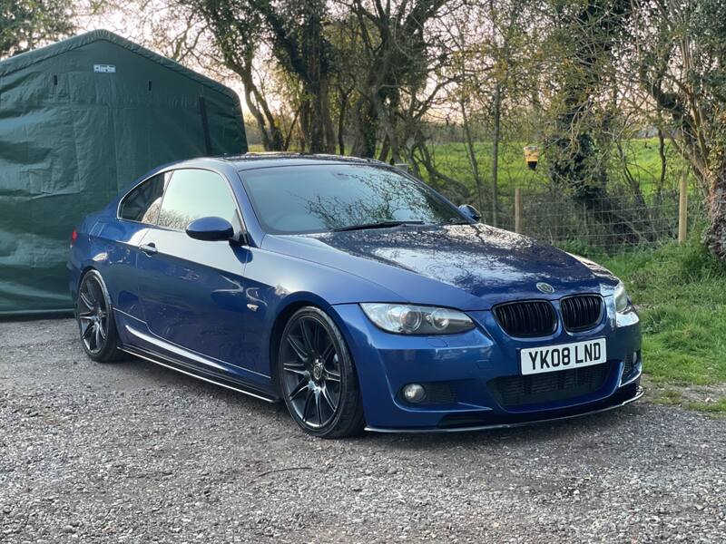

Before, during and after on the 335D

Tidy work. Those XFs are pretty looking things, especially when cleaned up. Are they Ford based like some of the older models?

I need you to stop posting pics of that, it gives me the fizz every time I see it.
What colour is it? It looks like it's got more green in it than I'm used to seeing from Le Mans blue. Don't know what other Blues they did on them though?

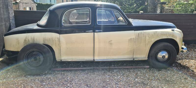

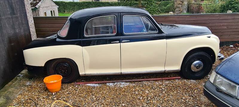

Would a D.A work on this and revive the paint ? .. or would it kill it and make me shout 'FAWK'
Unless the paint is flaking or otherwise compromised, a DA should bring that back OK. I used mine on @320tourings Oxford which probably hadn't been polished since the 1970s and it came up really well.
Just use a simple polish and keep the machine moving or you'll burn the paint.

Haha, I’m in love with it.
It is just Le Mans, just cleans up well and iPhones take pretty decent photos in the right light.
it doesn’t look as good, or as bright when it’s out of the sun...

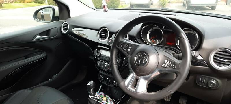

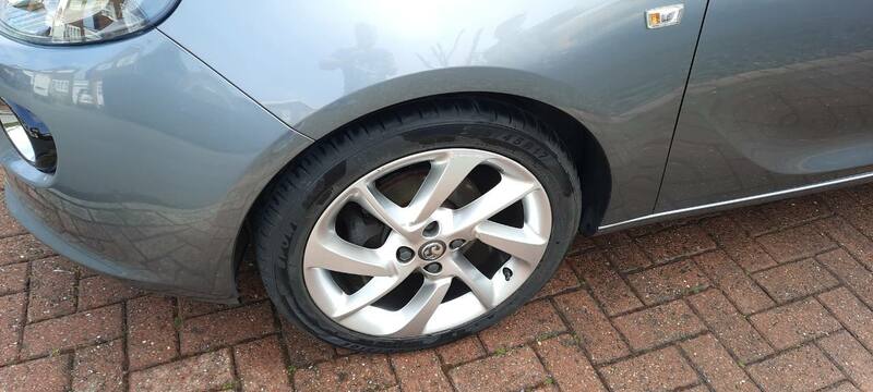

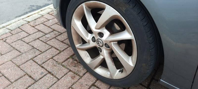

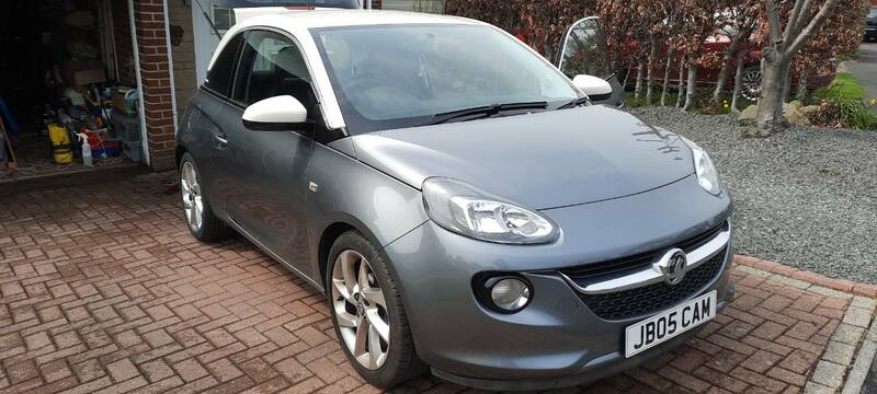

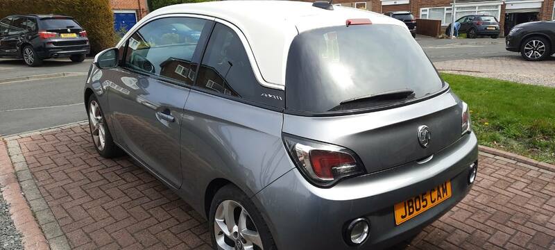

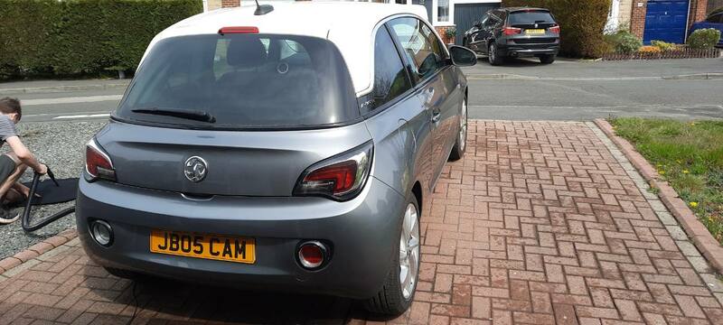

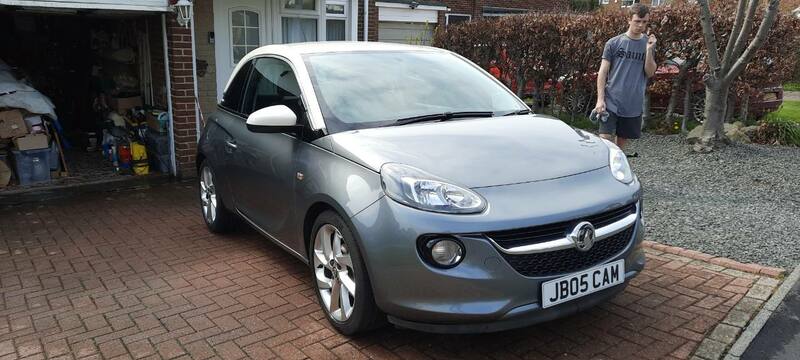

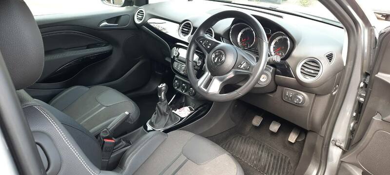

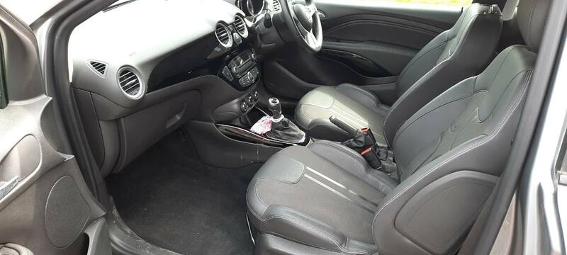

This morning I was washing MrsV8's car and number 1 son was washing his Fiat. When our next door neighbour pulled on there drive  we had a chat. She said she was going to sell her car and would no1 like to give it a hoover and a clean
An amount of folding would be handed over.
So what do we have? We'll its a 17 plate Vauxhall Adam. They have owned it around 18months and its not been washed in that time.
Hanging inside with split coke/coffee, it hasn't got any mats in. The carpets seemed to have a mix of grass/ soil,  coke, hair and fag Ash.
The door cards though plastic were marked/damaged where she pushes the doors open with her foot.
The top inside of the hatch was green with rain.
Tidy job on the Adam!  What’s the quality of the interior like?  A cut above a regular Vauxhall?  These were sold as a premium car when new I think.
