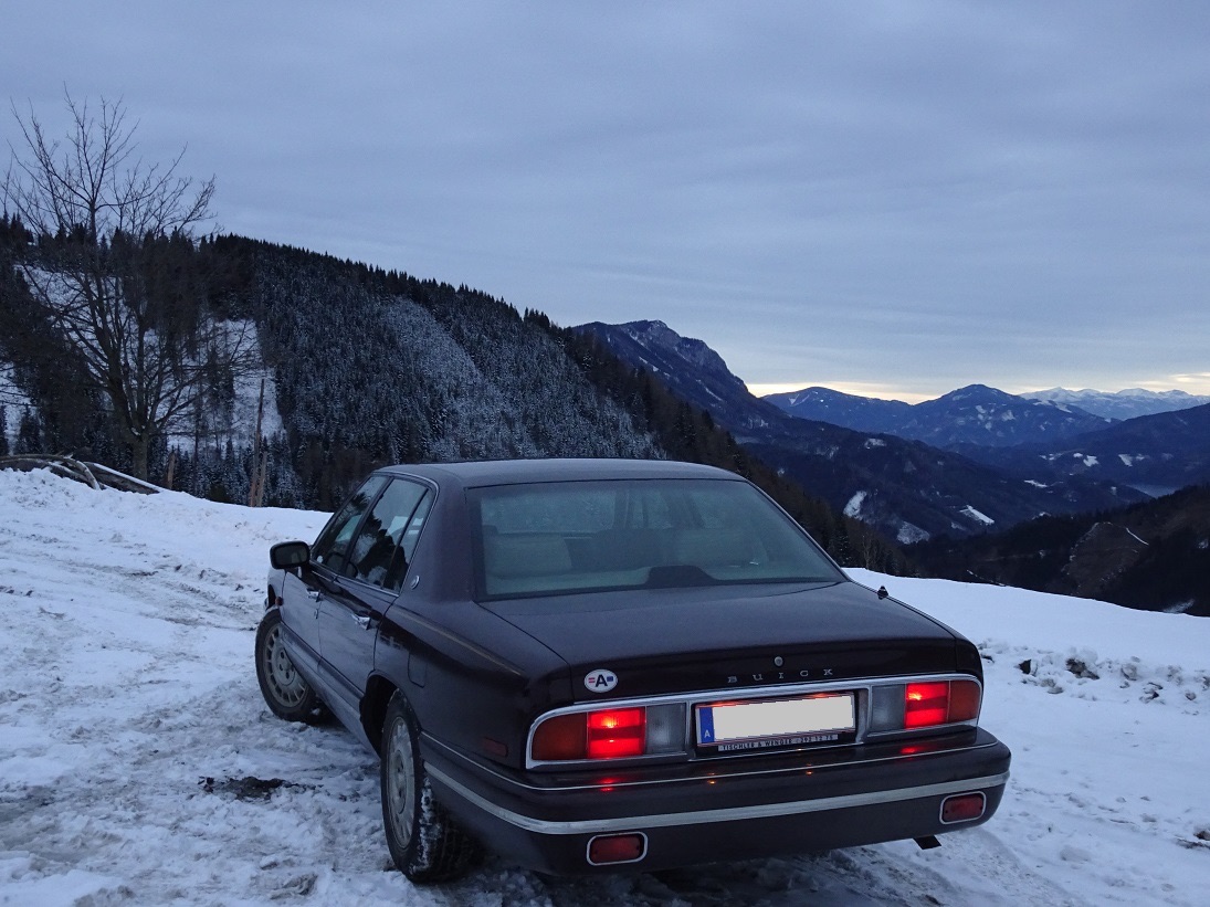

It was a nice and relaxing drive and of course I had to drive over the mountin saddle again. And ~ 100 metres before the crest, I almost
made it, the "Check Engine"-light came on again.  :mad: So the car hates mountains. The light never came on when driving in town or on the
Autobahn or in the flat country.
But no matter what, I was in the mood to take a picture on the crest:
Not much snow as you can see. There should be at least half a metre more.
After I got home, all lights on but no problems thankfully, I checked and the Fault-Code "Transmission Component Slipping"
seems to be very popular with GM-cars in the US. Some say it´s an expensive repair because the torque converter has to get
changed and the transmission overhauled, others say it´s not a real problem: "Just drive it as long as you dont have problems
while driving it.". Hmmm...  :?
I´ve just bought an OBD-scanner so I am able to clear the fault code by myself. Let´s see if the "Check Engine" comes on when
driving on normal roads too now or just on mountain roads.
