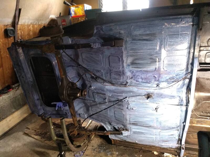

Back on with the cleaning of the underside of the car.
Happily they did exactly what I wanted, so snidy Brillo pads for the win.
Who'd have thought Asda would be for the win!
I've got to the point everything behind the crossmember is cleaned off so I made it blueish.
Then I rolled it back a bit to start the fixing of stuff.

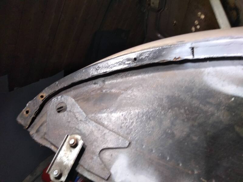

Time to decide what's first. This bit of the rear arch looks complicated enough to repair.
Quite awkward to get in with the grinder.

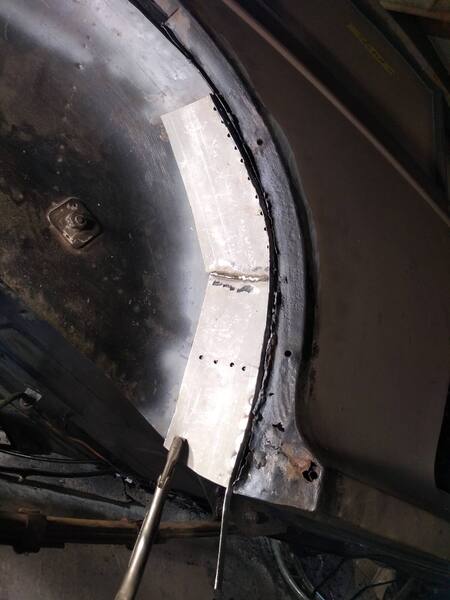

Started plugging some of the holes. Started by getting this out and putting a 90 bend in some steel.
Then some card was used.
Roughly the right size.
Then make the slight curve.
Check for fit.
Yep, that will do. Apply some weld through primer.

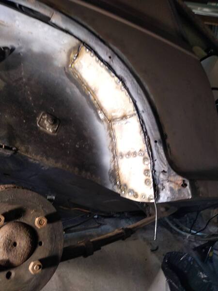

Get welding and a bit of a dress back.
Next bit.
Piece for it.
Check for fit.
Stick it in.
Dress it back and a bit of paint to cover.

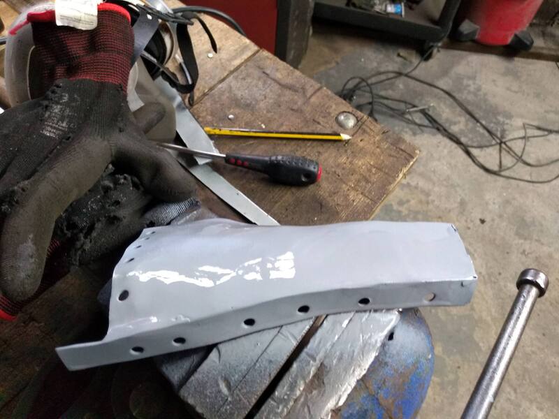

Used some card to give me an idea of the piece needed which was something like this.
Quick bit of paint.
In the hole ready for welding.
Then welded, dressed back and a bit of paint.

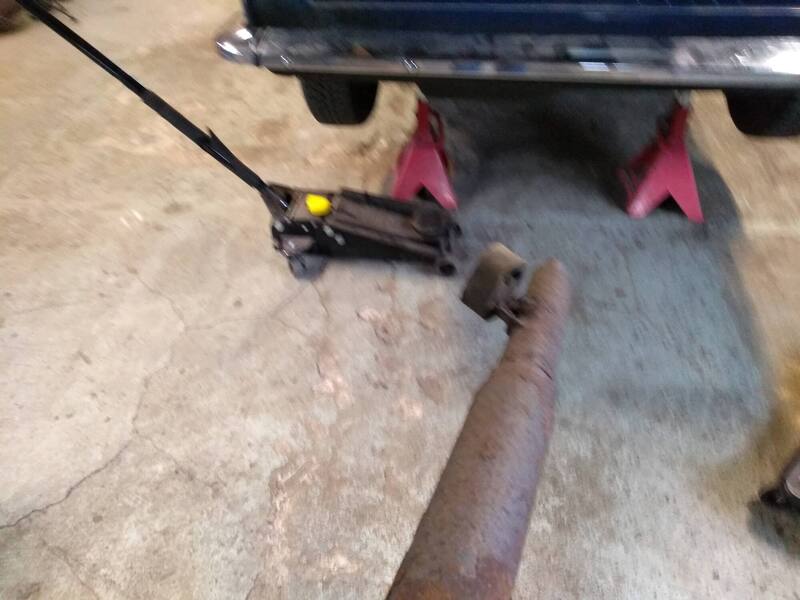

I've been doing other stuff for a few days, when taking the bin out yesterday I noticed the exhaust on the Toledo wasn't sitting where I normally does. A quick look underneath showed some fuckedness.
I had a look online for replacement parts and the only system available if a stainless system through the club for £315. That will not be happening.
I took it to the workshop and up it went. I pulled off the tailpipe that was loose.
It took quite a bit of effort to remove that. This is the bit underneath that is left.
I checked the whole system and it is just the last corner and tailpipe that is knackered so some bits were ordered last night. Exhaust parts are surprisingly difficult to find on the internet and I couldn't find any others apart from Jetex that @dome had recommended. So some Jetex bits from Demon Tweaks at on their way soon.
