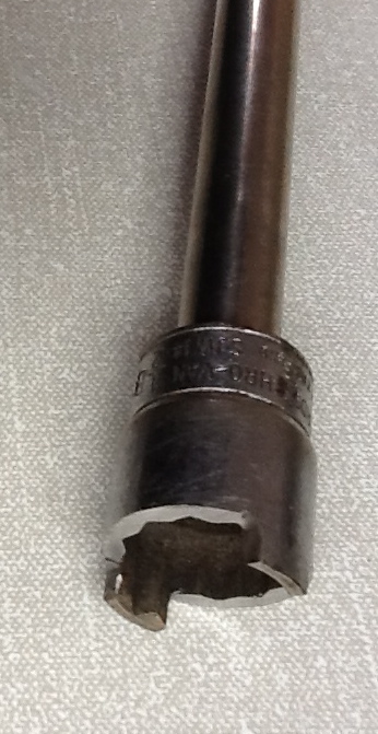

Easy enough to make a wind-back tool with hacksaw and an old socket.
Choose a socket from that box of rusty old Whitworth sizes that you never use*.  About the same diameter as the piston you are winding back.
Saw off two bits of socket so as to leave a pair of pegs that fit the piston.
(Although socket spanners are tough, they are not hard and the steel saws easily)
Adjust with file if required.
Wind away.
*If you find Whitworth socket sizes useful, you probably don't have pistons to wind back into calipers.

X1/9 rear pistons have a slot on them which is 1/4 inch wide (it's probably the metric equivalent) so I used a 1/4" drive ratchet and extension bar to wind mine back in, along with just a soupcon of WD40 to protect my seals.
