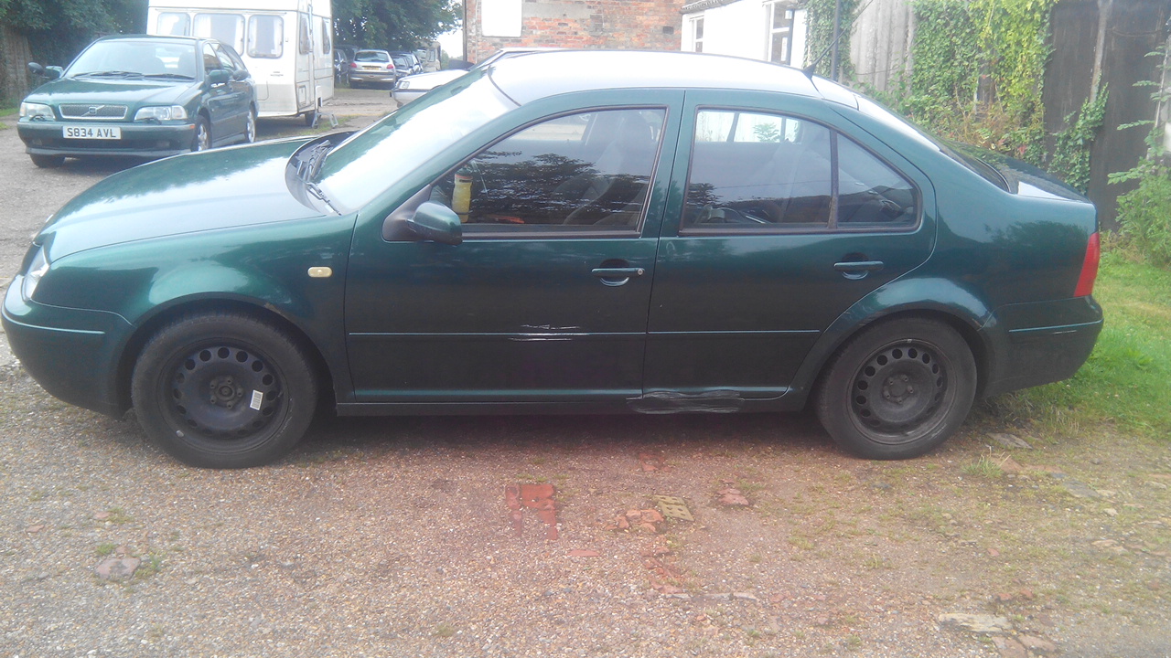

The transport of choice, the boring

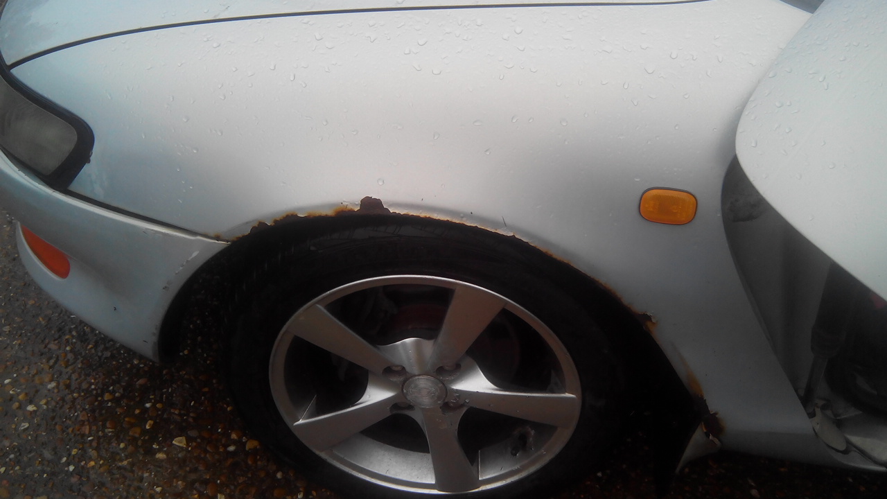

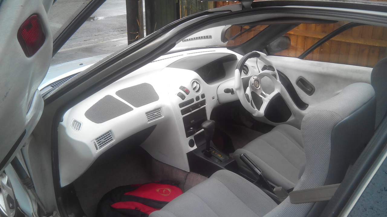

I see the car, it looks bad, rust on arches, but the interior is the worst bit, filthy, missing a few bits of trim and white, very very white. Oh, hang on the plastic in the back is beige, has some muppet painted the front trim white? It looks like it ... what a twat.

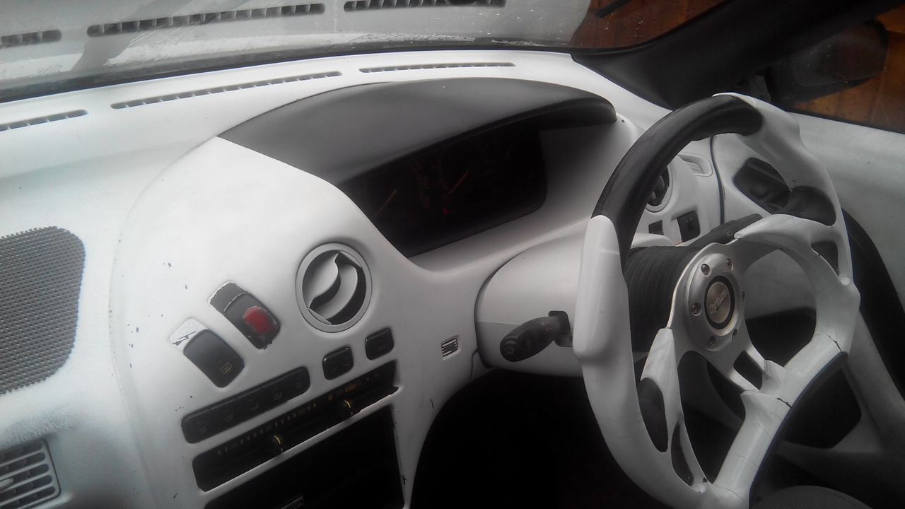

I cannot get over how white the dash is and how badly it has been done in places. I notice that the black paint on the hazard switch has worn off, that can't be a good thing, a well used hazard switch.

The car goes pretty well, I can't see the clocks because of the stupid, hideous steering wheel, and the wind noise is louder than the engine on overdrive. I certainly did not notice the car at 140kmh and doing 3000 rpm at that speed because that fucking steering wheel is in the way. I wonder how you get the wipers to park in the right place, surely it can't be difficult ...

First glance ... white
Hang on ... the white is flaking/peeling in  places

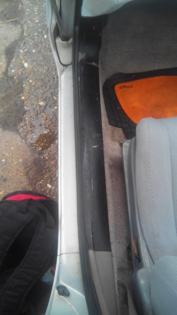

Seamless

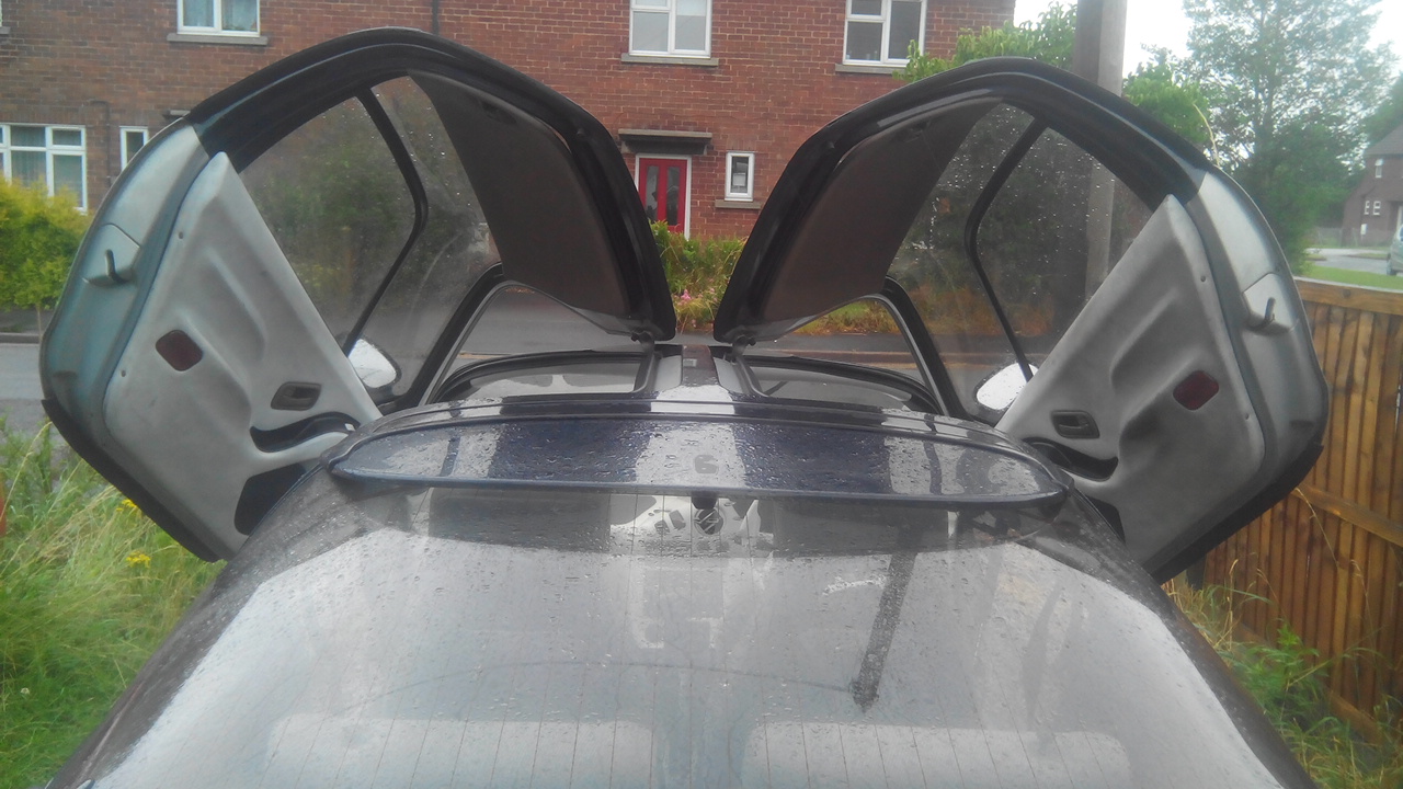

The door struts hold the doors open ... barely
I wonder how bad it is when you look closely

Dashboard - remove, strip paint or flock
Centre console- remove, strip paint or flock

That interior is interesting right enough hopefully the paint will just all fall off . The steering wheel is a horror.

I reckon the paint will come off with some time and patience.

Chris, that's ghastly. I do quite like a nice Sera, but this one...
In which universe could anyone possibly think a white dash would be an improvement?

With the doors - make sure the pivot at the top of the strut - goes into the door and connects to the balancer - is free to move. Usually they're stuck. They have a much more important role in the door mechanism than you might expect. kicking the balancer to move the internal weight and make the door rise.

I'm hoping to be able to remove the paint from the dash, centre console and the massive door cards. I was thinking of trying acetone to start with then moving on to stronger stuff if necessary.
If the paint removal is unsuccessful or results in a mess (quite likely) my plan was to get the the dash etc flocked.
I have to say though that it's a cracking little car to drive. The engine is really perky and the handling quite respectable. They produce 108hp from the 1496cc motor and weigh around 900kg.
Acetone might melt the dash plastics if they are ABS, Xylene would probably be a better bet as it's oily and doest dry as quickly and seems to remove all kinds of dubious sticky substances at work, try in a well hidden area first though.
You can solvent weld plastics with Acetone so I wouldn't let it near any dash plastics
Wear gloves.
