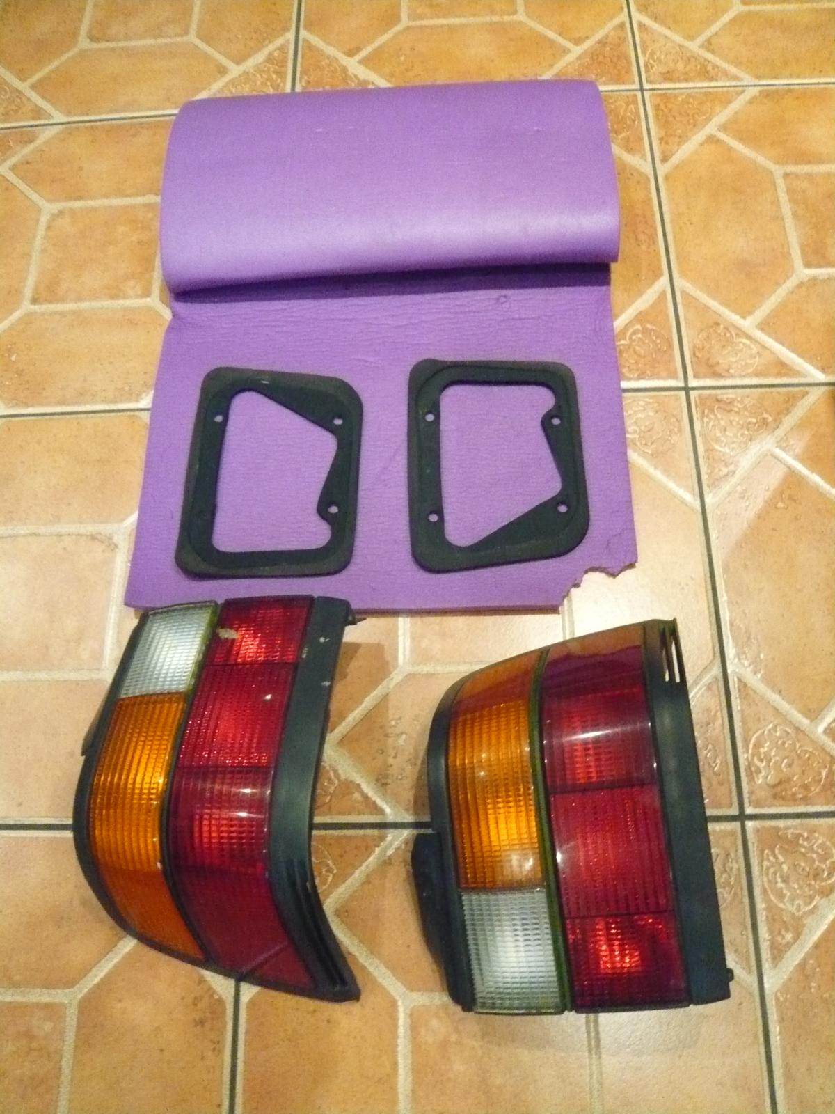

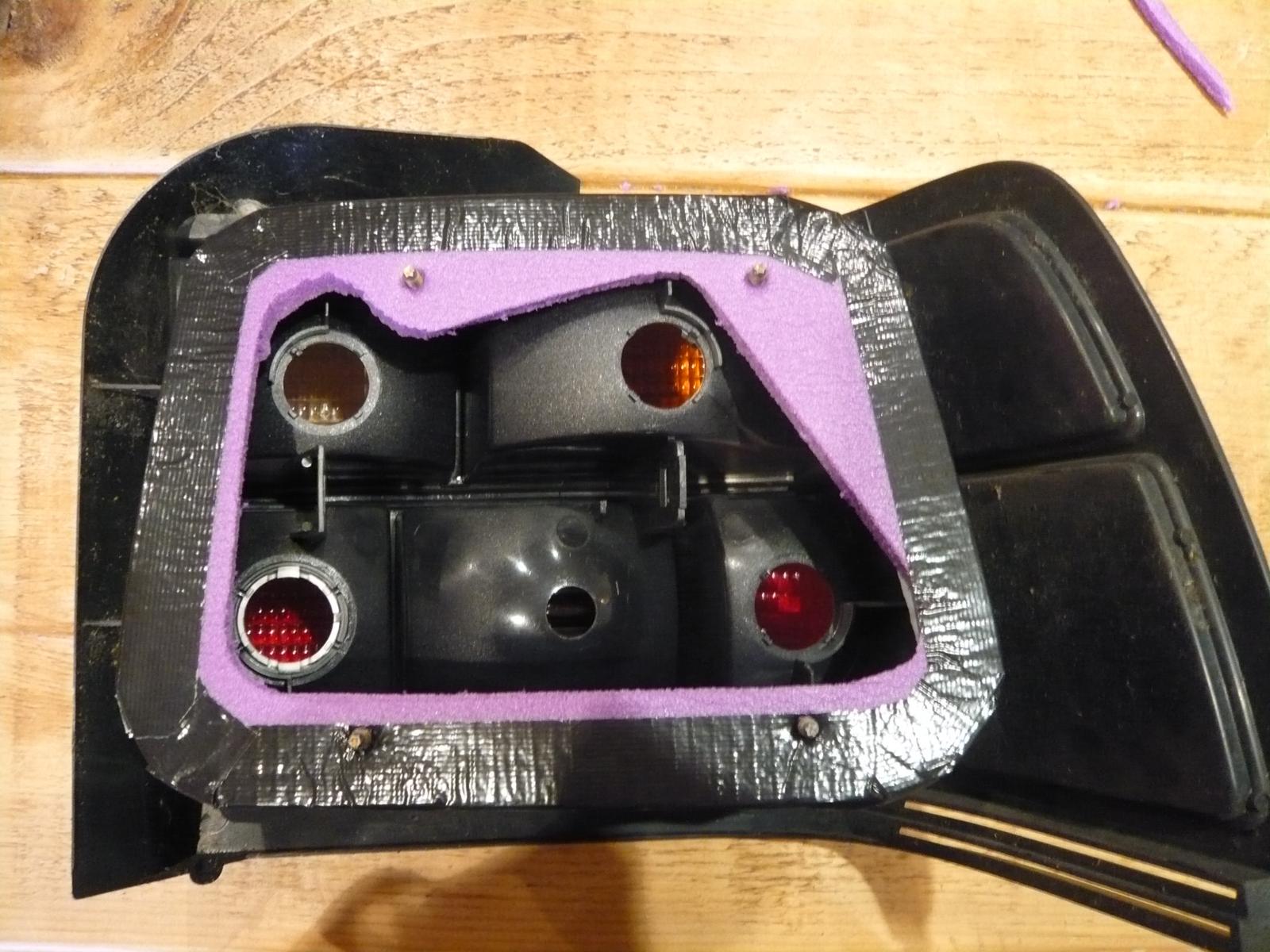

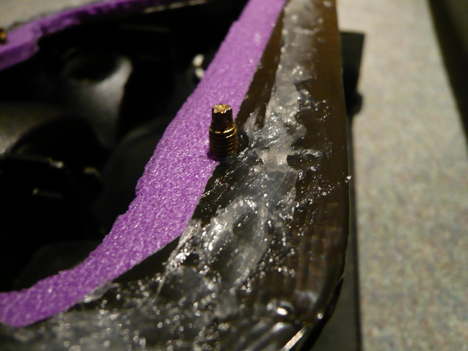

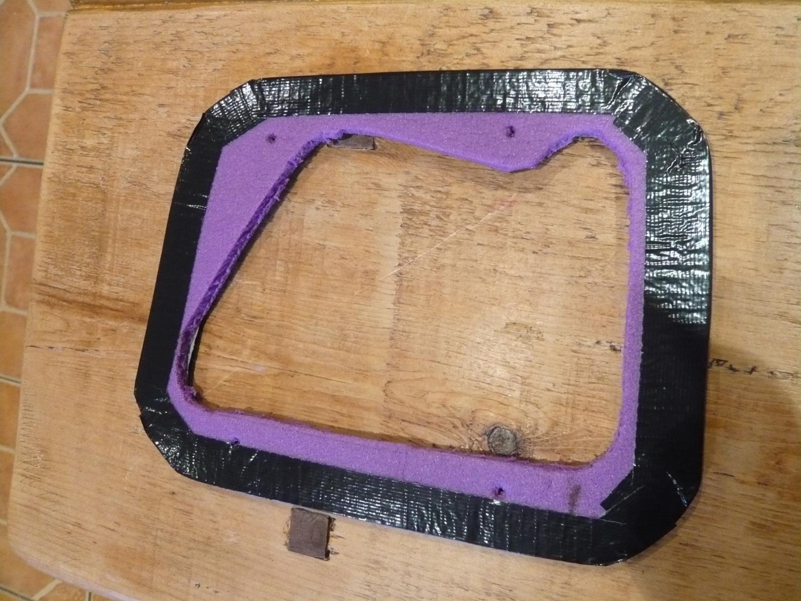

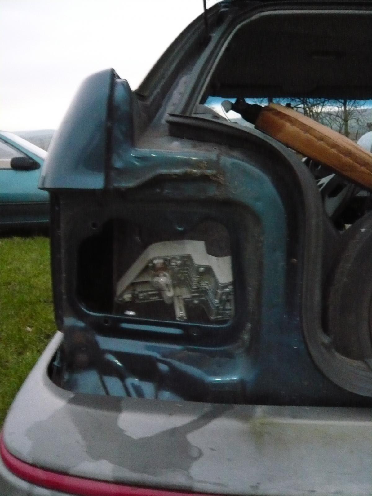

The last job I did was resealing the rear light cluster.  I checked this when I got home and the water ingress is now limited to one spot which I'm struggling to understand.  I had thought the water was only getting in between the seal and the bodywork, which it now isn't, but on inspection it appears to be getting through the two pieces of metal that the light cluster bolt goes through and I can't really figure out how so I don't know what to seal up to stop it.  I'm wondering if it's blown a seam just enough to let the water drain through the panel gap as normal but then drip into the car.
In good water leak news, the passenger side light cluster isn't leaking and the vents have remained absolutely bone dry even after driving through puddles.
