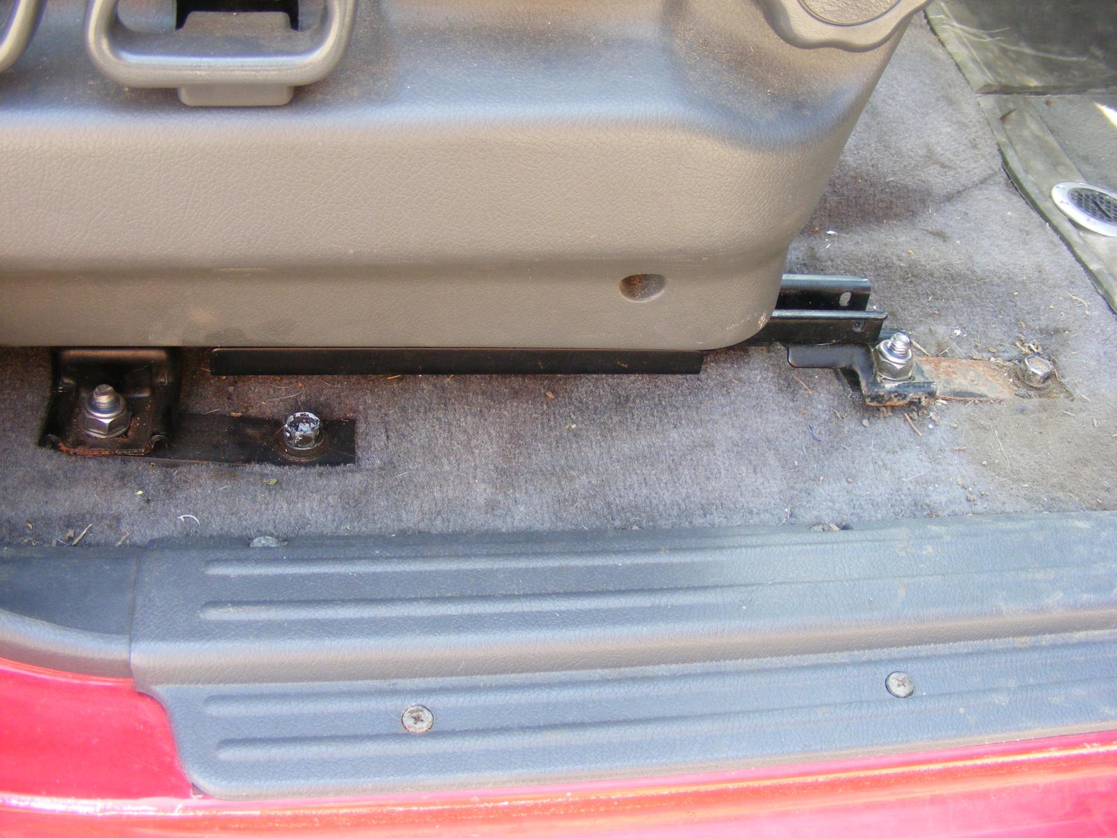

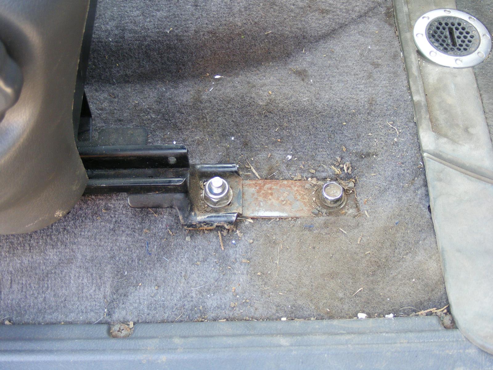

I had to do this on my Pajero  ,
 i just cut 4  metal strips and drilled 2 holes in each of them  poked a bolt through one of the holes then used the other hole to bolt it to the floor through the original floor mounts then refitted the seat onto the 4 bolts sticking up through the metal strips .  The seatbelt is bolted to the drivers seat  on this so no problem.
as that sounds a shit description of what i have done I will take a photo tomorrow

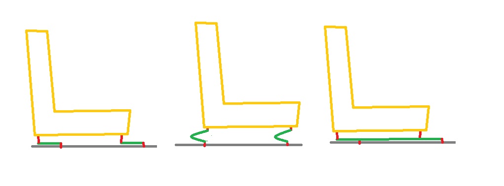

Please don't take this the wrong way but if I was an MOT tester I wouldn't pass that as it is.  I'm probably wrong but I think the seat would move forward and bend the metal upwards if you had a crash as the strip would be strong in tension but not in compression.  If you had used a continuous strip of metal it would be a lot stronger as the rear fixing points would stop the front ones moving forward.  If that isn't possible could you replace the strip with angle which would be stronger.
If I was moving stixy's seat I'd be drilling 4 new holes and applying a suitable sized chunk of 3mm plate on the outside as a spreader plate.
It could be better i know   but it was a quickie 8 years ago  , the strips are 8mm thick    and with the lack of headroom and my 17st  its not going to bend much  .   4 new holes would be ideal  but i cant remember why  i couldnt do that at the time as it would have been easier
Yep, I'd put some plate down too and then you'd be fine.
