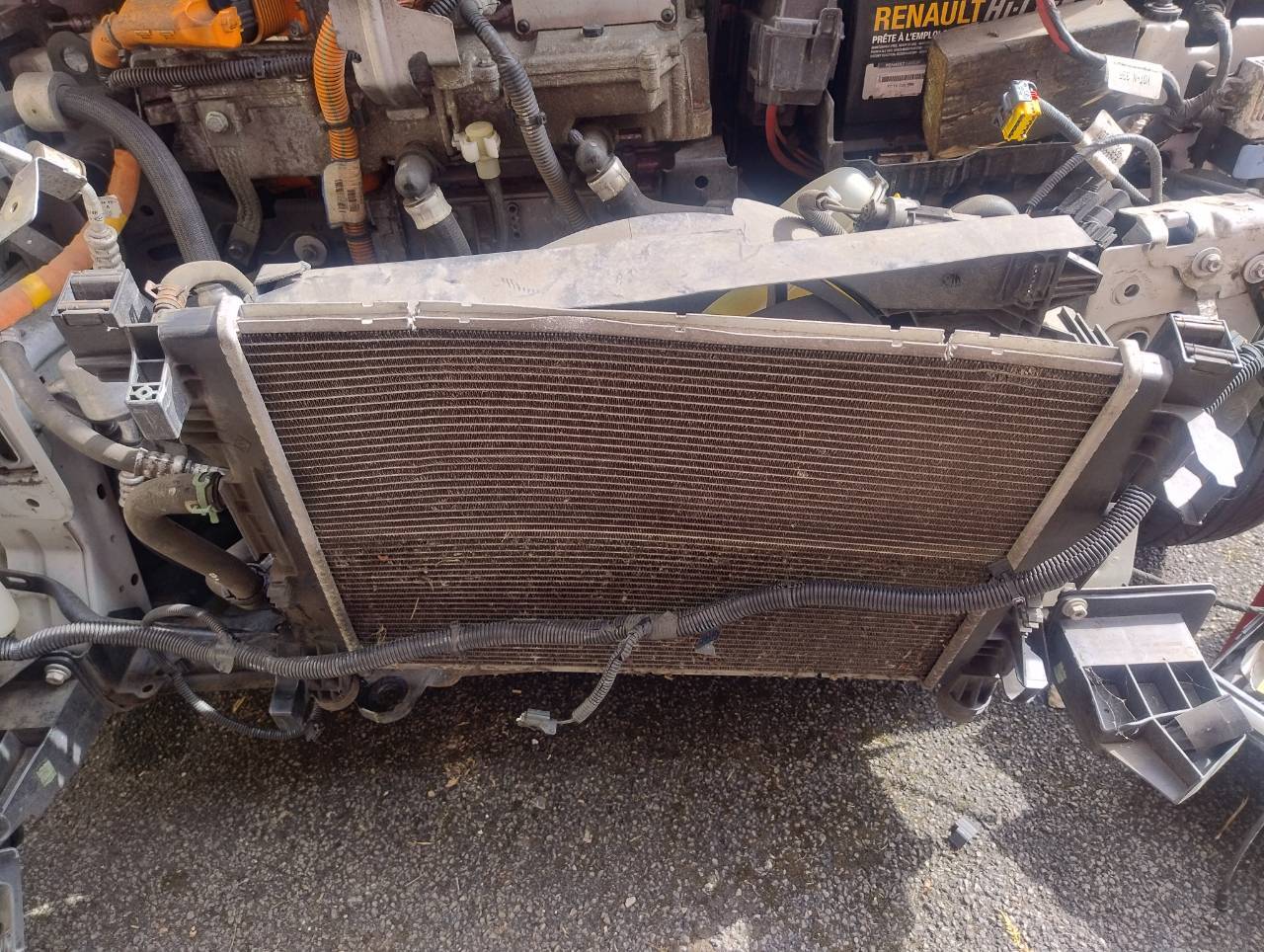

Had another look and the condenser is actually well bent, so ordered a new one for £106.
Made a start on this ready for the condenser turning up at some point.
First things first, it's the coolant radiator that's bigly bent:
The condenser I managed to wangle out, and it's maybe slightly bent but not too bad. Not in the first flush of youth though.
Not sure now whether to stick the new one on anyway or put it back together and get it pressure/leak tested with the old one? As it could easily be leaking from somewhere else instead/as well.
I think I will order a coolant radiator as I'm not happy about putting it back on now I've seen it. There are dire warnings about needing to disconnect the HV to do it as the coolant cools the motor? I reckon I will use some clamps to avoid draining the rest of the system and see how I go. It's not a major issue to disconnect the HV though.
£64.59 for a new Denso (same as OE) rad with an eBay discount code.
From a ratch round Google, the dark staining on the left hand side of the condenser is evidence of a leak so will just go with the new one when it turns up.

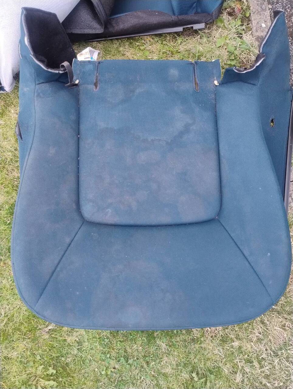

While it's off the road I am also doing something about the minging interior.
I've read that some Renault seat covers can be machine washed. Don't think these are actually one of them, but it's happening anyway.
The rears came off the foam OK, just attached with zips and a few hog rings.
The fronts, the back rests don't seem to want to come off easily but the bases do. They are not possible to detach from the foam, so the foam has been crammed into the machine.
Delicates, 30 degrees, 600rpm spin speed.
Will report back.
I did the same with some Berlingo seats recently, it had been used as a plasterers van and was minging, came out like brand new. Was labour intensive, but worth it.
