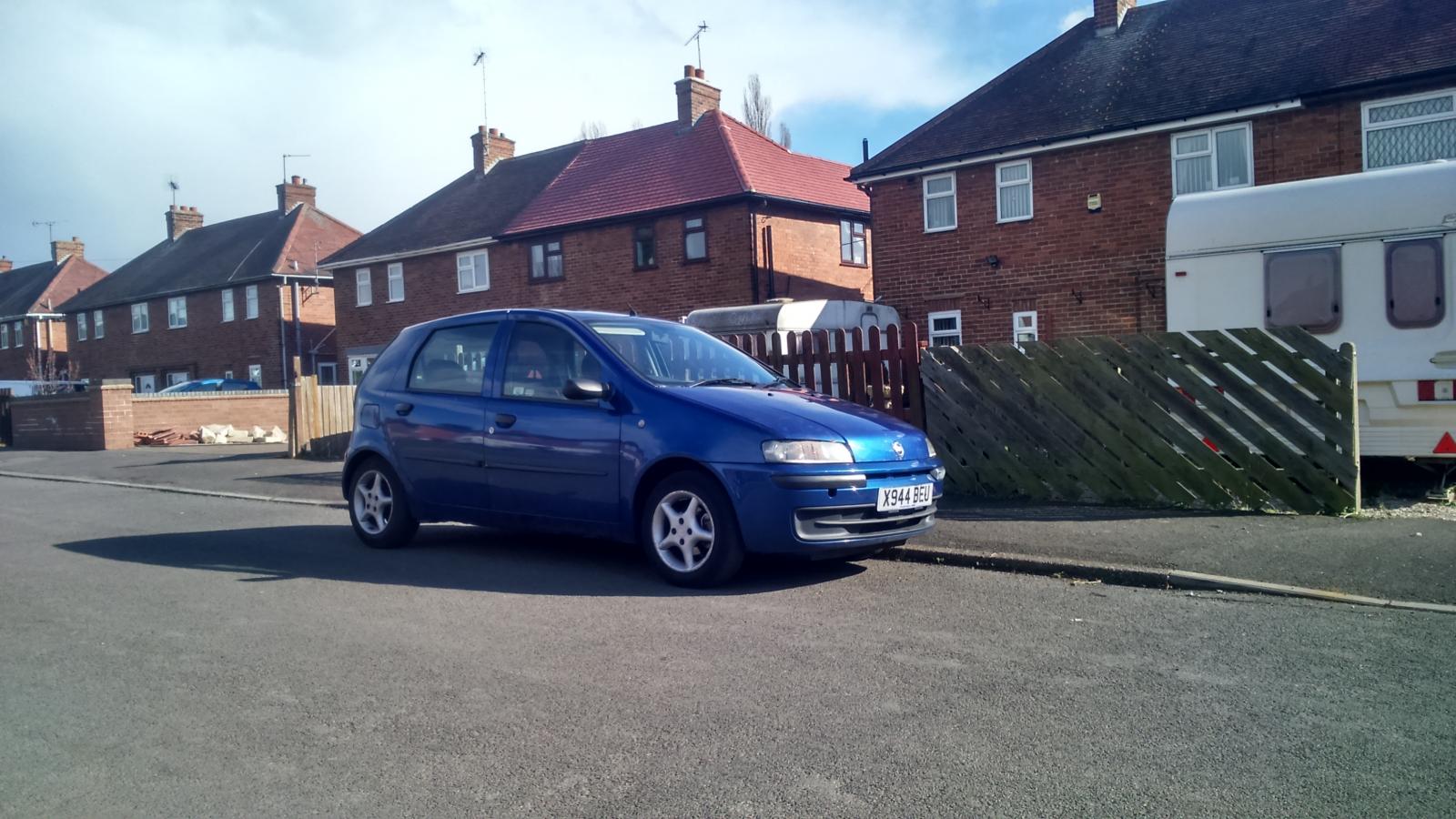

Just picked up a 1.2 8v fiat punto. X plate with 97k on clock. Elx trim so such frivolity as trip computer, electric windows,electric sunroof,central locking and factory fitted sub in boot. Mot till December for £280. Small clang on exhaust and sunroof won't slide back properly. Need to sell corsa now! How accurate is mpg computer on these?

Seems ok so far fingers crossed, as for rot I know early ones rotted like a metro but unsure of these. This one seems solid though. Got to sort sunroof, tilts fine but only slides back an inch. Got an oil leak which I think is from rocker cover. In this day anything running under 500 notes with mot is good going. Really comfy and quiet so I'm hoping it behaves. Not many of this trim about I've noticed either

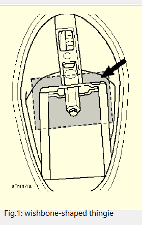

The exhaust clang might actually be the handbrake cables whacking off the floorpan. Take out the rear ashtray and see it the wishbone-shaped thingy is rattling around.
wishbone-shaped thingy .
Steady on blinding us with technical jargon, sauce!
tapped on the radiator using morse code
Behold!
I stuck a bit of an old car mat under the one I fixed (blue car I posted on here about 8 months ago)
