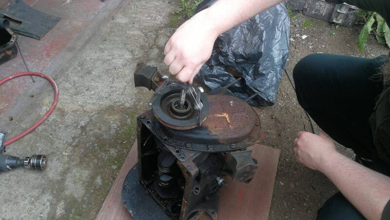

I failed to take any pictures today, but @320touring kept a decent record of today's proceedings...
Your average street furniture circa 1995.
Fucked engine
Flywheel tae fuck.
Crank pulley tae fuck.
Timing cover tae fuck (after wrestling with one stuck screw for ages)
Timing assembly tae fuck
Tensioner was fucked, chain was slack as buggery, teeth on the sprocket were fuuuuuuuuuuuuucked.
Backplate tae fuck, and the start of cleaning...
There was quite a lot of cleaning/wire brushing/sandblasting...
Not fucked engine
On the stand with aid of Dolomite backplate
Removal of head studs because some had damaged threads.
At this point @GingerNuttz had gone off with the cylinder head to the workbench and started porting it because he isn't building anything featuring the levels of casting flash BLMC considered acceptable...
Looking at two very different crank pulleys featuring two very different nuts and two very different oil seals... This was during a period of a lot of pondering and a lot of thinking about how we could actually get this engine to function in a rwd application...
(No, I'm not going to use that head gasket on the new engine, it was just a cushion for the head when in transit. I've a nice Payen one to go on!)
