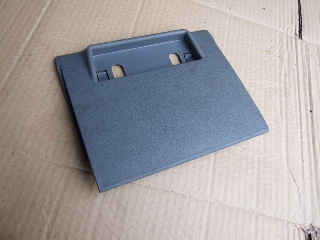

Is this the dash panel you need on the Acclaim? https://www.ebay.co.uk/itm/1981-1984-TRIUMPH-ACCLAIM-4-DOOR-FUSE-BOX-LID/302248071789

(I'm ignoring the fuse box cover for now, it's invisible unless you're under the dash and I is poor ;) )
