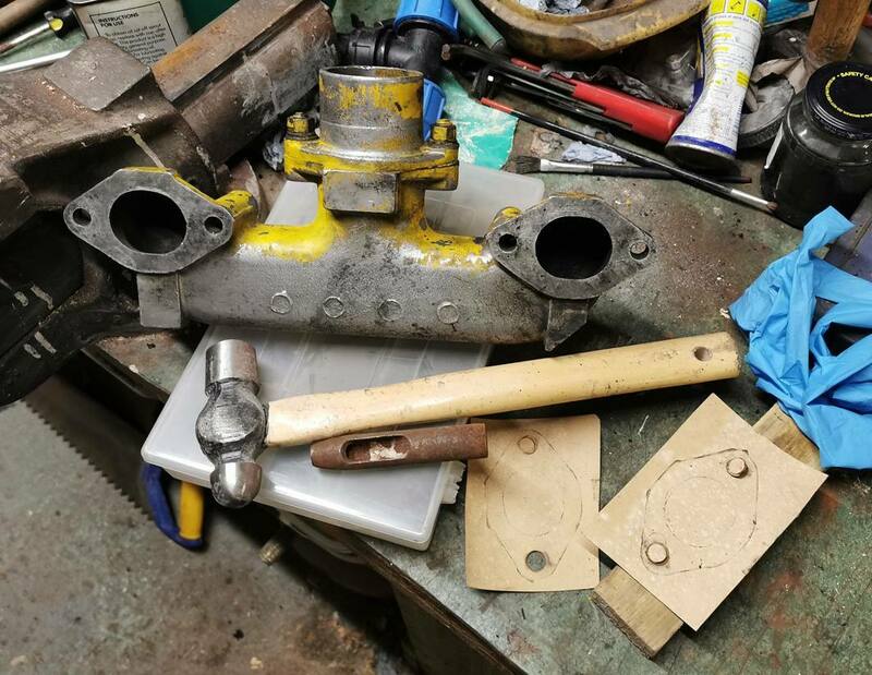

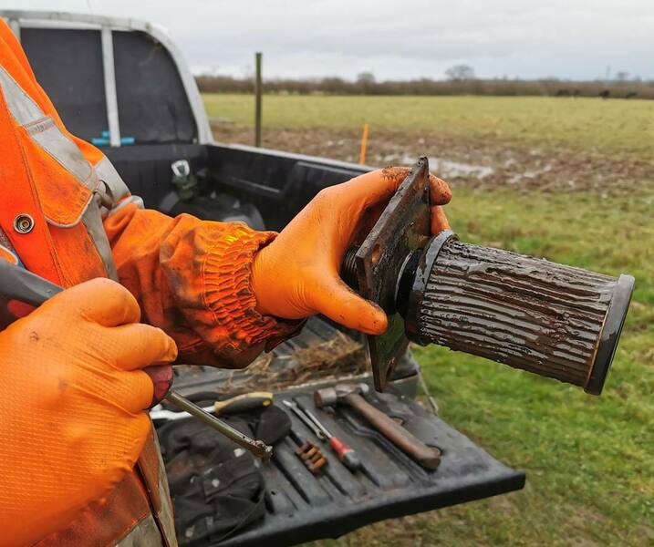

Six-cylinder Posted December 28, 2021 Author Posted December 28, 2021 What to do on a damp cool Bank Holiday Tuesday, fix your digger of course. A local agricultural engineer has done a few jobs in the past but has not been well and work stopped. Today he called me to say his son was about and the two of them could come and look at the power steering on our JCB. Mrs6C's internet research led her to believe the power steering oil strainer was blocked and she was spot on. It is a fine metal mesh and the muck was dug out with a screw driver and was given a through clean with petrol. It became very difficult to starter due to a mouse nest in the air filter being sucked into the inlet manifold. It had been cleaned out and I made inlet manifold gaskets for it. Today the inlet manifold and air cleaner were refitted. It started with ease with plenty of smoke but not the black clouds it made with a mouse's nest in the inlet. Now the steering works again, a Christmas miracle with horse power! My engineer says "I will be back"! but to service and do what he can for a worn out old machine. Dick Cheeseburger, LightBulbFun, Mrs6C and 19 others 22

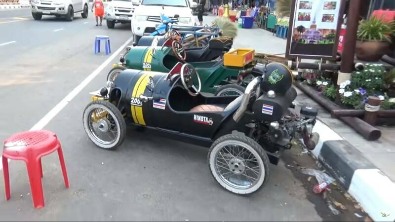

Six-cylinder Posted January 15, 2022 Author Posted January 15, 2022 I may have fallen out of a tree and banged my head, I want one of these! An oil drum car from Thailand seen on YouTube, we could build one at the FoD this summer, we have a spare 8HP engine! LightBulbFun, brownnova, Snake Charmer and 16 others 13 6
