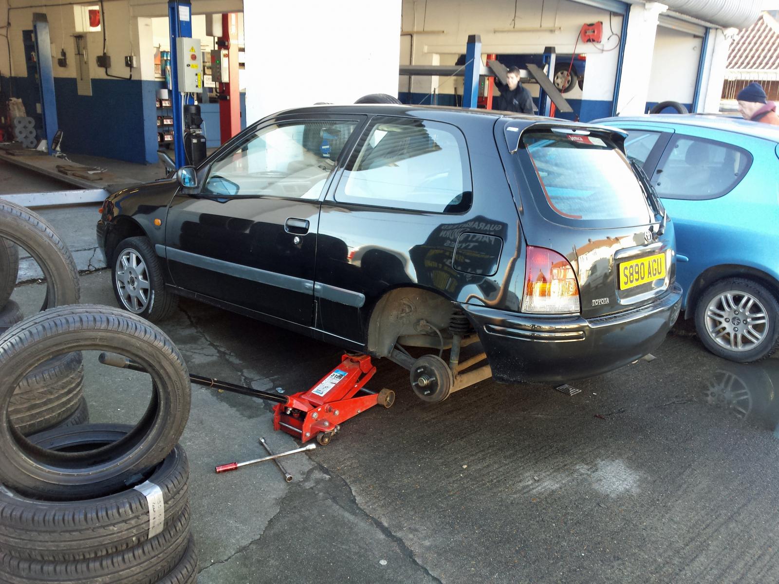

I had a bit of a mare with this today, one of the rear tyres was persisted so i popped to the local part worn tyre place, £30 for a new tyre fitted seemed fair plus an extra £30 to get the tracking laser checked.
So they started to remove the wheel and bang, the fucking locking wheel nut snapped. :(
(I really must fix that bumper) Who ever fitted the wheels last done them up so tight with a airgun that the garage had a hell of a job of removing them, in the end they managed to remove all my old locking nuts with a hammer, screwdriver and a breaker bar, I was pretty lucky really as they didn't charge me for the extra 1/2 hour it took to do the job.

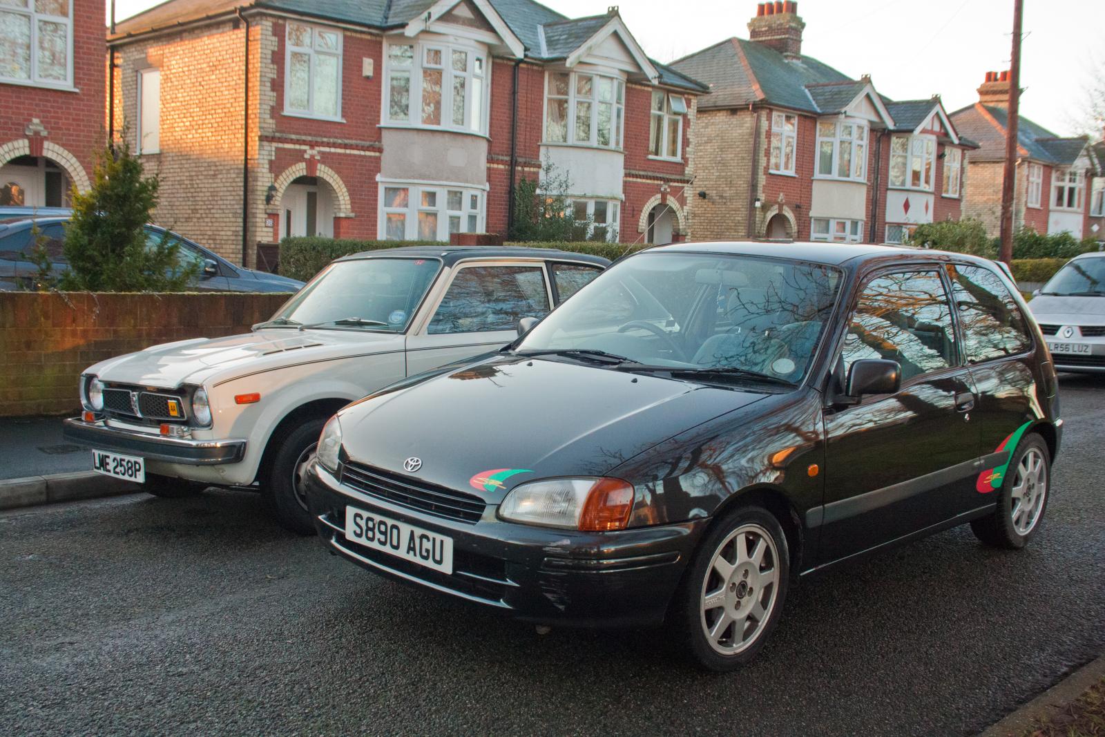

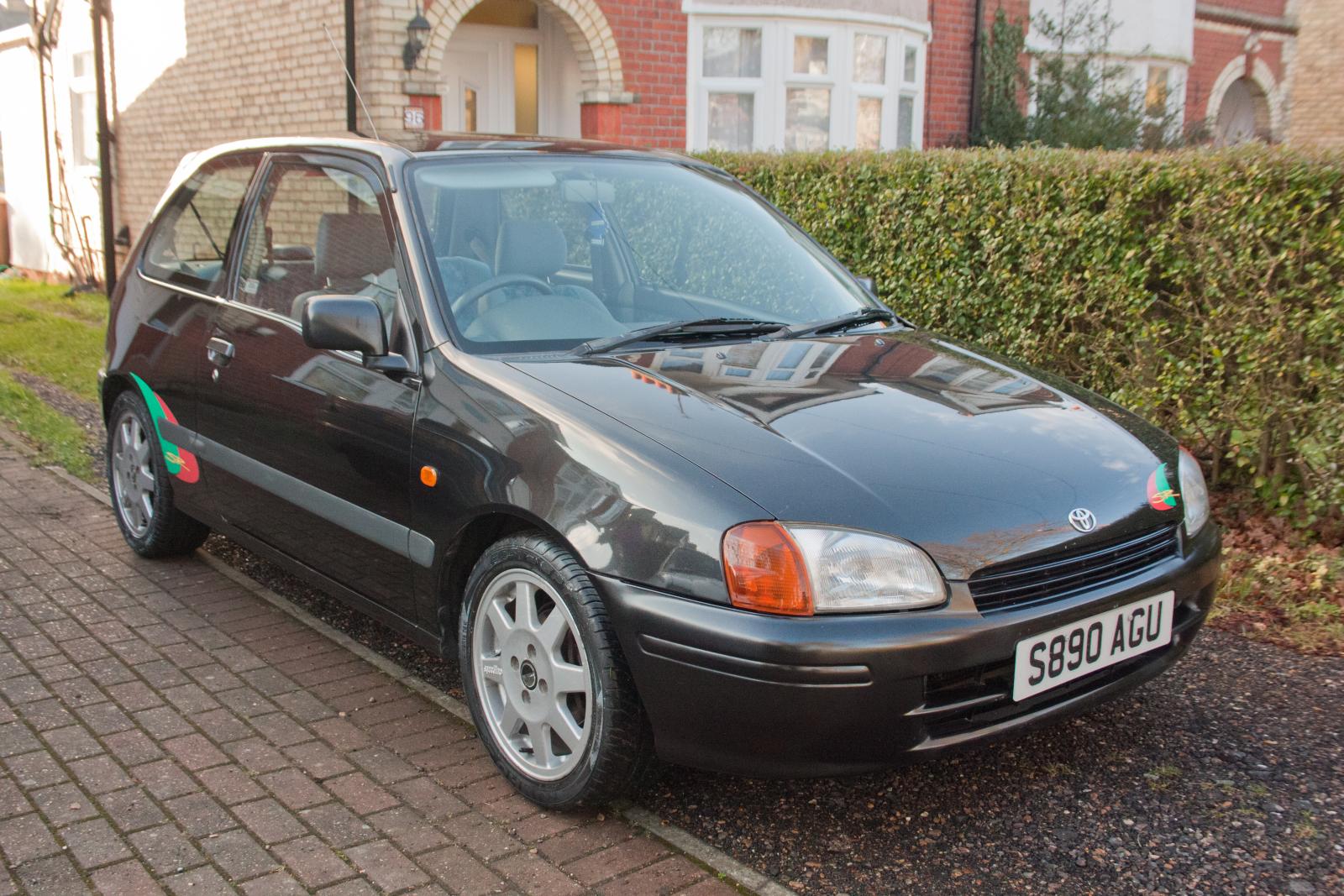

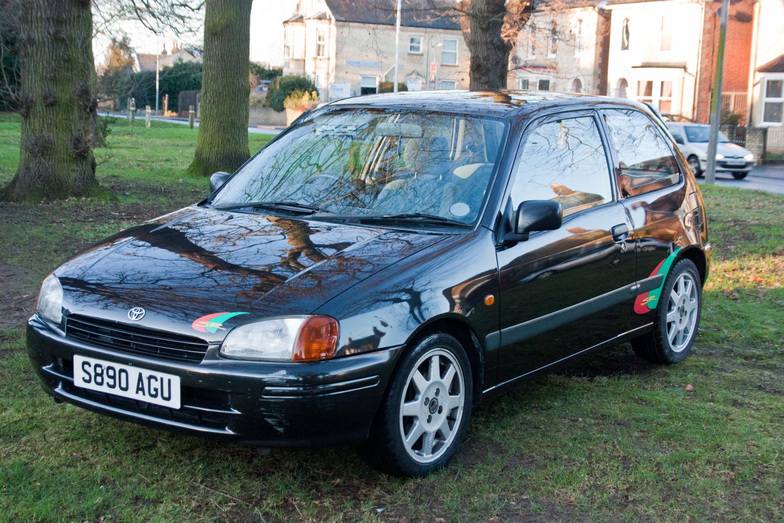

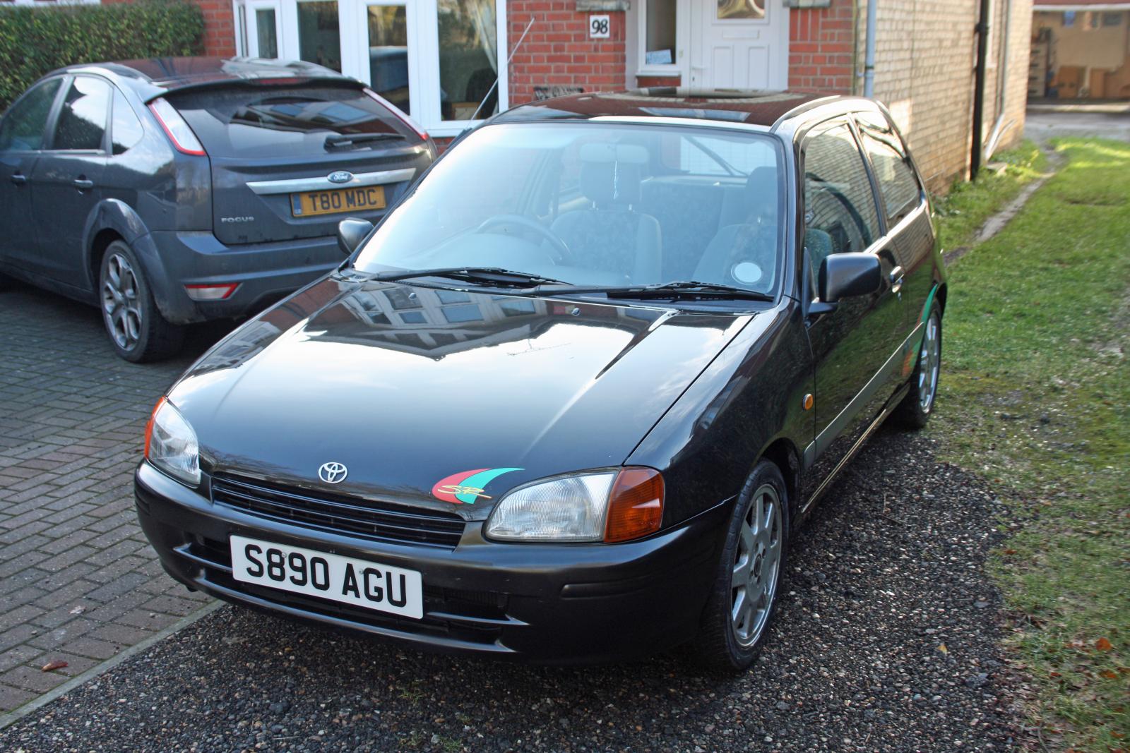

Namely the CD player of ebay, new wheel nuts and the SR sticker set, along with the paint and the fuel flap clip I'd already got I cracked on this morning getting the car sorted.
The clip was a easy fix and now the flap opens with the lever as it should, the CD player again was very easy to fit and has made the world of difference to the choonage, it picks up more stations, sounds much better and it's easier to use, £30 well spent.
The wheel nuts also went on fine too although the old one's were 21mm and the new one's 19mm so i had to faff about with a small bar, and lastly i polished it again with some black polish which is excellent at hiding scratches.

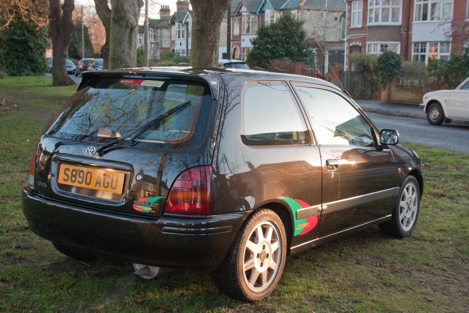

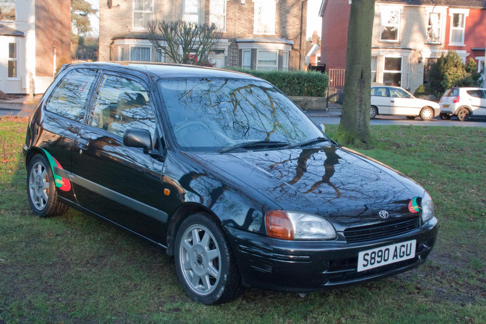

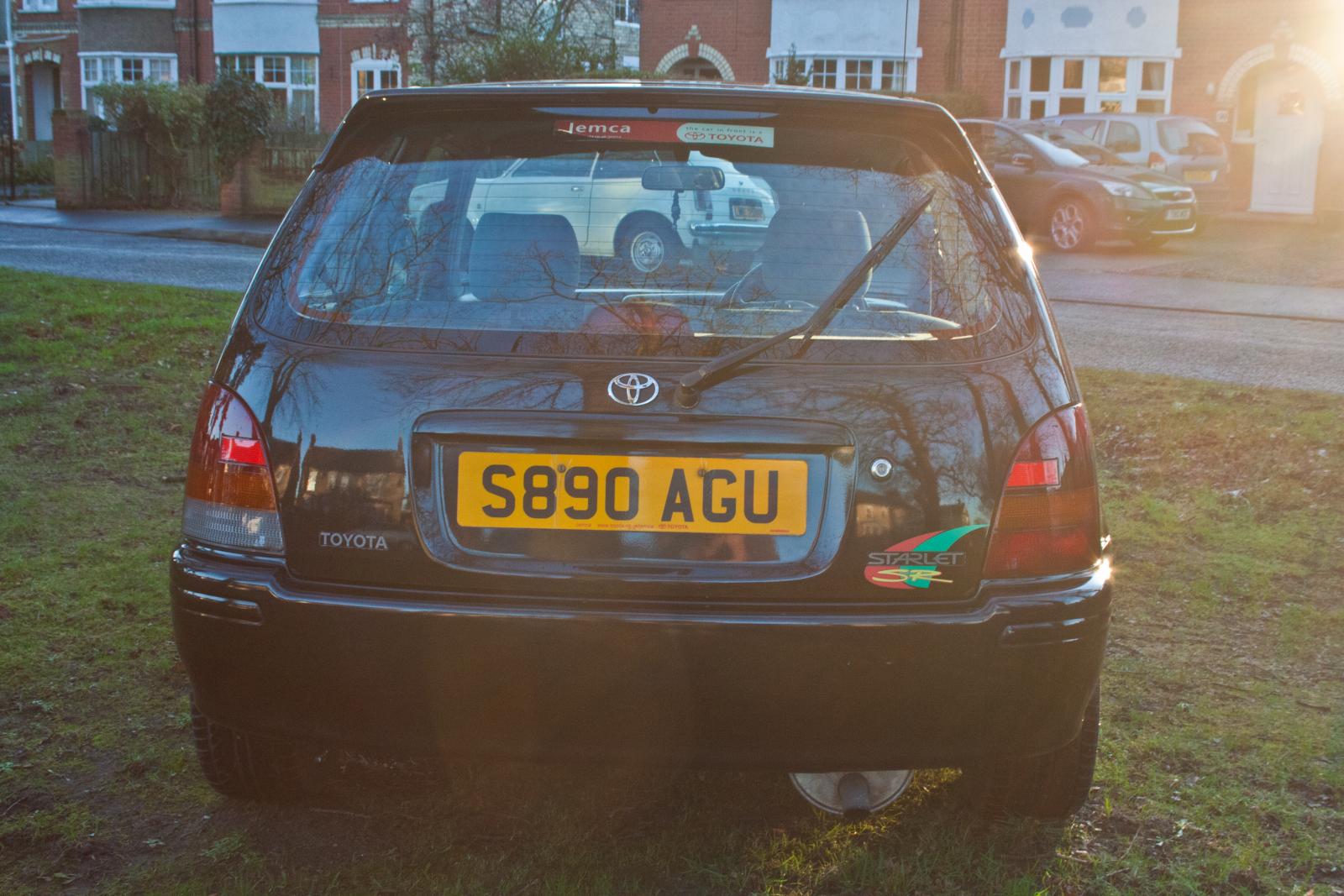

The problems all started when i fitted the sticker kit though, I'm useless at that sort of thing and should have got some help really, I managed to fit the front one ok although it didn't cover as much of the old paintwork line (where it was painted around the old sticker before) as i hoped but the boot one was easy, the worse was the side ones, I'm not sure if the stickers aren't quite the right size but i couldn't get them to fit, then one of them creased and it's now started unsticking, not good after spending £45 on them. :(

Bit late now though, They looks good i think mind you, what do you think?
Now I'm about to start work on painting the front bumper corners.
Looks great, the stickers make a surprising difference. Don't worry about the crease no-one will ever notice (other than us) and if they do then say someone on a forum you go on fitted them and made an arse of it.
Excellent work young man.
A hairdryer makes putting on stickers surprisingly easy, if you warm it now round the creases you should be able to smooth them away. If the edges start to peel away (you did remove all the old polish from the area first didn't you?) then use a bit of the wifes nail polish to re-stick them.
Smart. Don't worry about the stickers, the odd blemish or loose corner adds patina. If they had been the originals we would all be saying how well they had lasted and how well the car had been looked after. They honestly look like they have been there since day 1 Trig!
I think I'm just fussy with things like that, especially after spending so much on them. It's never going to be a show car and they will be covered in mud and shit soon anyway, bit annoying that they have already starting lifting on the corners and where I've been rubbing then the colour has started to come off. :(
I would not worry about the crease you will be the only one that will ever notice, I would suggest taking up heavy drinking as a way to forget though.
I think it looks ace with the stickers though, they really make a big difference to the car.
I would be annoyed too if I did it, especially as I would have made a much much bigger mess of it but it will soon blend in with the rest of the car.
If the stickers are lifting you can use some clear glue to stick them back down. The colour loss is just patina innit.....

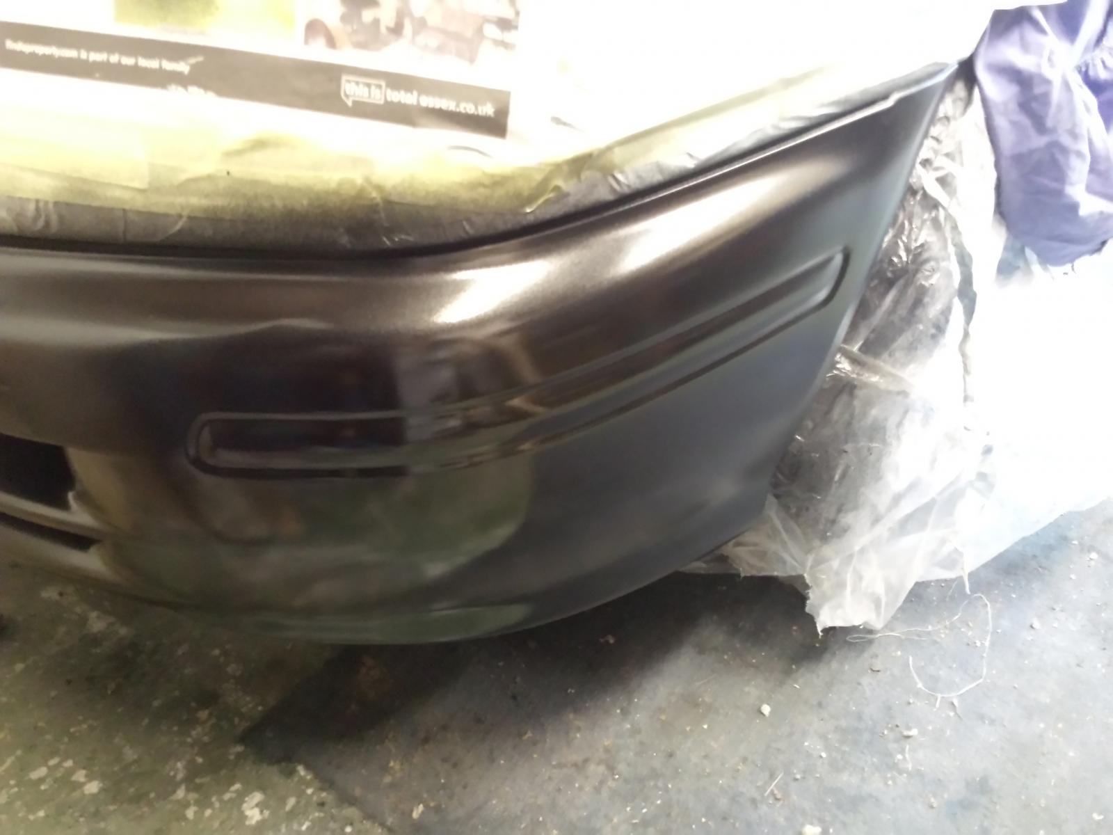

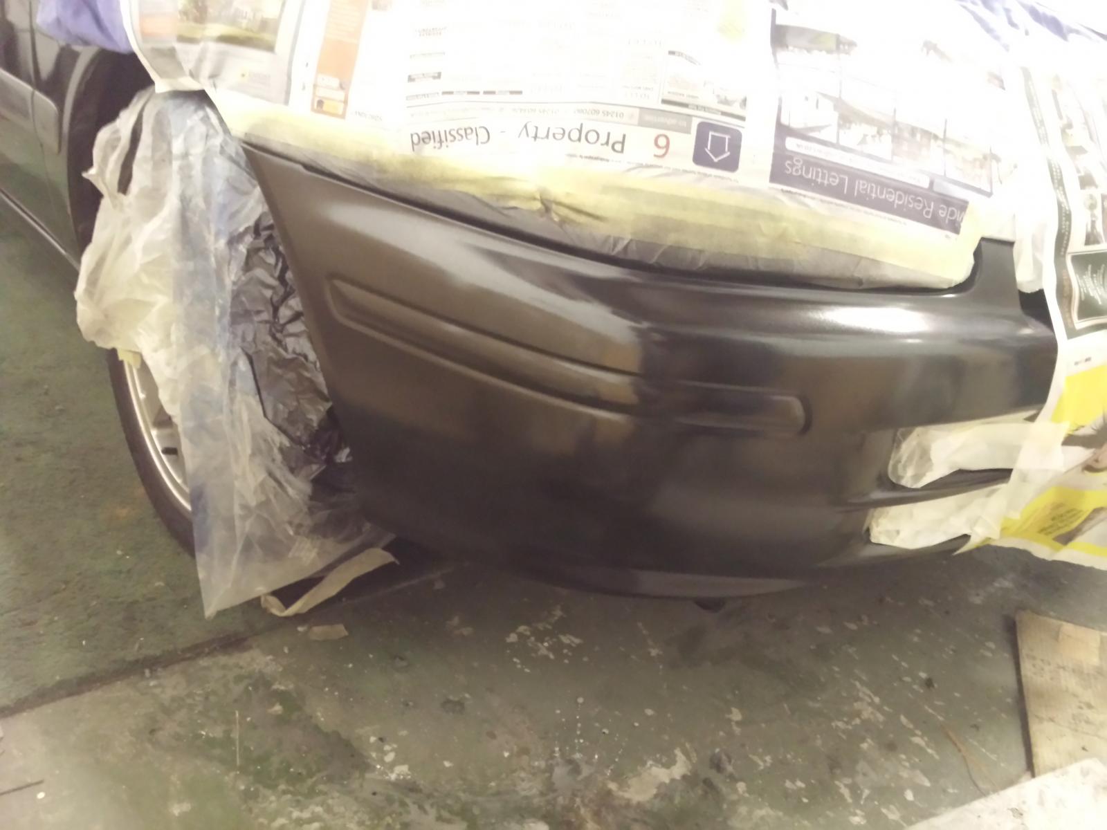

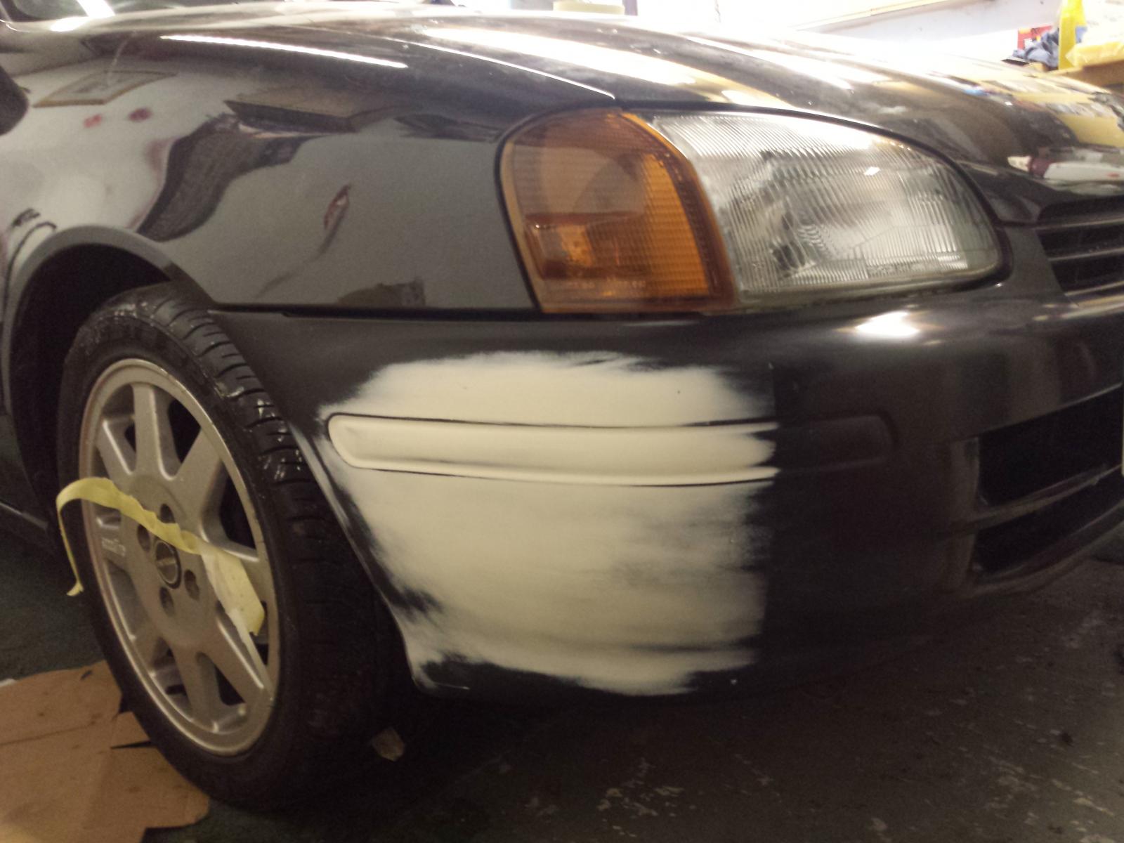

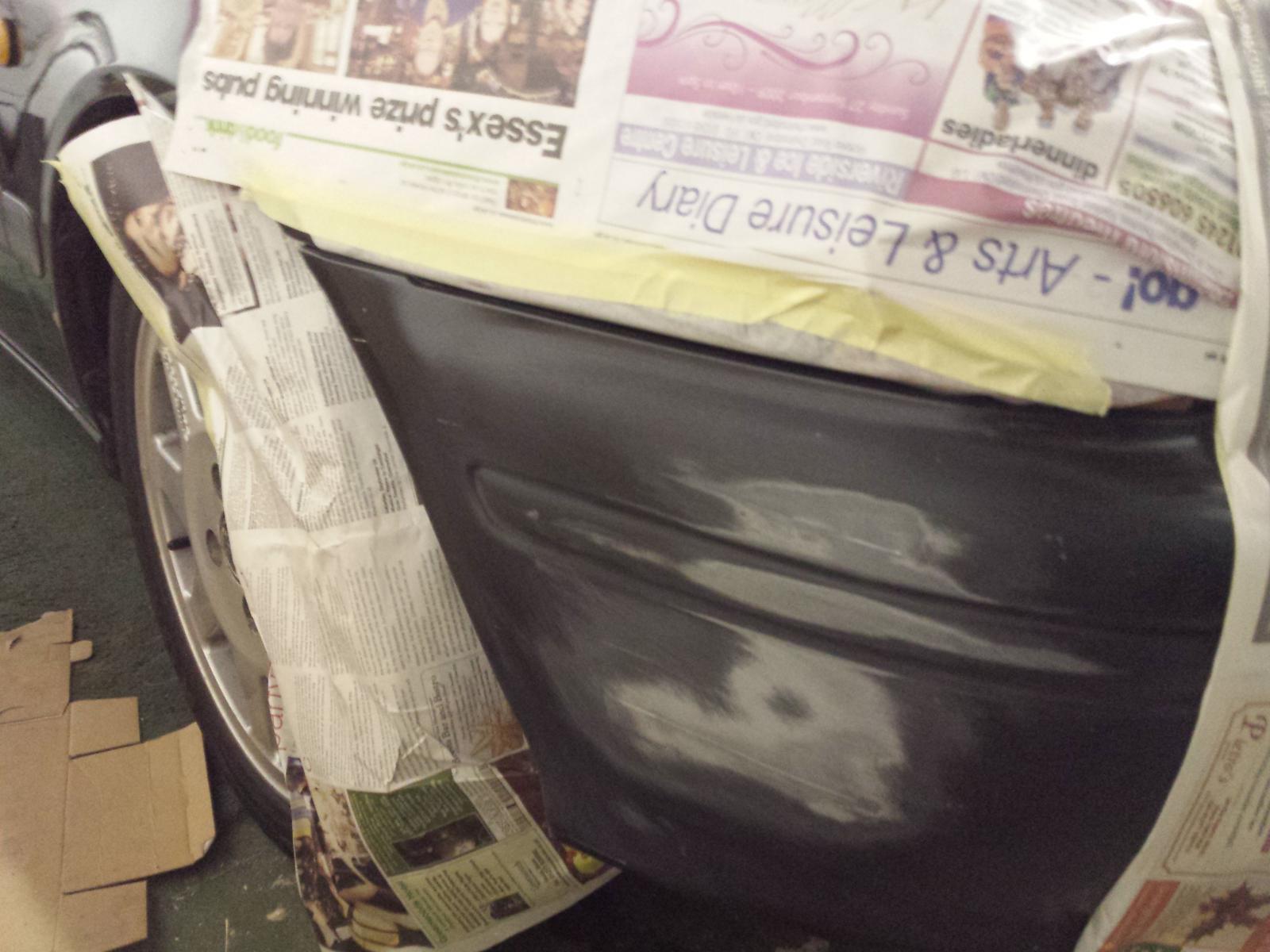

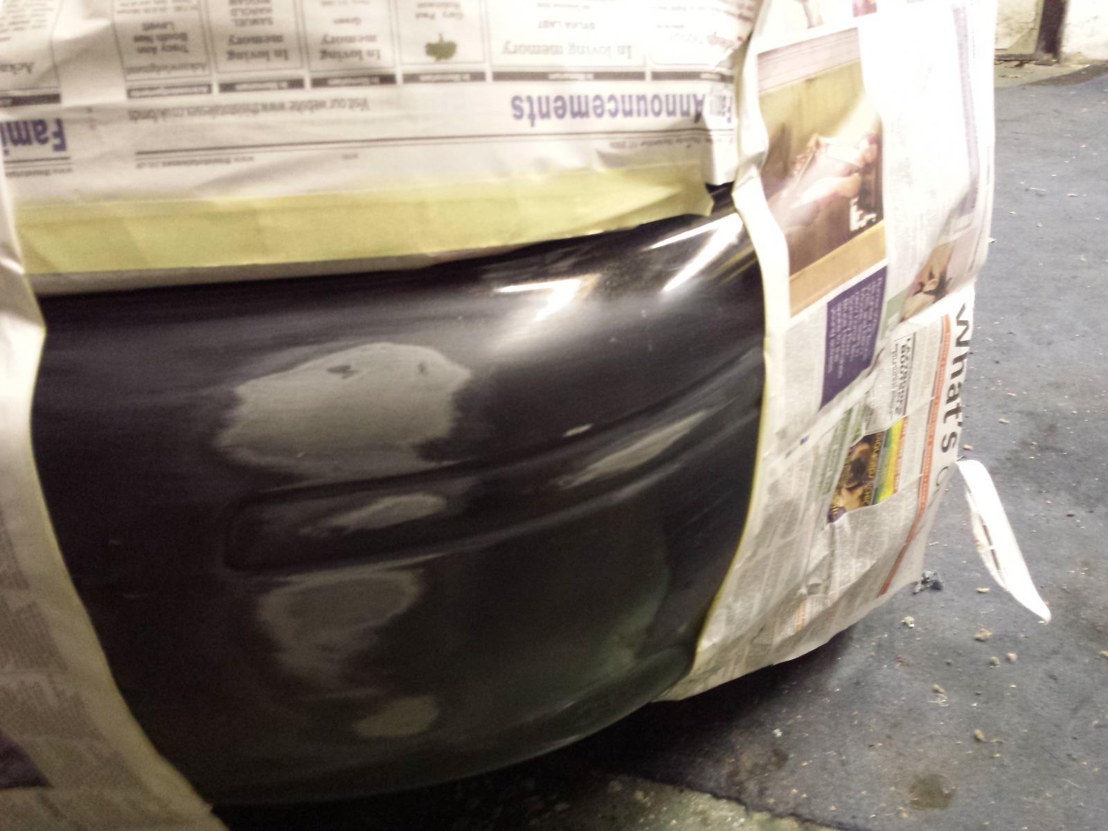

Back to my crappy car again, Now since i cleaned it the scratched front bumper corners have really been letting it down, I'd already bought a can of colour mixed paint for £11 from the local motorist shop and i had plenty sandpaper/primer/scotch pads etc in the garage so i attacked it yesterday evening and finished this morning.
I've got a electric DA which is excellent at jobs like this so i attacked it and filled the scraps with some filler.
Primed the corners with some plastic primer and flatted it back this morning.
A little bit later i had finished with the paint.
and Voila, a nicely painted bumper again, even the colour match is good. I'll give it a polish once it's hardened probably.

That looks lovely and the stickers really look great, I wouldn't worry about the odd crease, no-one's going to notice.  Those Starlets were the dullest things ever when new but they've aged quite nicely now, never seen a sporty one before but it seems to suit it.  Plus, being that generation of Toyota, it'll go on forever.
Excellent work Trigger, I think the stickers look ace, It is quite cathartic doing all those little jobs that really finish a motor off nicely. Makes me want to go and sort the bumpers on my MIL's Starlet.
Great job on the bumpers and the whole car looks excellent.  You've been at the wheels/tyres as welll haven't you, you little minx :)
