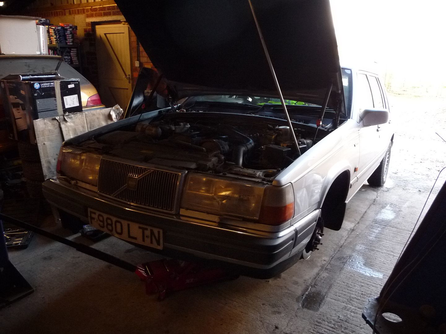

YO!!! Here at last are a few shots of my second shite acquisition in the space of a week!!!! I have shelled out a lot on 'shite costs' this month so am gonna have to tighten my shite belt soon otherise I'm gonna have loads of cars and nowt to eat.
Anyway I drove this thing back from London to Nantwich with an overnight stop in Oxford. I calculate a fuel consumption of about 32mpg so not brilliant!!!

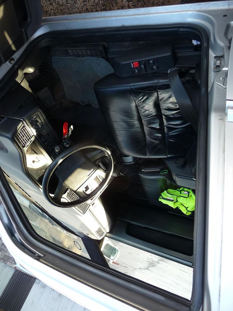

The interior is BLACK. everything is black inside, including the headlining, which is hanging down at the back and needs re-upholstering, possible with something a little less sombre. However its very comfortable with excellent visibility and a nice driving position. Also the stereo is amazing. Its got a JVC head unit with the most ridiculous scrolling graphics display I have ever seen, it makes the sony 'ZAP' stereos look like the pinnacle of efficient industrial design by comparison. it scrolls all sorts of ridiculous shite on the screen about what it can do, while its playing the radio or CD or whatever. Despite looking shite it sounds flipping brilliant, I dont know if these cars have any amlipfiers in them or more than 4 speakers or what but its easily the best-sounding music system I've ever had in a car, really clear with deep bass and capable of going louder than i would ever want to hear without it sounding shite! I was grinning like a twat listengin to the old Daft Punk CD as I was driving about yesterday.

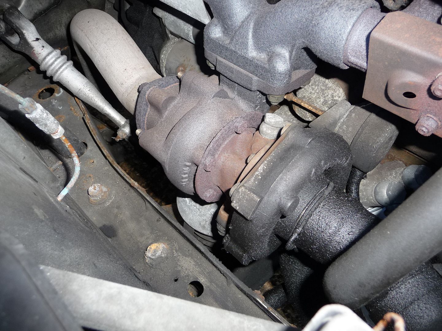

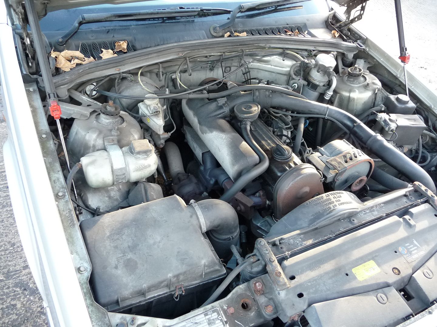

The engine is the old Volkswagen lorry engine, its flipping ace this. About 130bhp or something, the turbo is a fairly massive thing:
its got 135,000 on the clock so probably about 25% through its service life I'm guessing. Sounds bob on, the guy said it had had its timing belt done about 5 years ago but had probably done less than 8000 miles since. I will probably see about changing it cos thats still pretty old and if I ever come to sell it will need to be done. It started up almost immediately depsite a fairly hard frost on Sat morning so I guess the heater plugs are still doing the biz OK.

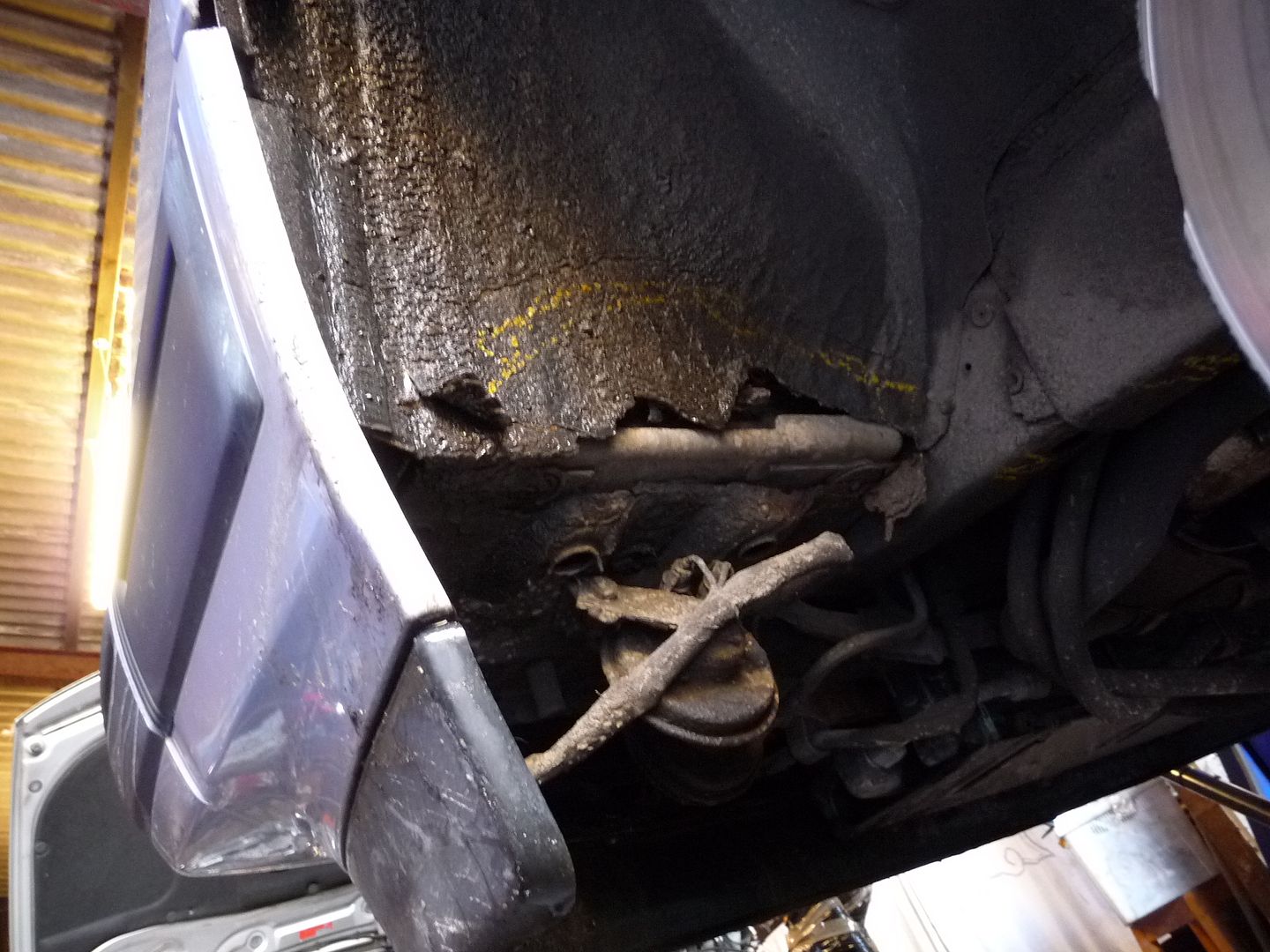

Anyway it was up for sale cos it needed some welding for the MOT and the people who had it decided it was time for Albert to move on. They showed me some photos of the rust and it looked fairly unpleasant but I couldnt really make out what I was looking at, so yesterday I pulled it into the workshop for a proper look.
Apparently the battery tray was quite bad.
Hmm, yes I see the problem here
Also there are a couple of holes under the floor:
The floor pan is holed on both sides just above the outrigger thing. This looks like a pretty easy fix though the seats and carpets will no doubt have to come out to access it properly, then it can be repaired properly from the top.
I inspected everywhere else and found no other problems, no more rot, split driveshaft boots, rusty tubes and pipes etc. Well actually i did find a diesel pipe that was a bit rusty so I cleaned it up and put a load of copper grease on it, thats about it though. Good!
I spent the rest of the day fixing the battery tray. Chopped out all the grot and welded in a new bit.
Not the neatest repair i've ever done but its OK and all the rotten stuff is gone, will seam-sealer and paint it today hopefully and cross that off the list.

I like it. Does it have an intercooler? 130bhp Is about the same as what a similiarly aged 525 td had so not too shabby.

120bhp and 177lb-ft of torque I believe. I didn't get around to it on my D24TICs, but they respond really well to a bit of pump tuning apparently. The guides linked here are for a Peugeot 405 TD but apply to almost any old diesel with a Bosch VE pump.
http://www.aussiefrogs.com/forum/peugeot-forum/85227-peugeot-405-diesel-tuning-autospeed.html
