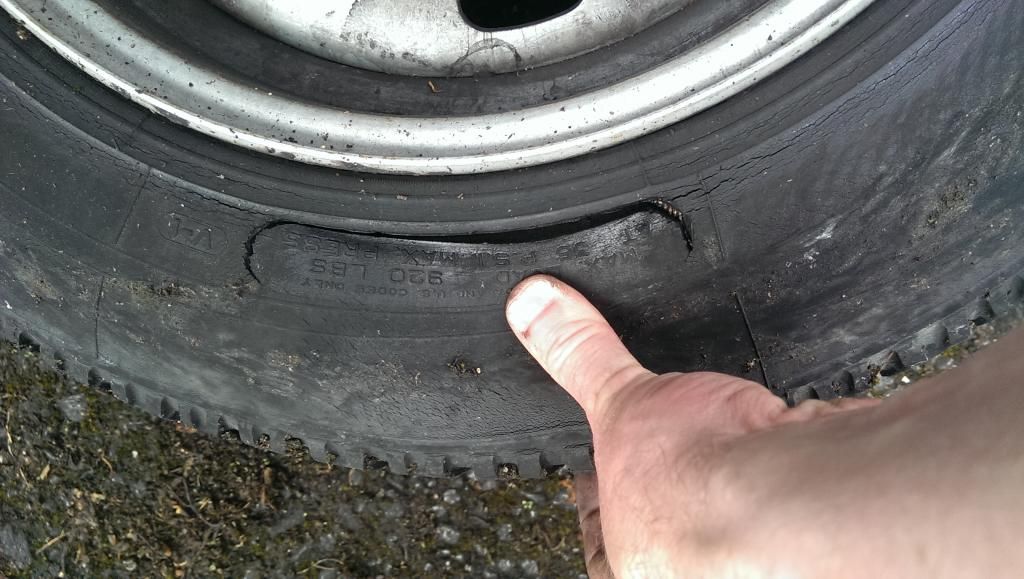

HillmanImp Posted September 26, 2014 Posted September 26, 2014 This happened to the Visa recently: Stuck a load of SATSUMA DANGEROUS TOYS AND TYRES COMPANY boots on it the next day that are so hard they can cut a diamond, as I needed the car for work that day but am replacing them with some winter tyres shortly and will get some good ones for the summer. Why piss around with things like Tyres and brakes ?They are the most important things on a car. I like to be able to steer too. Christine and cobblers 2
