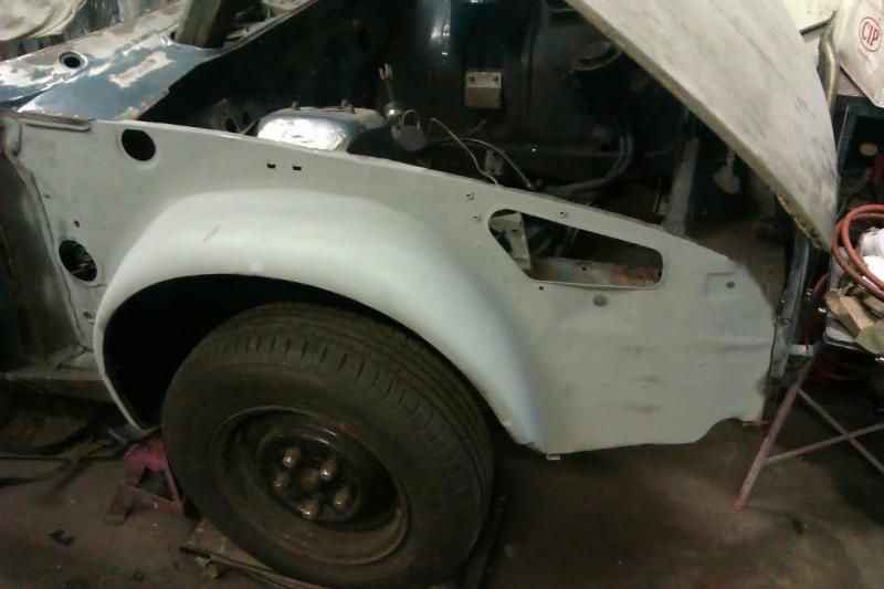

More XXX weld action.

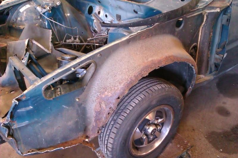

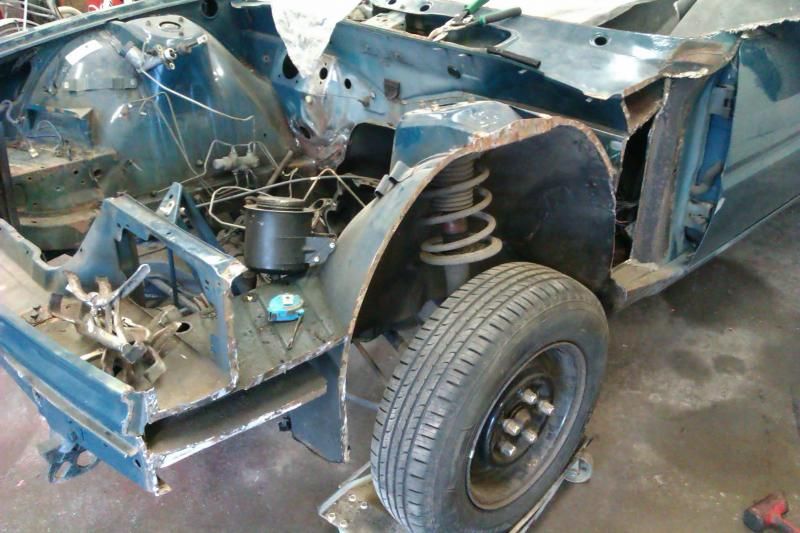

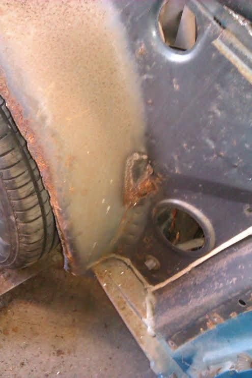

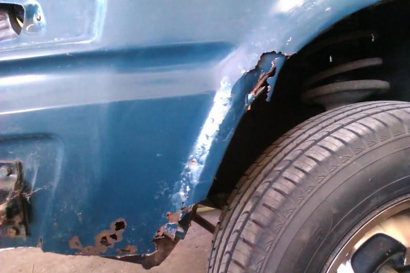

Both front wings had been repaired* in the past and were well past their best.
Inner wings weren't much better.
I rebuilt the edge of the inner wheel arch on mine with zintec - painstaking but worth it as I got the steel for fook all.
Use plenty of seam sealer between the inner and outer wheel arch otherwise you will be repeating the exercise in the near future.

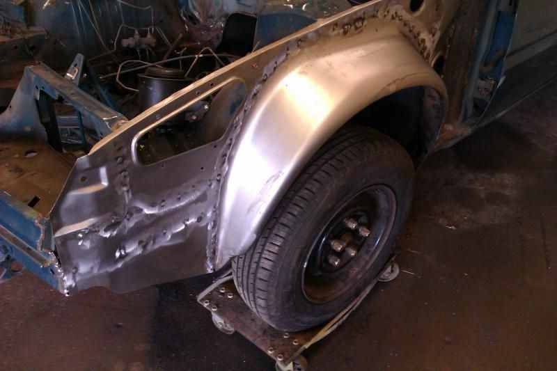

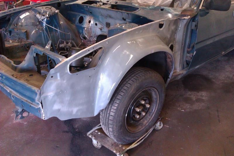

Car is now ready for paint.
Some surprises under the paint..
Stripped, repaired, zinc sprayed and two-pack epoxy primer applied.
That's some considerable improvement on the crusty, waterlogged SD1 I last saw on Phil's driveway, nice work!  I do hope the yellow velour is being kept.
When you see the wings stripped off like that you can see why they rusted out so badly.
Nice work. Are those panels available or have you had to make them?
You can still get everything for them from rim end bros. I guy local to be me replaced every panel on his other than the roof from Rimmers stock. It cost him mega$$$
