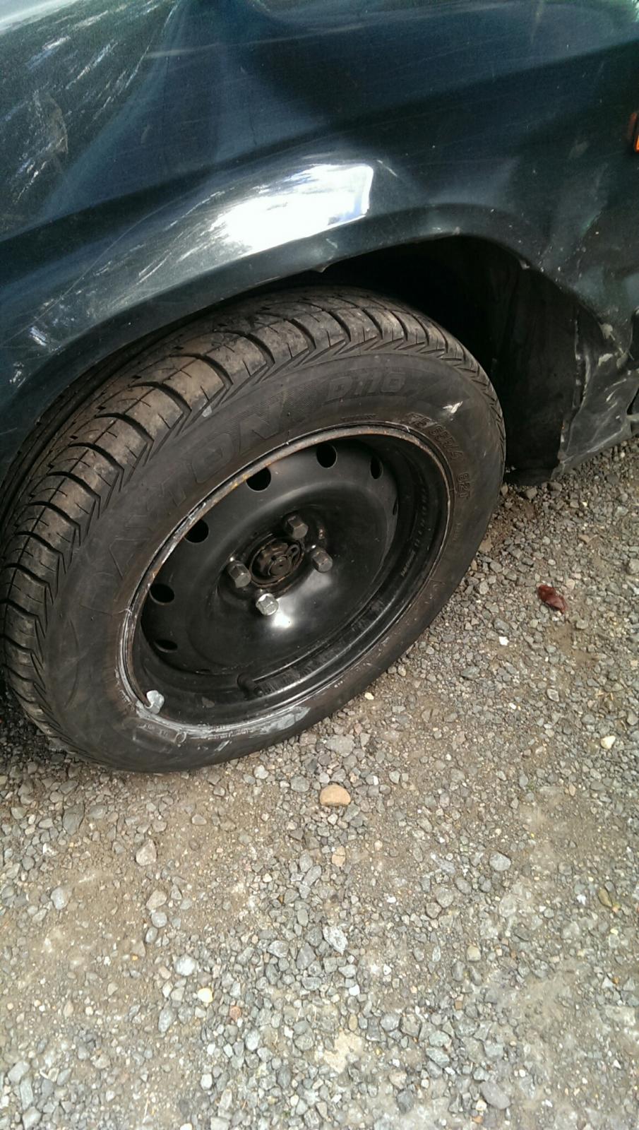

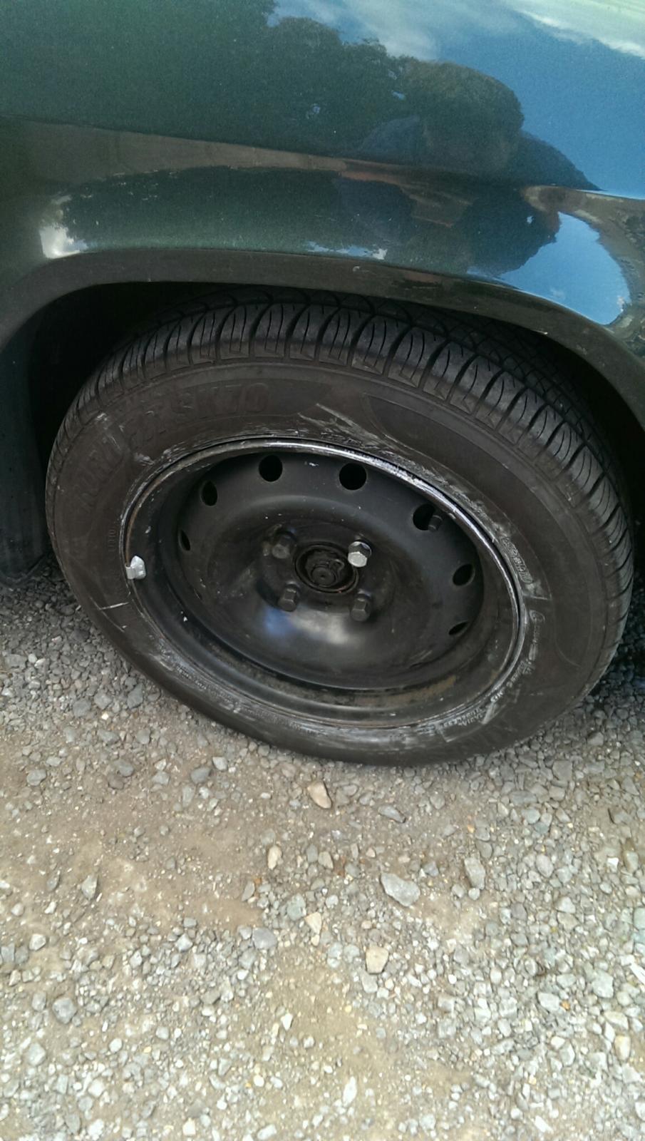

So just now I went over to our local used tyre emporium and got these fitted to the wheels Vantman kindly sent me
They didnt have any 185/65/15s, so fitted
Which he said would be fine still

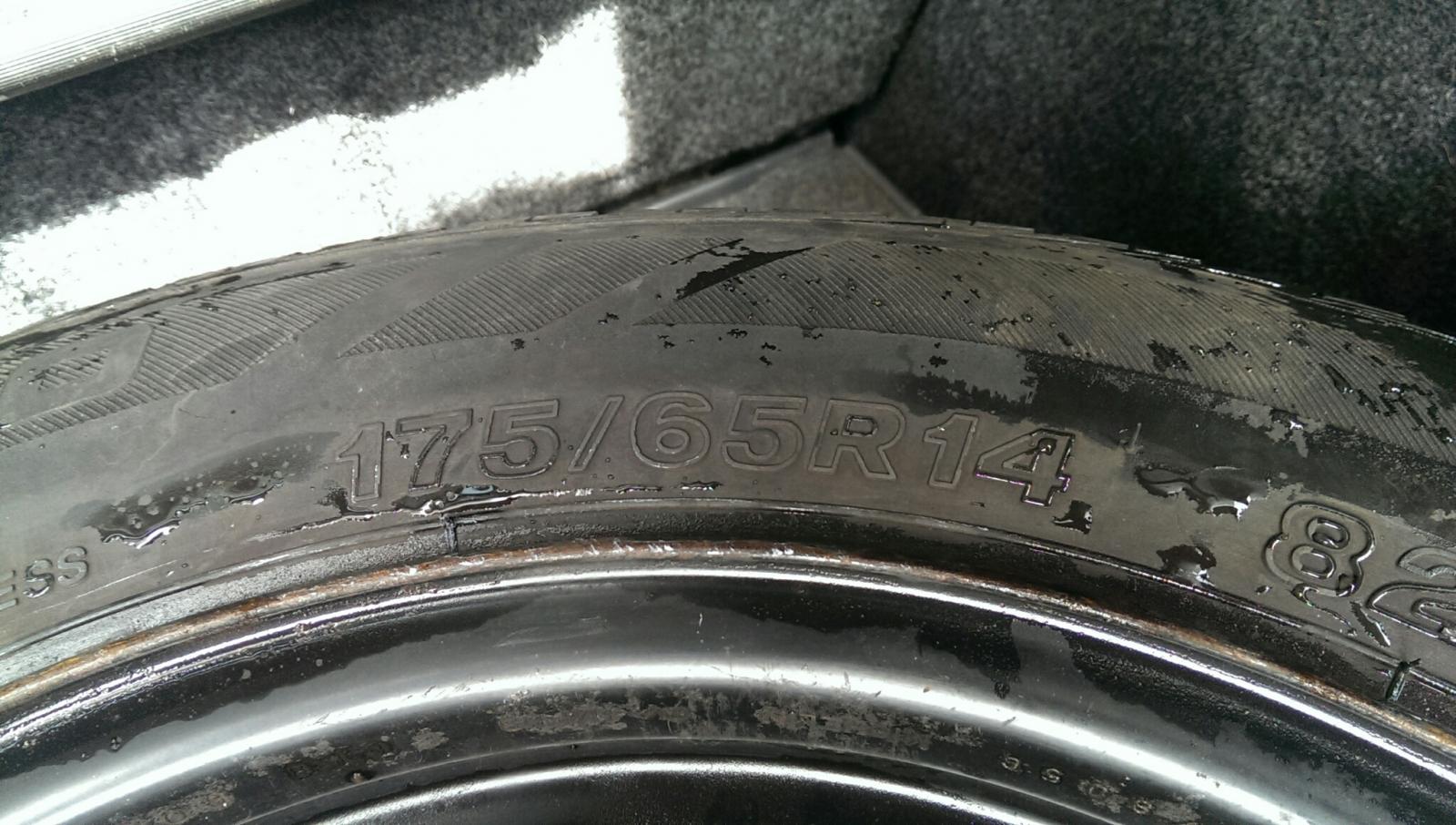

This is whats on there atm
Should be ok shouldn't it? Will find out on Sunday when I get round to fitting the wheels to the car, and some other tasks! As a bonus both tyres are makes I've never heard of!
I then went to asda and bought some baccy, a heinz bacon and bean slice and a mcdonalds milkshake with the leftover money. Good old Dyson! (was a freebie too)
175/65/14 and 185/60/14 have very similar diameters, you'll be fine.
I can't make out the brands on those pictures, I hope you kept the Autoshite tradition by buying the finest* Chinese remoulds available !

One thing worth noting is that the tyres on each end of an axle must be the same sizes.
Yep that's sorted, the tyre chap found a matching pair.

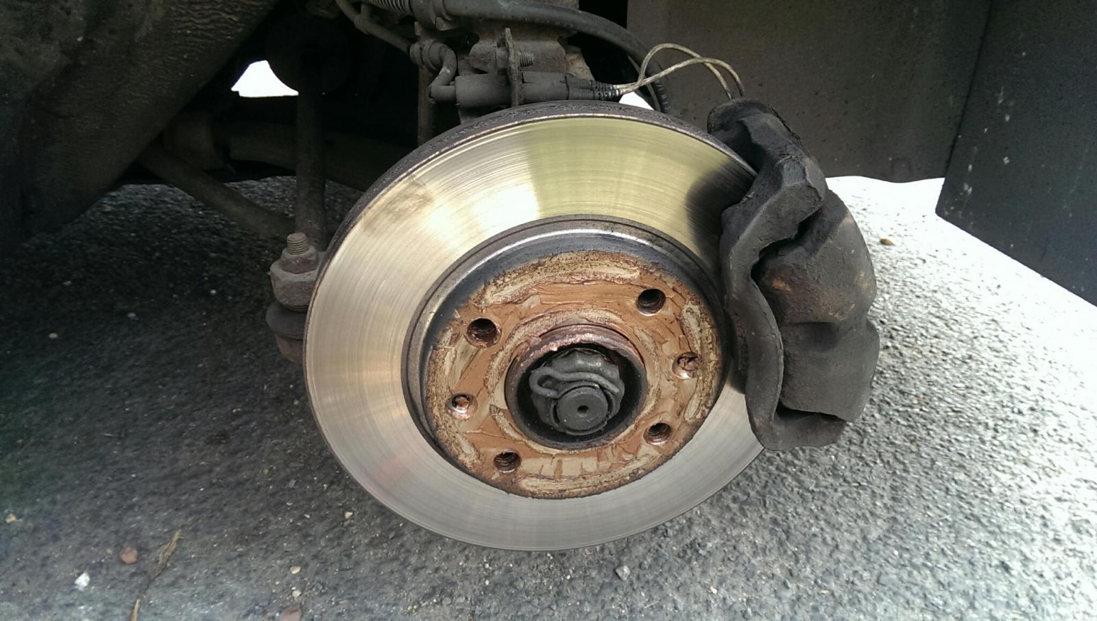

Well, I got the wheels and tyres on on Sunday morning (just got round to wanging the pics up! Had a good check of the new discs too, wearing in nicely
Smeared the coppaslip that was left around, didnt put any fresh on

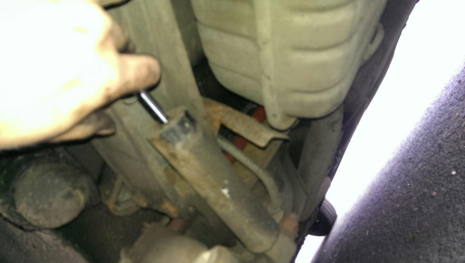

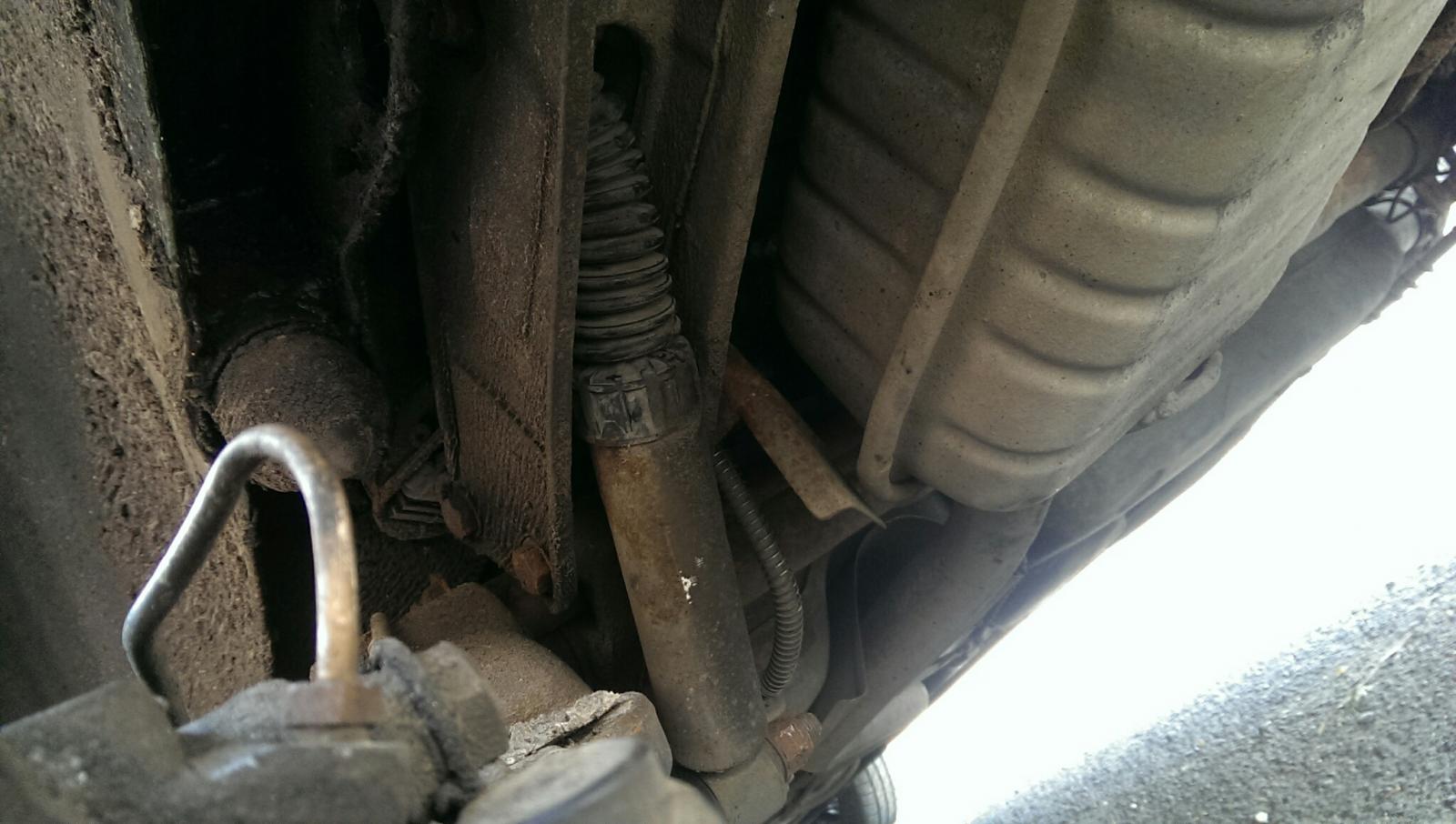

Had a look at the rear shocks too whilst the rear wheel was off
Looks pretty fucked. Compounded too by lack of access to the mounting bolts, and the fact that they look like originals that haven't been touched in years. Any tips to get them off?
Reading the HBOL it says to remove the backbox to get better access to the bolts on the passenger side. Looking at all the snot and bits of metal holding it together that might be tricky, and it's leak free at the moment so loathed to do it. If I do, I feel a new backbox coming on and just chopping it off as close as possible to the end
Looking at the shocks, under the dust cover they dont look too horrific
So I elected to leave it alone for now and see if it crops up at MOT time, unless anyone can offer advice on removal? I'll need a new socket anyway, it's 21mm, I have a 20 and 22, which will round it off if I try any harder than I did!

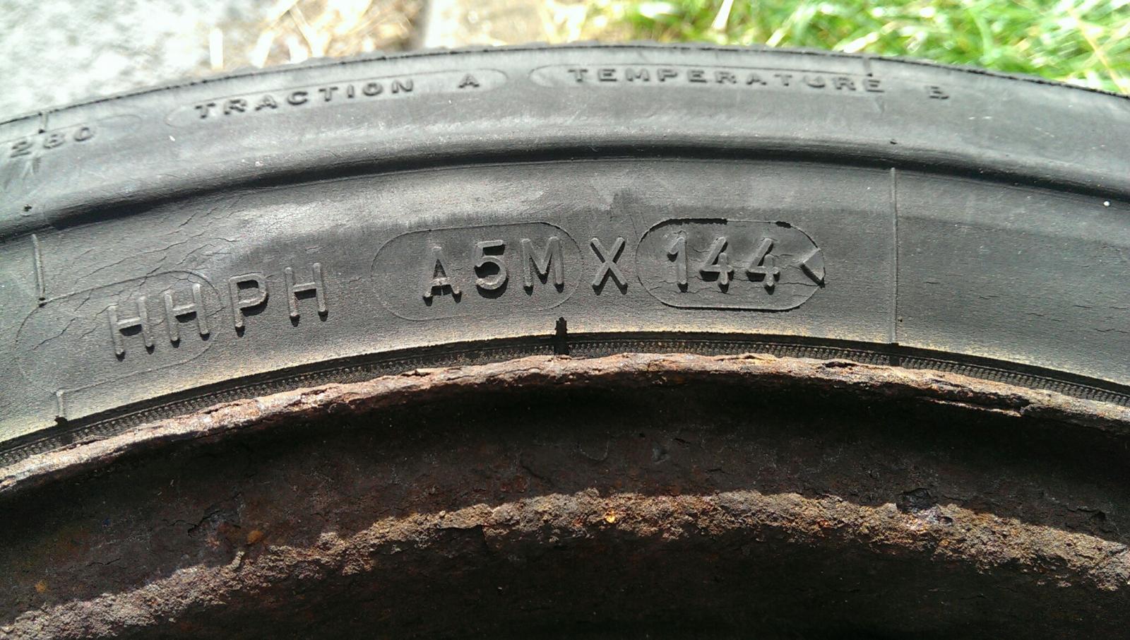

Looks quite old, have I taken a picture of the date code or something else?

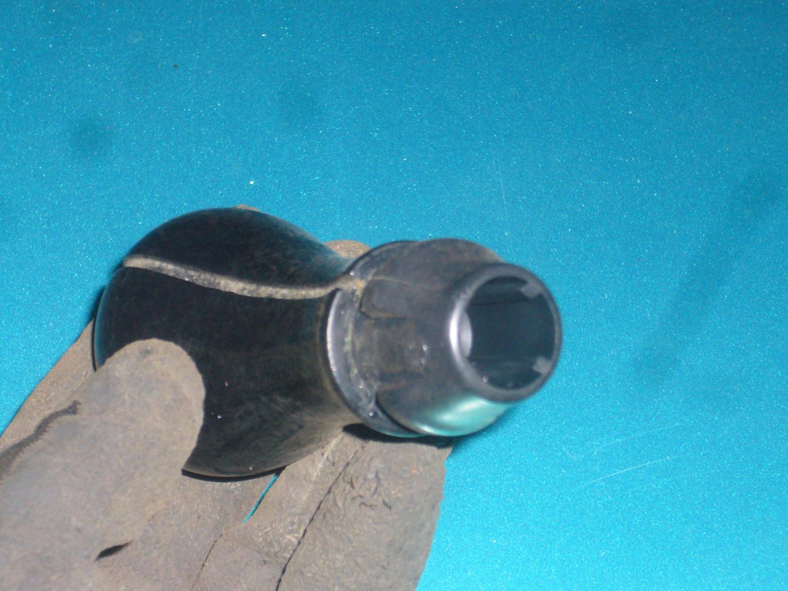

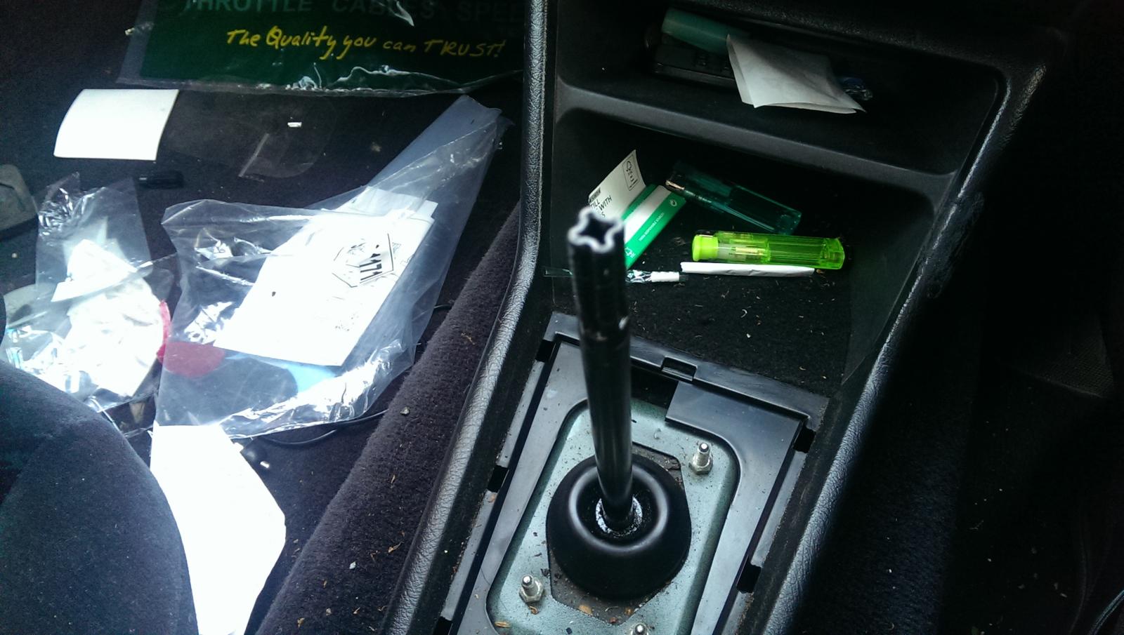

Beko, I can't find where you said you'd mullered your knob and pulled it off (fnarr).
Anyway, I have a well-worn 306 gear knob here if you want it. Please check your gear stick is the same first though - the round tube is crimped into a sort of square, or X-shaped profile at the top, and the knob slides firmly over it (not threaded).
If you want it FOC, PM me your address and I can post it tomorrow morning when I go into town.
I'll check mine tomorrow morning! Does it just yank off? Hope it doesn't make a mess...
I thought yours almost fell off already? Or did I dream the whole thing?
Yes, it just lifted off, the 306 only put up minimal resistance. Not like the Volvo auto one... that needed me crouching on the front seats astride the console, yanking with all my weedy strength*.
The outer skin fell apart, the inner core and mounting bit stayed on!
The collar looks similar from the outside though!
