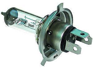

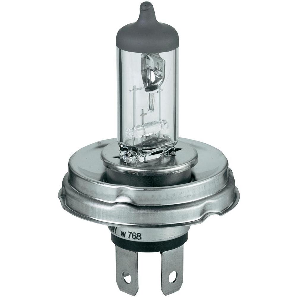

Rather than use the original golf ball type halogens
A 410?
I used a variant that has the same mounting bracket but is more like an H4 in shape.
plain H4
It ups the light output considerably without looking overly modern, a sensible modernisation. I've already forgotten what the bulb type is called.
410 conversion?
Quite easy to get the orientation out on those old round based things as the lug is so tiny.
That's exactly the ones, Eddie.  I didn't even bother with alignment as I'll be fitting new headlights but you're right, the lugs are not the easiest thing to get in the right place, especially since the slot on the Renault is bigger due to having the left/right adjuster as part of it to rotate the bulb accordingly.
