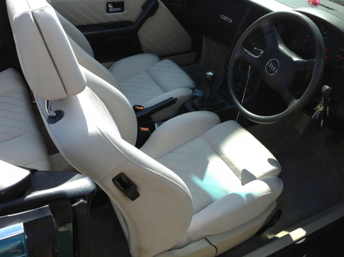

In true Autoshite fashion I always go for the cheapest option and have found that pound land carpet foam cleaner brings the seats up lovely it works as well as the autoglym interior foam cleaner the only difference is it doesn't smell as nice as the autoglym product.post-9282-0-12385200-1388363230_thumb.jpg
These seats were brown before I used the poundshop foam cleaner but now that the seats are back looking like new I keep them covered up as I find that the seagulls love shiteing on my car interior when the roof is down.
