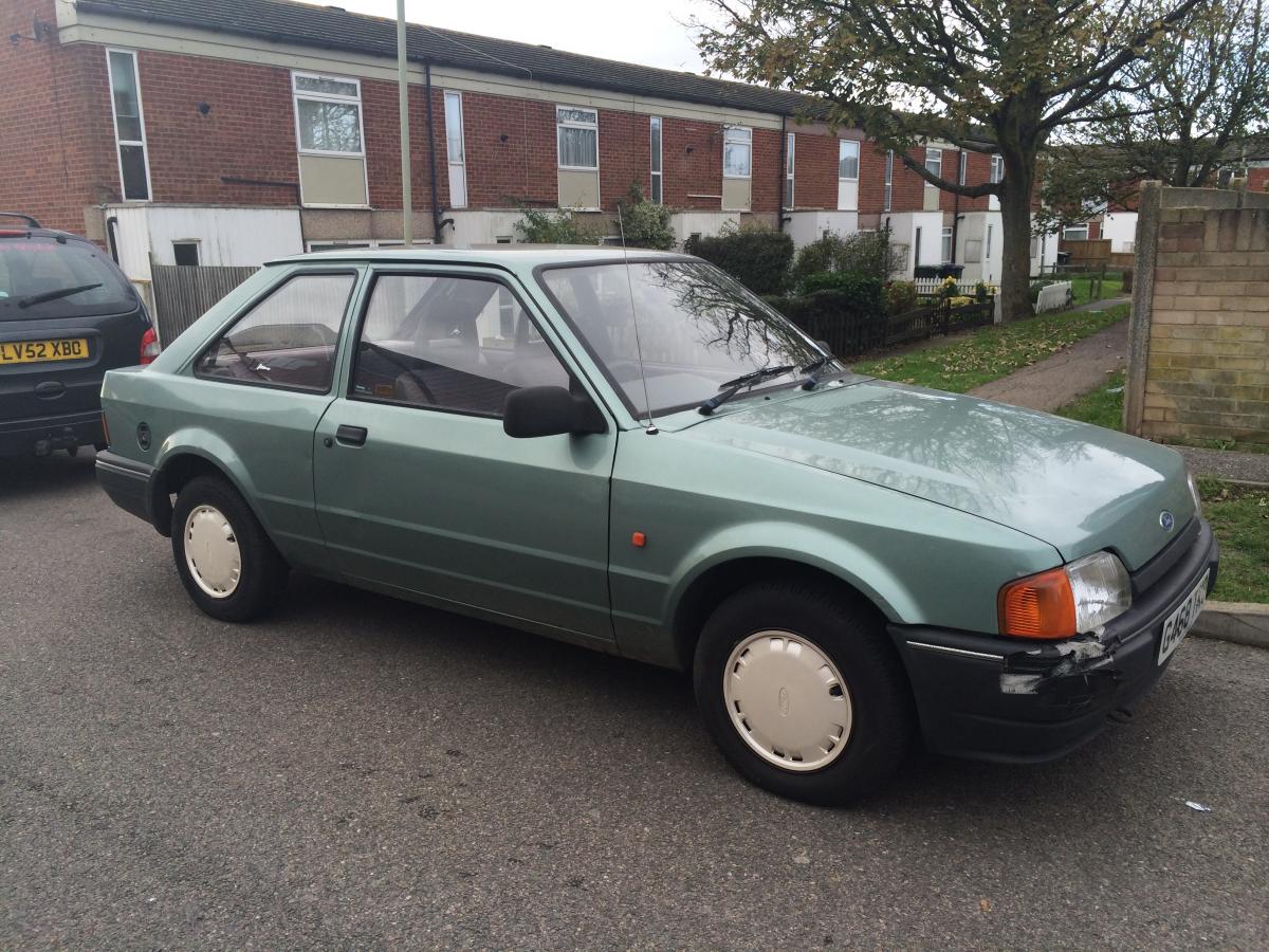

So I bought a bit of autoshite
Basically needed a cheap run around
, almost bought a Saxo vtr... But why on earth would I do that when I could get a manky old escort
2 previous owners, first had it for years from new, even have the original bill of sale.. Next owner was a learner driver
It's a bit knackered.. The 1.1 hcs engine is shagged.. I mean it is unless some autoshiter has a genius bodge?

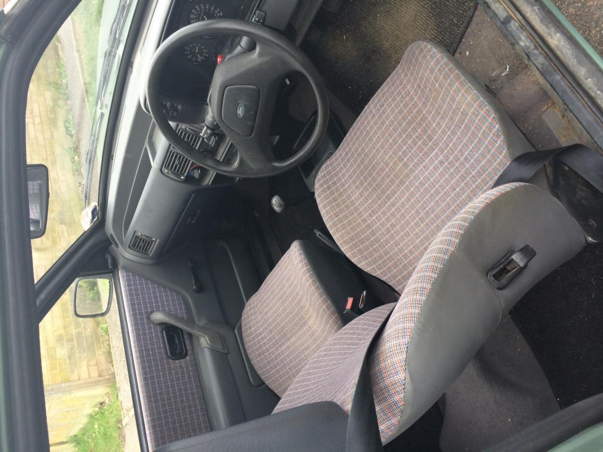

It's completely standard even down to the factory radio (yes radio without tape)
Maybe in the future I might think about zetecs or cvh engines but for now I just need to be mobile
So I have bought a 1300 endura-e ka engine for £40 and will be enlisting the help of my mate who is a whizz with fords to give me a hand..
From what I have managed to research the engine should be a straight fit physically, my only fear is that I keep reading the inlet manifold won't fit (but this seems to be relating to the single point injection system, not the carb) so we will see, and see if we can bodge

I guess you didn't play the vid then. It's shat its bottom end out by the sound of it
You see it sounds like it is coming from the top, but then again I suppose it's a short engine, so it could be the bottom end
I thought it was e top, but it's actually running nicely on all 4
That looks pretty tidy! I think thats a 'bonus' special. At least thats what my dad retuerned from the ford dealers with that same year sporting the same wheeltrims and interior.
So you've literally blown your Bonus?
These valencia things always were noisy on the top end..but that sounds like a much more "meatier" knocking than just valvegear. combine that with the oil light on at low revs and its gotta be knackered bottom end bearings.
Do you think it's fixable quickly on my back on the floor?
Like shells, socket set and go?
If the bearings have said goodnight,think of all the nice bits floating about inside the engine waiting to 'bed in' the new bearings ! Might be lucky,but won't be a long term fix; quicker to drop the replacement engine in .
Great color btw
You're going to struggle to make "one out of two" on the engine front. Different generations completely. Try to find an older engine.

A Bonus 90 with its original wheeltrims, class in a glass. I'd suggest an engine from an early mk3 Fester, pre 1993. As AR said the Ka engine is too different. Albeit with the same roots. For a start its single point injection.
I was hoping to fit the carb system to it... Or bike carbs?
Will it really not fit? I think the ka engine is mpi
I have seen threads where people have put it in fiestas
From what I read the hcs engine and the endura-e are pretty similar.. I think the Valencia is slightly different?
What about if I put the hcs head on the endura?
There's 20 years and two redesigns between the Valencia and the Endura-E. Physically mounting it in the car should be straightforward but making it run with a carb and dizzy is likely to require lots of fabrication.
Having said that, unless one of us has actually done the job, it's all internet postulation. I suggest you get out there and compare the two units side-to-side : is the inlet port spacing the same ? is there a blanked-out hole for a dizzy in the Endura block ? I suspect the answer to both questions will be 'no', but you may be lucky.

Yes, that engine is toast, which amazes me, someone must have ran it out of oil.
