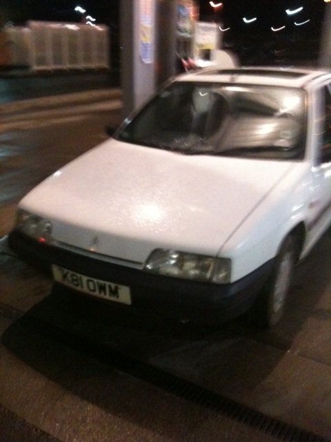

It feels like a Bx. It smells like a BX. It drives like a BX. It looks like a BX
(inside) and like a BX some of the dashboard lights don't work. But it isn't a BX.
BOOM!
(I don't know why it appears I stopped at a Nike sponsored petrol station, but get over it and stuff.)
1.9 TURBO diesel with veg oil friendly pump. Spotted it on GumDiseaseTree, MOT and tax until April next year, £300. There was just one picture (of the front of the car!) and naff all else, so some coercion was required for the money shot. Bingo, correct fuel pump confirmed by the AS massive, so I did the usual, put an offer* in prior to seeing it, and whizzed up there (Liverpool) this evening. half arsed test drive round the estate the seller lived on, all seemed well and we shook hands. The seller was a lovely lady who was sad to see it go, she'd been given a nearly new Fiesta.
Stopped for fuel, followed my son and his sat nav then it was time to give it some beans. F*ck me, this thing doesn't half go, albeit leaving comically huge plumes of black smoke in it's wake.
I can definitely confirm it does 70mph, and I would hazard a guess it will reach 110mph and a bit more besides probably. I wouldn't go that fast myself, so I'm just guessing. It's very much BX-ish inside and it pulls probably slightly better than I remember the TD BXs doing.
Handling is about what you'd expect, I think it probably has 175/65 section tyres, it absolutely doesn't like roundabouts at fair speed, something my 306 (which is slower of course) excels at. The plan had been to bum it for the engine, but after the drive home I think I'll keep it as it is and just lob some wider wheels/lower profile tyres on. Sadly I had to actually put diesel in it to get it back, the idea of which sickens me to the core, so it'll be veg oil ahoy later this week.
Big test is if I can fit bikes in the back, but I seem to recall these are pretty much a 306 underneath so I reckon it'll be fine. The journey to work is going to be immense once I sort some wider wheels out!
*£250!
