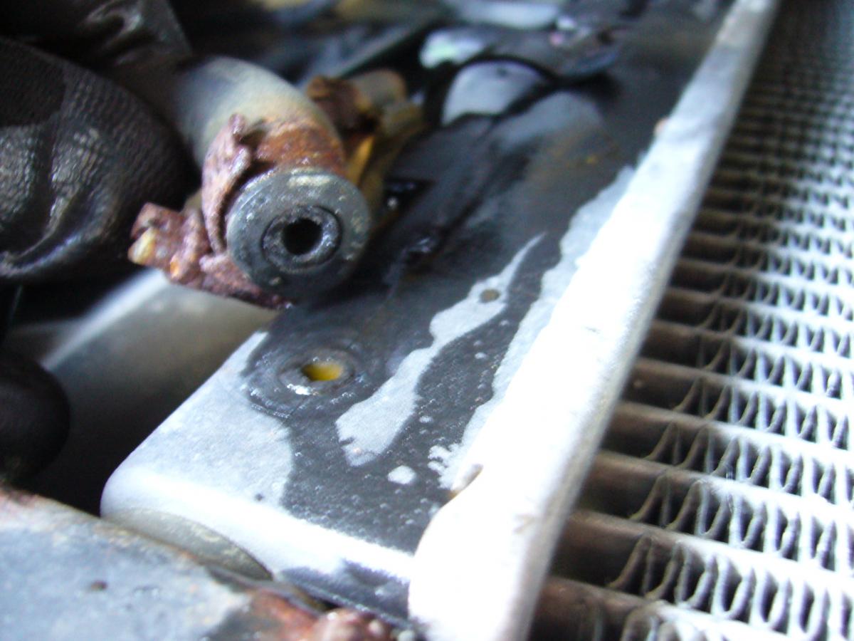

KruJoe Posted March 15, 2014 Posted March 15, 2014 Don't bin that washer bottle just yet. I once did this to a Rover radiator:Find a dis-used wheel rim, and wiggle out one of these, lube will help:Widen out the hole in the bottle to the same size as the one in the rim (I used a soldering iron), and pull the valve stem through from the inside (I went in through the top hose hole).This fix* lasted for the life of the car, it held pressure well. Next bodge: You can try this for nowt, (I know I would if I had no cash) find some suitable strapping (old leather belt / webbing / seatbelt / that metal strapping with holes in) and a nut, bolt and two washers. Drill a hole near the broken end, and bolt on your re-enforcement nice and tight, from one side, around the broken end, to the other side. Five minute fix for free, worth a try? Squire_Dawson, fordperv and mat_the_cat 3
vulgalour Posted March 15, 2014 Author Posted March 15, 2014 Washer bottle - repaired with some all-purpose glue which has sealed the crack that was leaking. Bottle no longer leaks. Cost of repair: £free Washer pump - ordered a replacement for £2.95, it'll be here next week. Kept the old pump so I can fit a pipe connector into the body of the pump through the original hole and then seal it with some sealant of some sort. Cost of repair: £0.50p probably Rebound strap - I'm not bothering to repair these. If they're so badly made that not even the full weight of the suspension arm they're supposed to prevent from moving too much pulls straight through like that I'd rather just bin them. I've got a contact that has some with proper strengthening in and who has had the same issue with new versions, they're £8 each posted and for the hassle of trying to make the current ones good again I'd rather just pay the money in this instance. Top tip on the rad repair. I'm fairly sure my brother did the same thing to a rad on one of his cars, but I can't remember if he repaired it or bought a fresh rad, this would have been a useful bit of thinking at the time, I'm sure, and I have filed it in the Useful Stuff box at the back of my brain for future reference.
