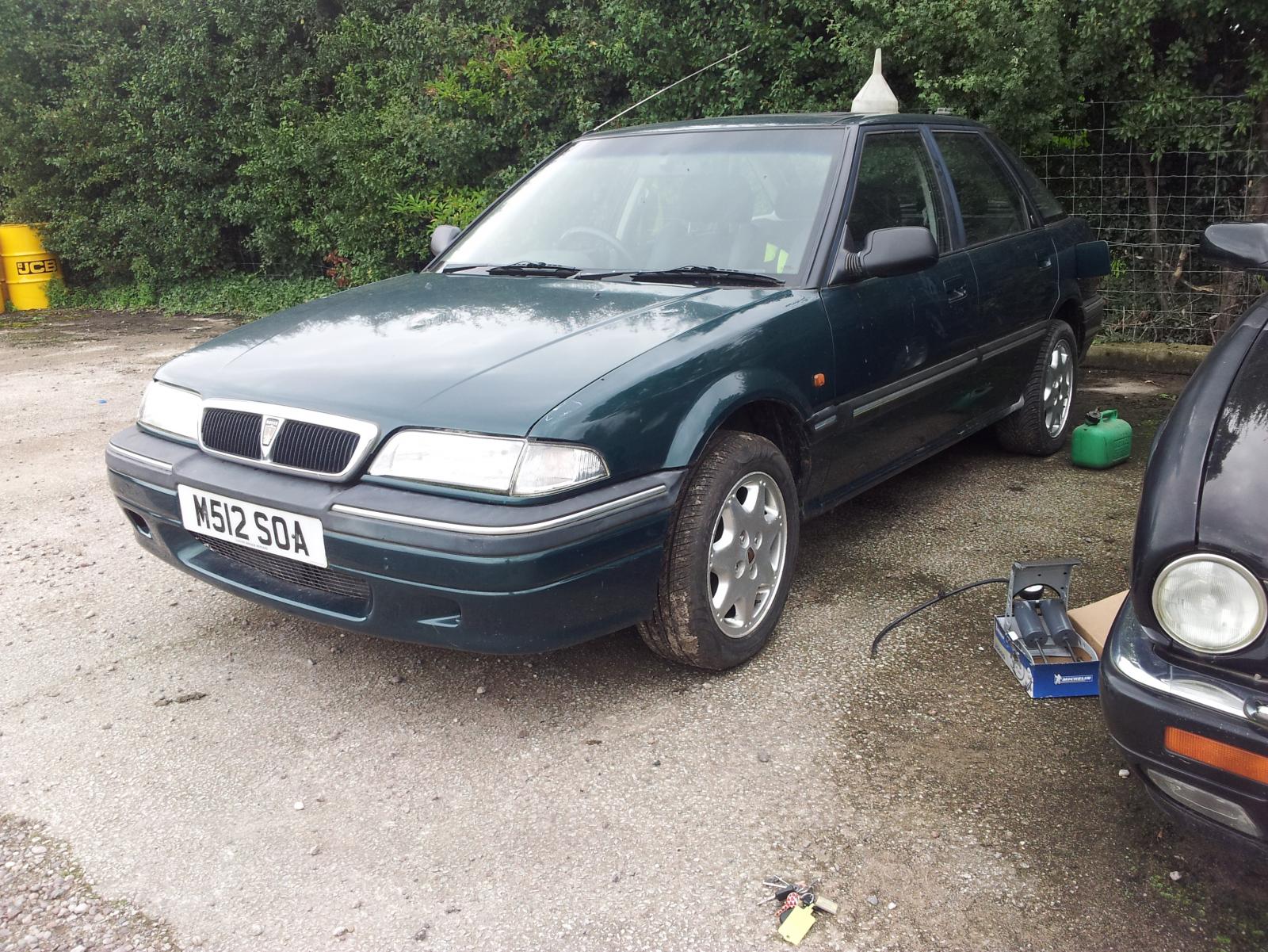

Mr_Bo11ox Posted September 7, 2016 Author Posted September 7, 2016 Right this thing is being rehomed this weekend, to another shiter. I did get the timing belt done in the end, basically I made loads of cuts in the tensioner with the slitting disc, smashed all the pieces away then had access to weld an M10 bolt onto the tensioner bolt 'properly', allowing me to get the tensioner bolt out with a 17mm ring spanner. What a fuggin war. Then I put a new belt & tensioner on and reassembled it all. Went up and checked it over last night, pumped tyres, topped up coolant and all the rest of it, should ge good to go for its long drive down to Devon. After that I will be completely out of stock of K-series (unless you count the KV6 in the Rover 45). The next hunk of Longbridge Landfill to join the fleet is this Rover 623: Check out this interior!!!! Some rust problems though: Been in touch with the sellers and they seem a sound bunch so I should be picking it up one night after work next week. Exciting times! Honey Badger, garethj, Dick Cheeseburger and 19 others 22
