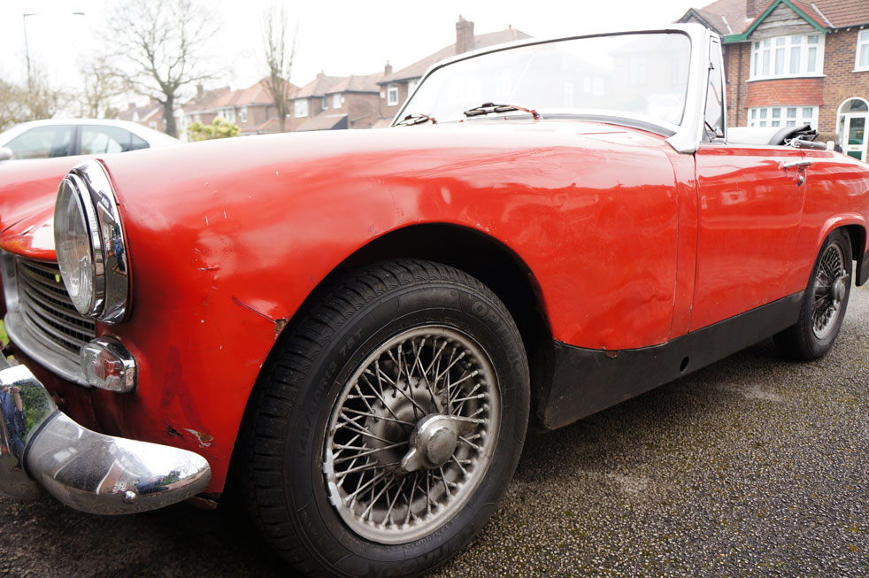

before:

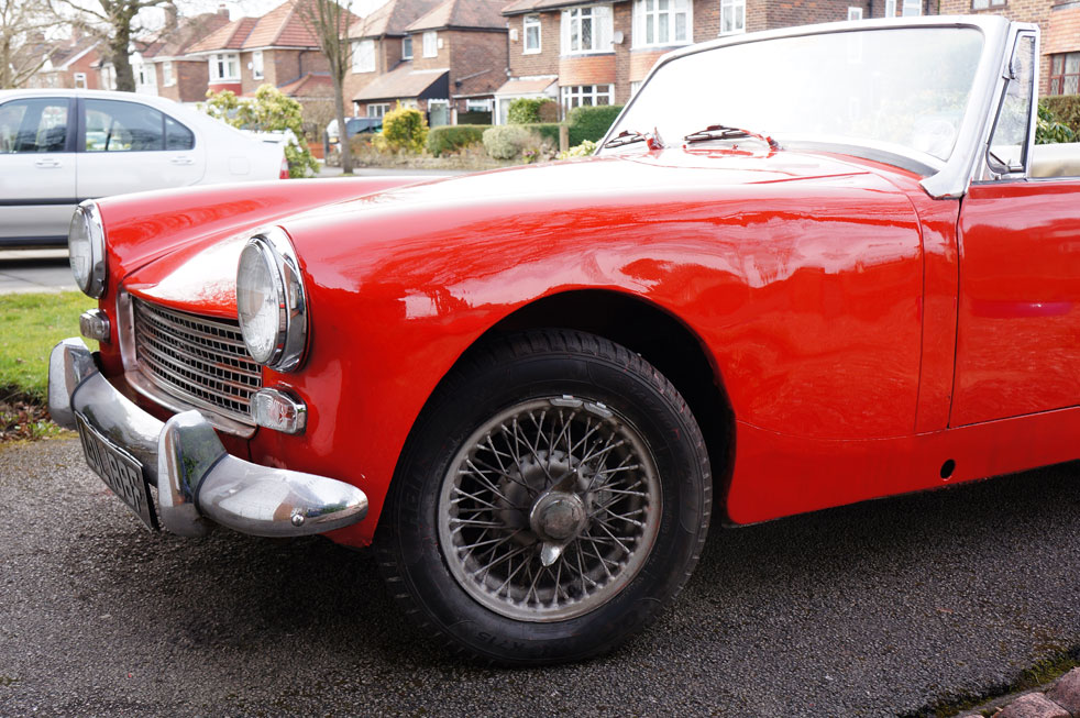

after:
(I gave the sills another couple of coats after this)
Cost to paint the whole car was about £40 including paint, rollers and white spirit. Definitely worth considering for anyone wanting to perk up a tired old car on a budget.
