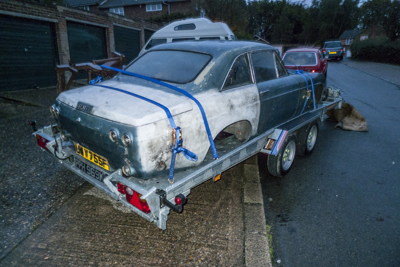

I bought it on eBay where it was aptly described as the "bucket case" coupe'! It certainly filled quite a few buckets with bits and It rained buckets while we were loading it. It was bought unseen with the sellers assurance that the chassis was 80% good but needed some welding. Which turned out to be a major understatement.
The body had been removed from the chassis and the body had been dry stored on its side in a lockup garage for more than 20 years, sadly the chassis had been left outside at an angle and had been allowed to fill with water. Most of the other parts seem to be present and having been stored in the dry seem much better than expected.

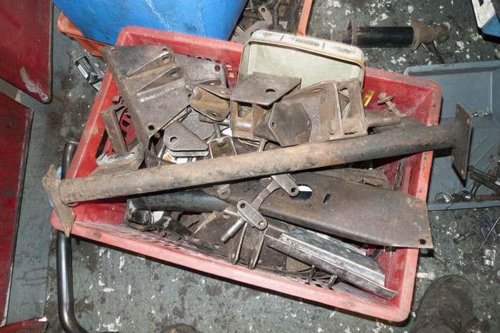

The following photos are of the collection there are not many as it was pouring with rain and we were in a rush to get it done before dark.

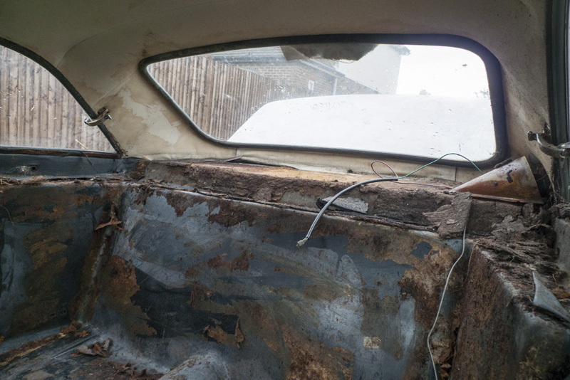

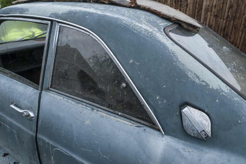

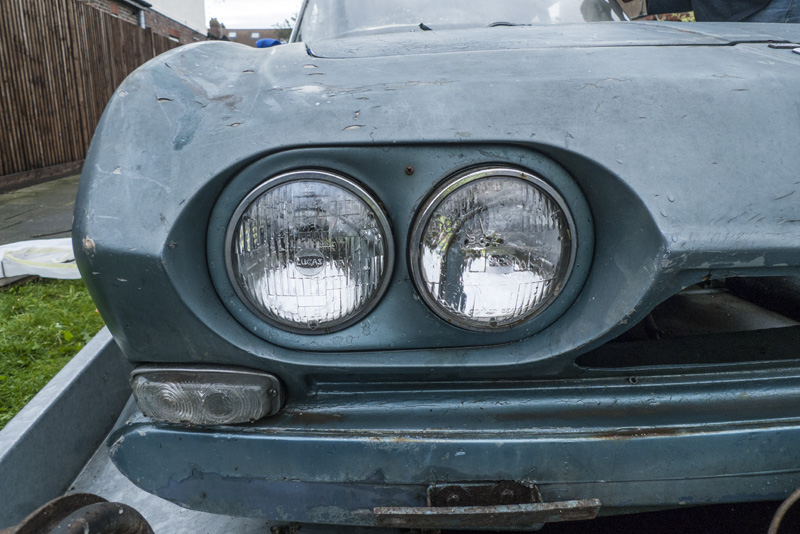

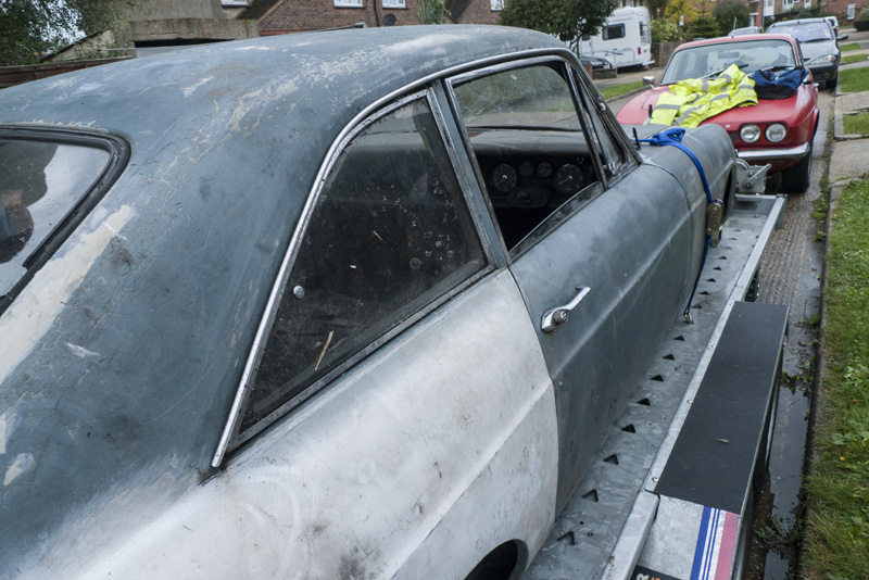

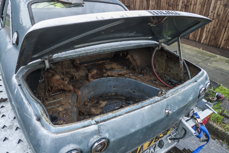

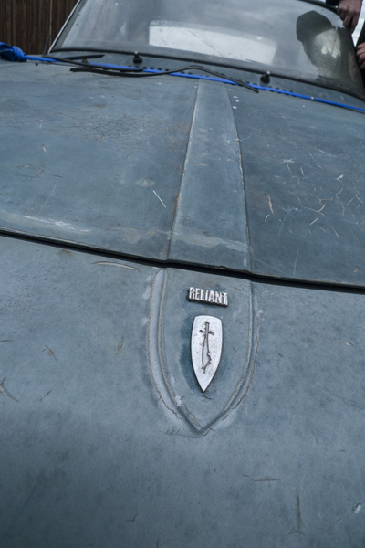

The following morning we were in a position to get a better look at what exactly we'd bought the bodywork is pretty good, the paintwork is mostly original, its cracked and peeling but doesnt seem to have much in the way of stress crazing or osmosis. its picked up a few scars from being stored on its side which will need attention before its fitted. We'll probably replace the sill support steel, seat supports and possibly the A pillar for good measure. The filler cap has seen better days and the side window chrome could be better there's also a couple of dents in the aluminum guttering which I'm hoping will pull back into shape. The front bumper needs rechroming but the back is presentable.

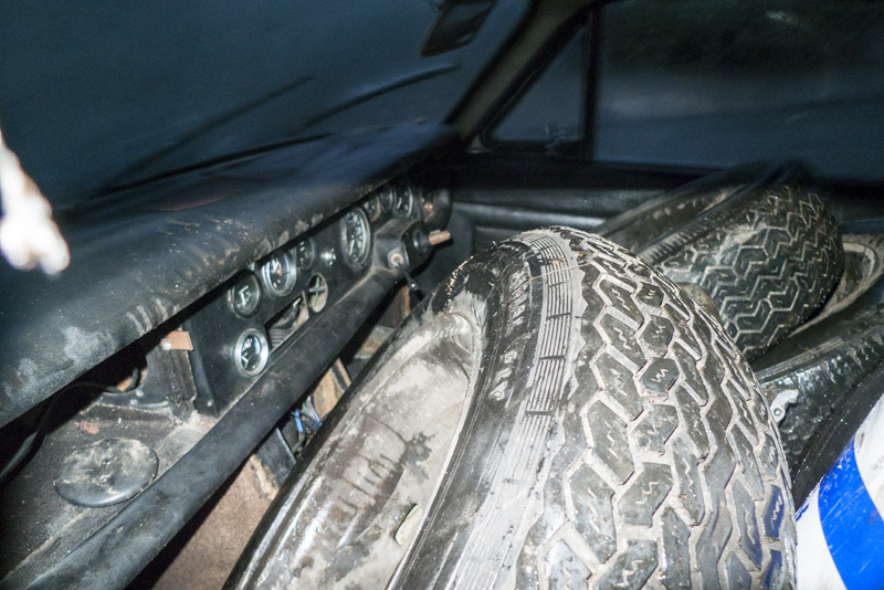

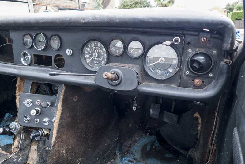

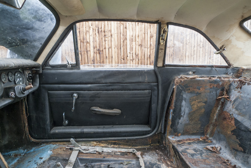

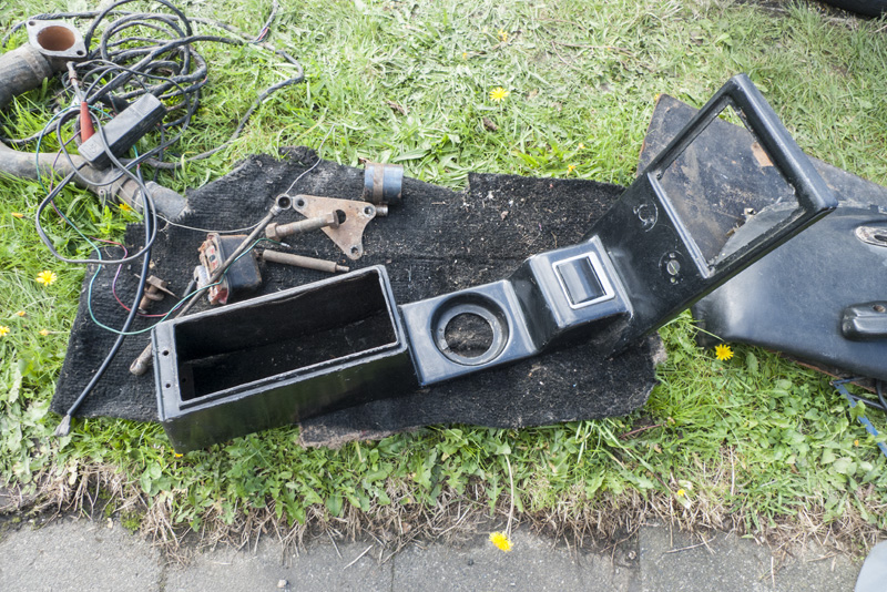

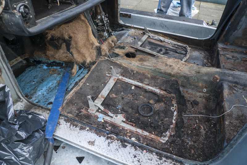

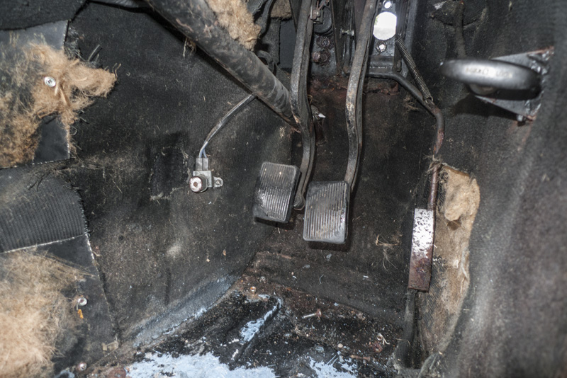

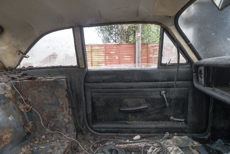

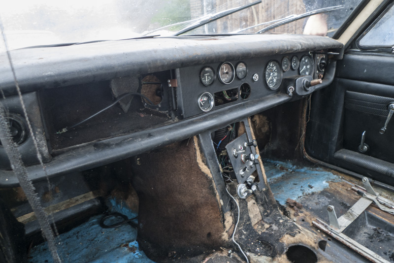

Interior wise most bits seem to be there, the dash has been hacked about with a bit to replace the radio for some extra dials, someone has patched up the floor in blue fibreglass after an old outrigger repair. I was particularly taken with the cast pedals with the adjusters which have a real feel of quality about them in compared to the plain ones on the GTE.

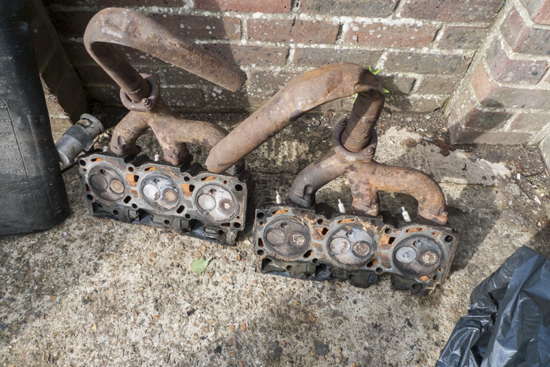

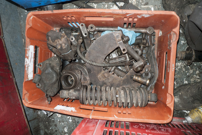

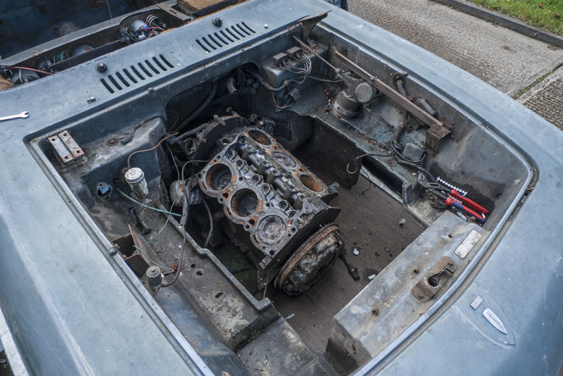

Engine wise it may turn out to be ok its an early O port with a fibre timing gear but it doenst seem to be the original Engine. Heads off for inspection / ease of handling. With some cleaning and upgrading it might well turn out to be a decent runner.
Doors, Boot, bonnet and glass was removed to cut down on weight and the body has been put into storage until the chassis can be sorted out...! :w

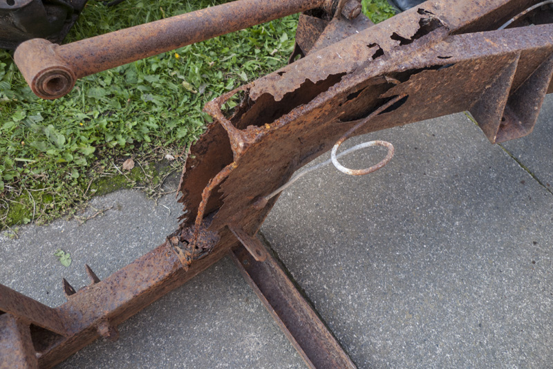

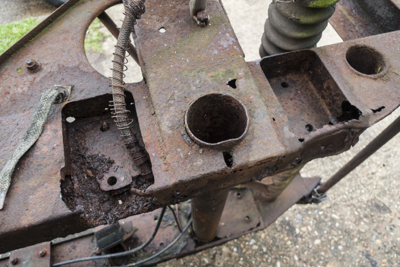

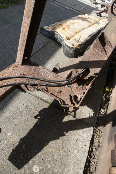

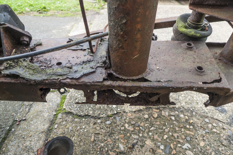

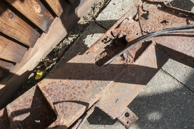

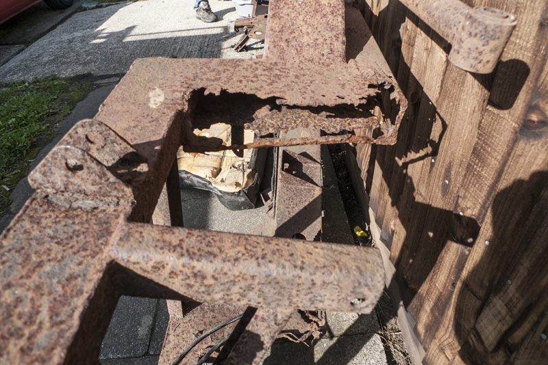

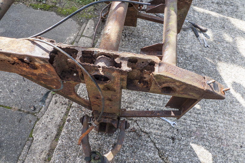

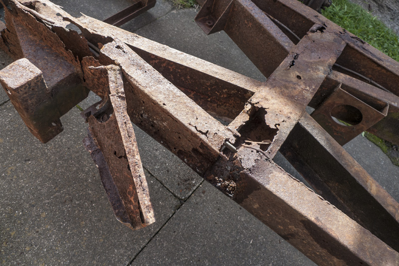

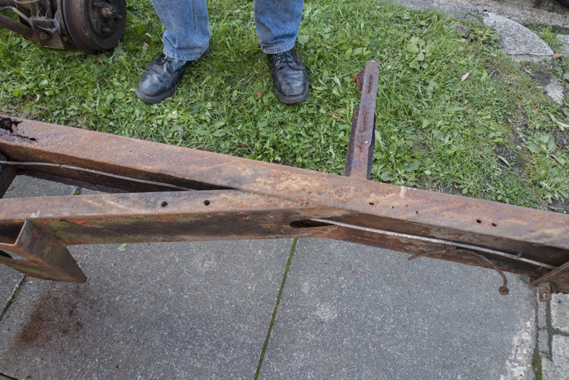

The following pictures show the chassis after 20 years in the rain unprotected. Warning the following post cointains scenes some shitters may find disturbing. :shock:
And finally an assortment of other pictures:
an inital wanted list goes something like this:
Priority:
Another Chassis, (progress has been made here)
Petrol tank, (an old one as a sample would help)

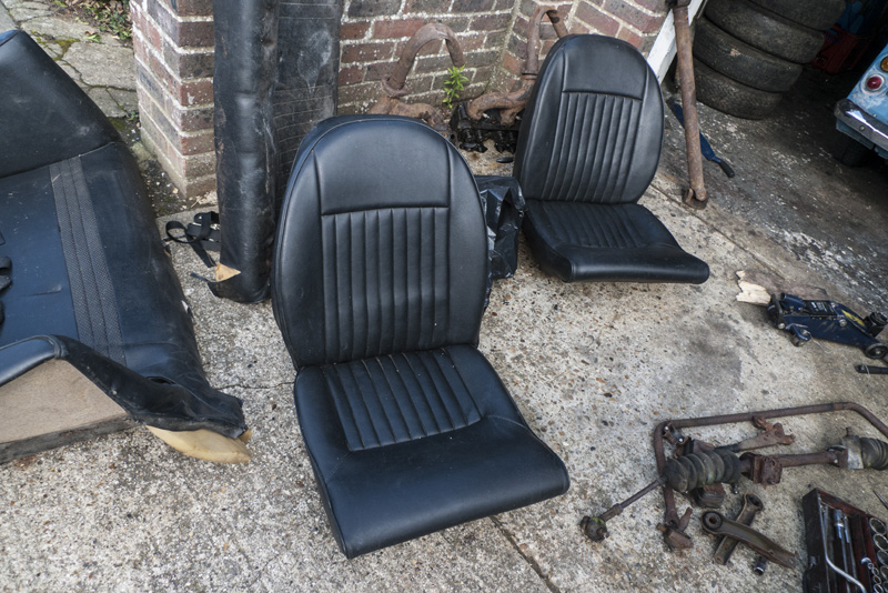

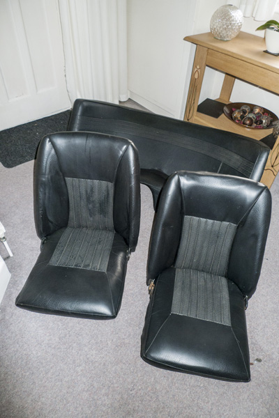

I've been told the seats may not be original so anyone got any ideas what they may be from?

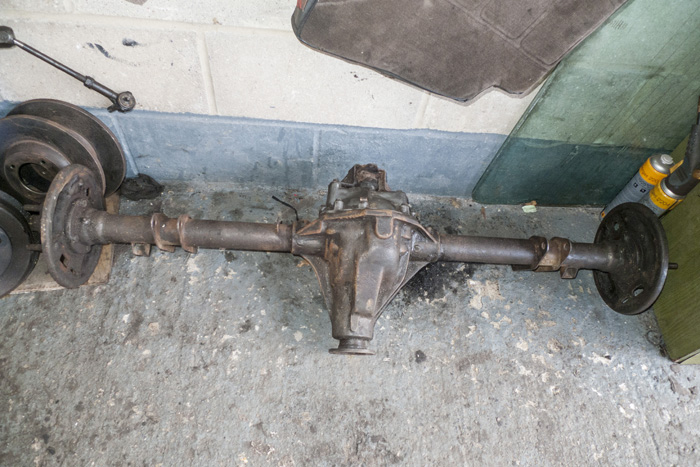

is that a 7ha salisbury, rather than the 4ha?
front seats look surprisingly good, and the centre console - at least some of difficult to find bits are useable.

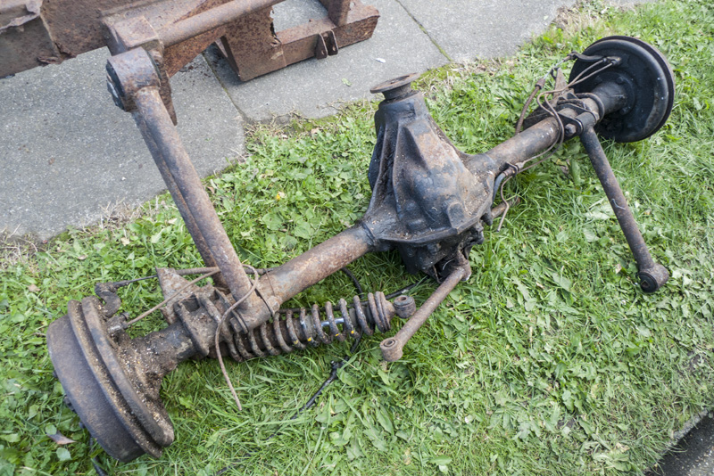

Axle pictured is the 7HA that came with the car but I may use a 4HA with LSD that I have in the garage I'll see how it goes. When I realized how misdescribed the chassis problems were I did negotiate a bit of a discounted price with the seller which took the sting out of it a bit.
Farkin' ell thats a lot of tinworm. (Shudders)....

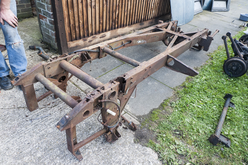

This is the smallest of updates really but I thought the photos might be of interest...

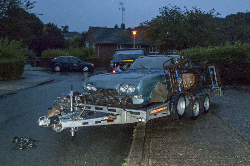

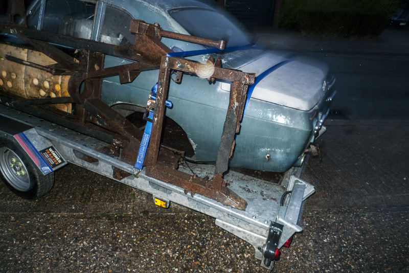

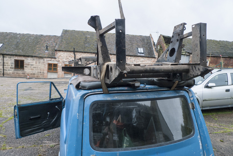

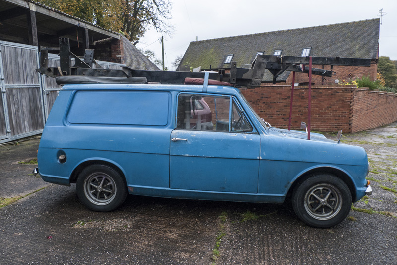

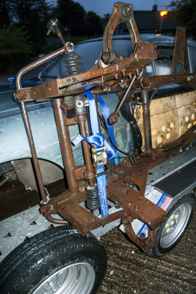

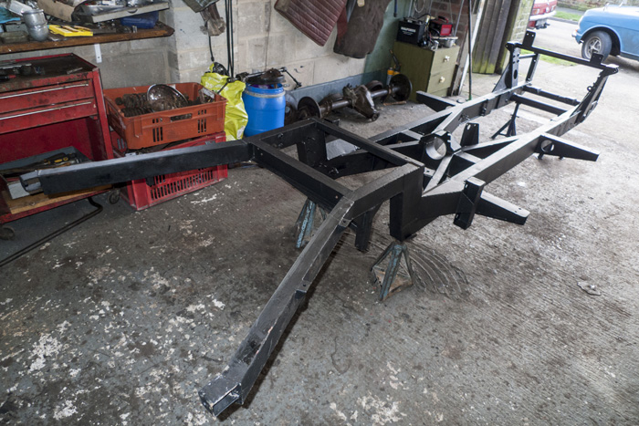

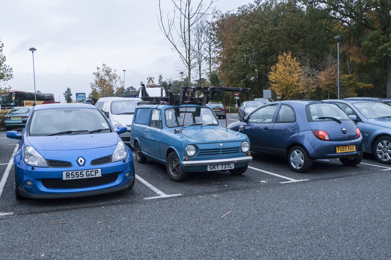

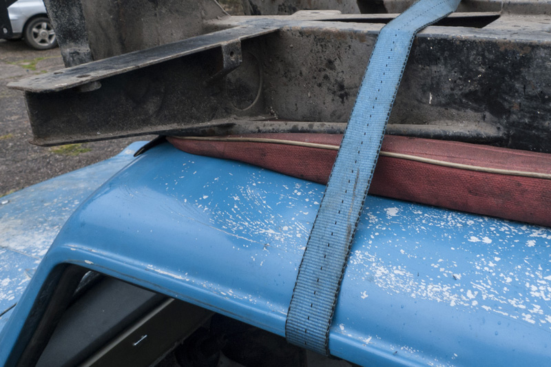

Dave and Myself spent today collecting a chassis from Stoke-on-trent. The hero of the last 12 hours is the Rebel Van which lugged the chassis back on its roof all the way home and never missed a beat. We got some funny looks as we came down the M6! The driving experience was surprisingly normal though sharp corners were taken with extra care!

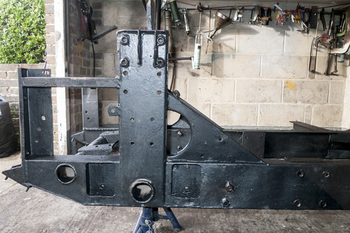

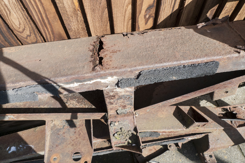

The chassis itself is generally in good condition, I'll get the wire brush out in the next few days and see what work is required (if any.) Thanks go to cookie for letting me buy the chassis, Its gone to a very appreciative new home! :D

I guess the race is on to see who is gonna get their shitty blue plastic coupe to the pub first. I think the smart money is on you guys despite having about 10x more to do than me...
Man I'm surprised there wasn't a disaster with that setup!
Fair play to you!
It think its a case of "looks worse than it is" I'd tested the theory with the chassis I had and was pretty happy that it was capable of handling the load. The actual amount of weight is probably not as much as you'd imagine. 2 people can just about lift it off and on! I'd like to think its an ambitious use of a vehicle rather than plain reckless...!

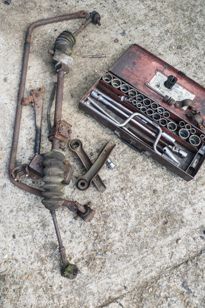

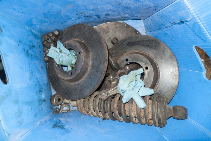

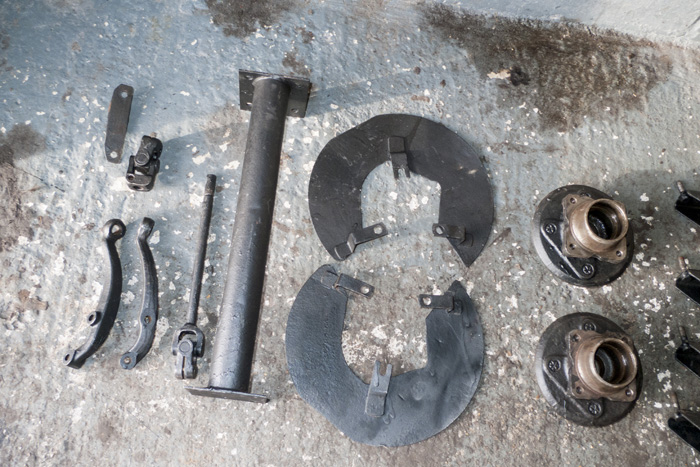

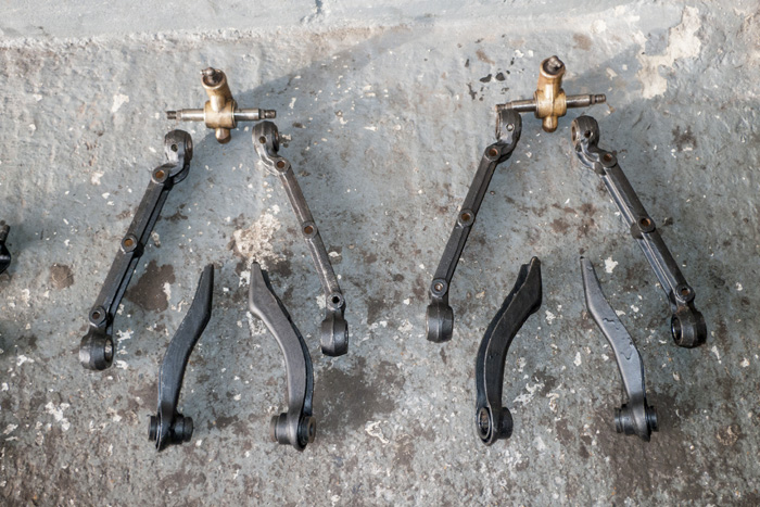

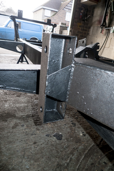

Still a bit of progress has been made The suspension was stripped down for inspection, cleaning and primer,

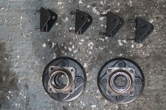

The following front suspension parts would be needed for certain: 2x Upper Fulcrums, 1x stub axle, 2x inner wheel bearings, 2x outer wheel bearings, 2x lower shock absorber mount plates and new bushes all round. The Trunnions, vertical links and wishbones turned out to be in decent condition.
The rear axle was also stripped down ready for cleaning and painting, The Drums look ok and all the oil seals seem surprisingly good, I've got cylinders and new shoes ready for reassembling, The U Bolts were in very poor condition and after a long afternoon trying to get the nuts to shift the slightly reckless decision was made to cut them off and find replacements. This has proved to be much harder than I imagined as few suppliers give the dimensions of their bolts most just list which cars they are intended to fit. Any suggestions on a source would be very helpful :D ! I'm assuming they must be the same as a more common car.... :w Of course if anyone has a good used set I'd be interested in them too :D .

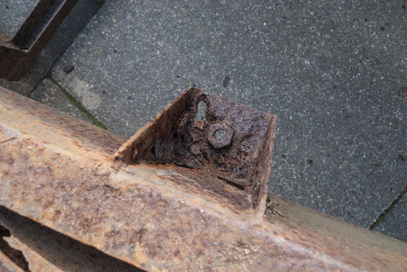

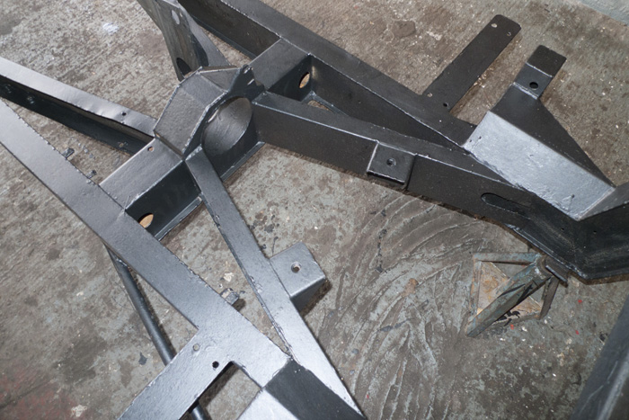

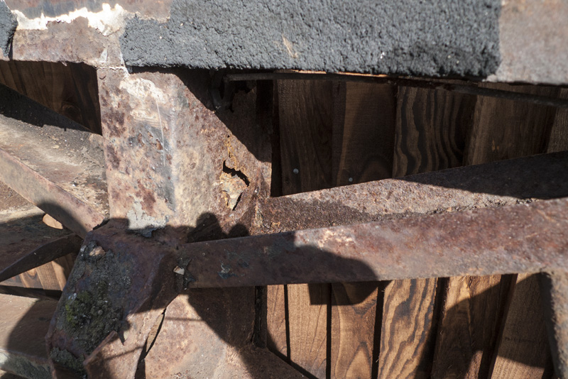

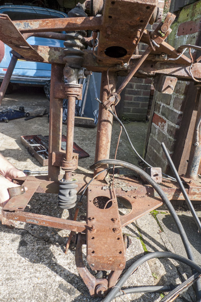

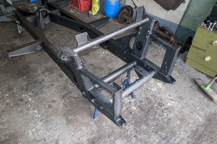

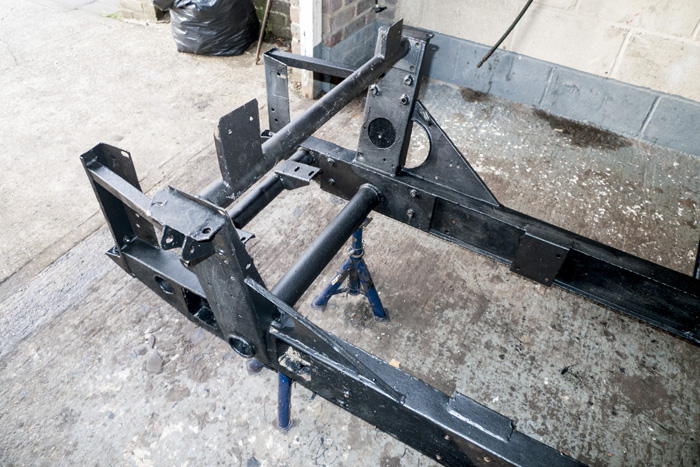

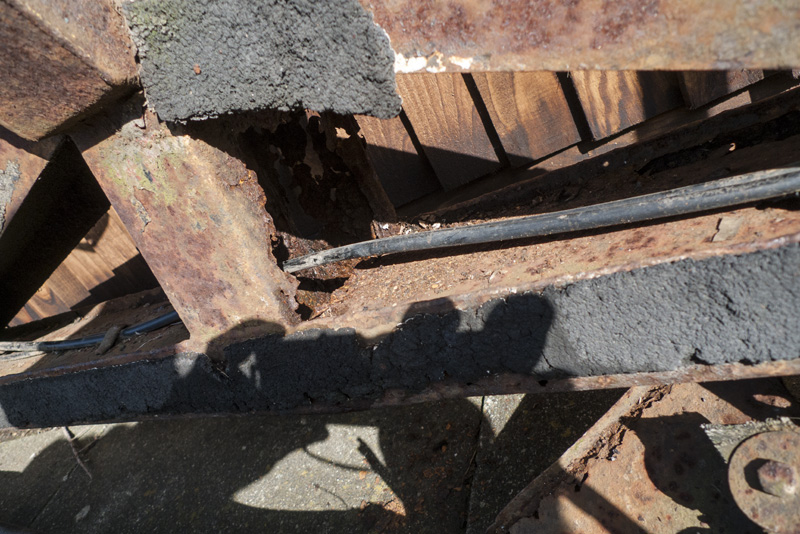

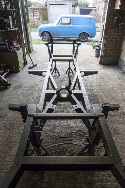

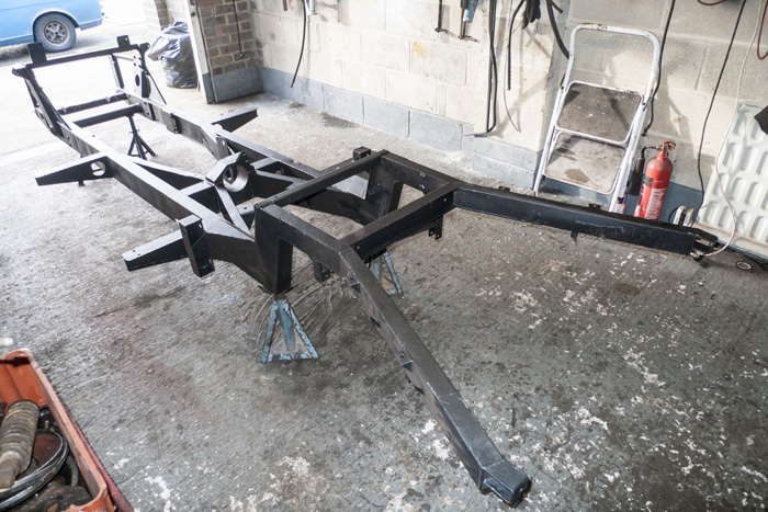

The chassis is in pretty good condition it needs some welding on the rear boot supports where the cleanup revealed a small hole. the rest of the chassis has been stripped down and primed, Its still waiting for a top coat treatment of cavity wax to the box and tube sections
I also managed to acquire a very good condition set of original seats which given their scarcity were too good to pass up.
Once cleaned up the front suspension has also been primed:

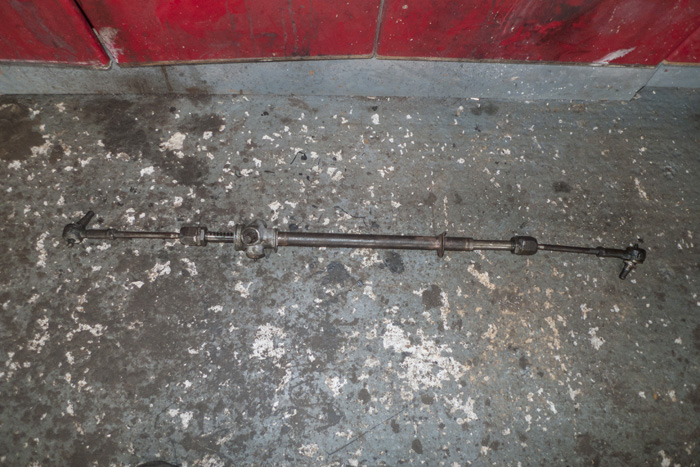

The steering rack waiting for checking / re-greasing

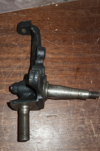

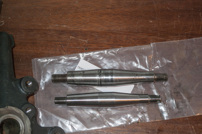

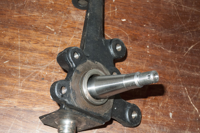

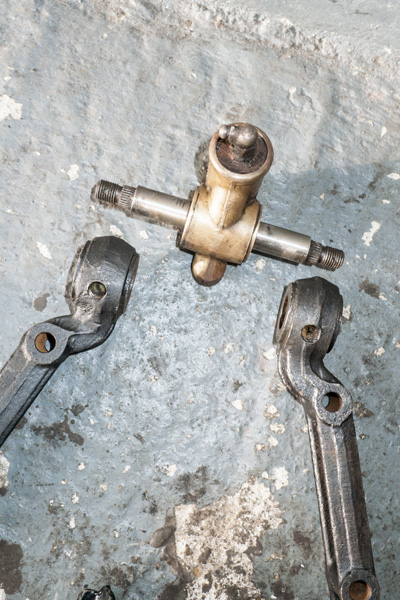

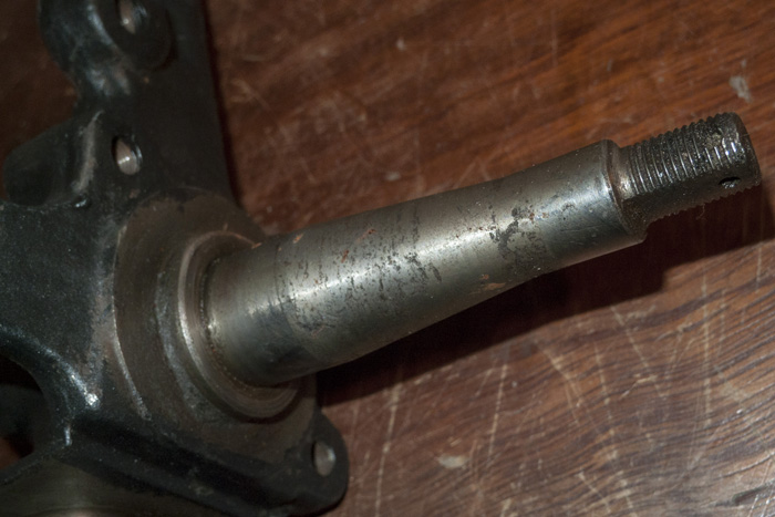

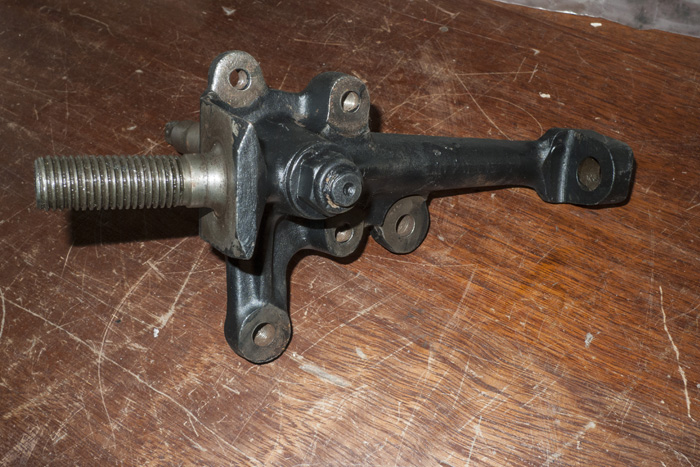

However when I took a closer look at the vertical links, hubs and stub axles it turned out that they seemed to be an uncommon variant.... as the stub axles are wider and longer than the standard ones with hubs to match, vertical links and trunnions are also of slightly different designs.
Comparison with a Standard Se5a stub.
I can only assume that this is an earlier design of hub / stub / vertical link dating back to the 4a / sabre? and when building my car reliant decided to use up some of their old parts stock, The length of the stubs is just under 7 and a half inches standard Se5a is just over 6 and a half.
My coupe vertical link with a 5 stub....
It seems no one supplies stub axles for this earlier suspension type anymore and they are different from the triumphs so I'm probably going to convert over to using 5a suspension. I'm assuming this simply involves substituting the lower wishbones, trunnions, vertical links, stubs and hubs and no further modification is required?
