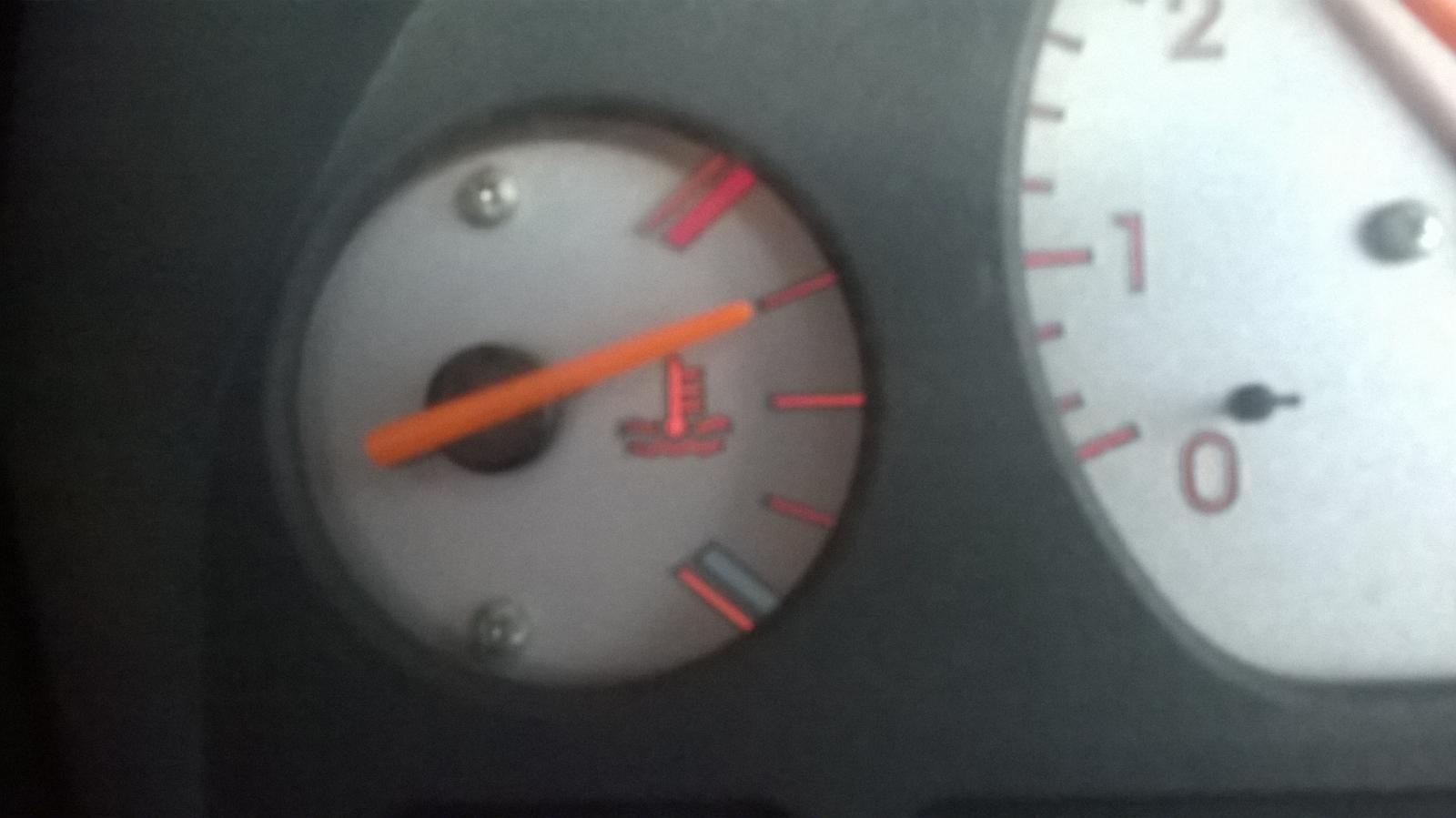

mrbenn Posted December 4, 2015 Posted December 4, 2015 It'll be the gauge that's broken, these engines aren't known for issues like this. dugong, KruJoe, The Reverend Bluejeans and 5 others 8
SambaS Posted December 4, 2015 Author Posted December 4, 2015 No water flow whatsoever. Suspect the new water pump. Hope haven't cooked headgasket

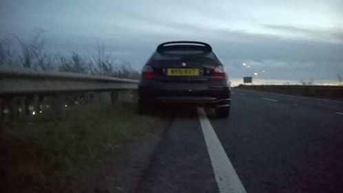

SambaS Posted December 6, 2015 Author Posted December 6, 2015 Saturday lunchtime Dave had the over heating problem sorted. I was trialling the car out using water no coolant Saturday night and went up the flooded Yorkshire Dales. By Hawes I had a serious missfire and turned back only to completely cut out near Bainbridge. Jack and I braved the wind, only just being able to move forward against it and made the pub where I had reception, and called the AA. Sheoes and socks drying on the fire, pints in they called and were only in Hawes. So back to the car against the weather. We got recovered to the scrapyard this car was sourced. Sunday I went and removed some of the water from the plug recesses, sprayed some WD40 on the connectors and with a jump start it fired up and ran sweet. Success. Drove towards the pez station missfire started again, I pressed on aiming to get to my barn and it was really struggling with forward motion by now, then smoke started coming through the vents and center console, I pulled over and the car was on fire. Flung all me stuff on hard shoulder and considered letting it burn ! Seriously but then sense came over me as I was next to the A1, moved the gas bottle way away and took the sub out, checked if it was still alight yep... 999, fire men came six or seven, fired resolved. no gears, no handbrake fire has permanently applied handbrake some how, I think I put it on and the fire melted it on permanent. So AA man had trouble getting me back to the scrapyard. After having a quick look maybe the gear link came off and set fire on the catalyst or something. Assuming the link is plastic. otherwise I've no idea, but its a totally different area to the last near miss when the headgasket went.

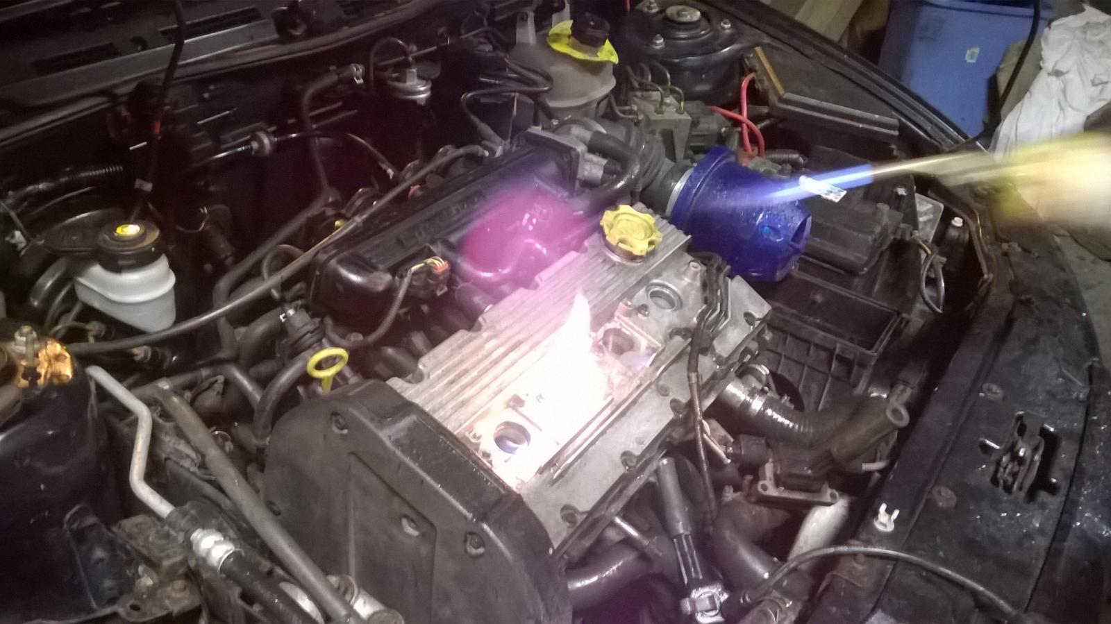

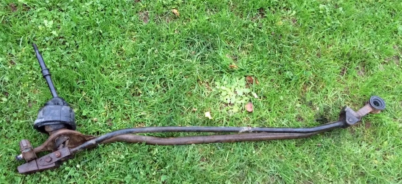

SambaS Posted December 7, 2015 Author Posted December 7, 2015 Monday Afternoon. Pushed the MG into the garage, used compressed air and fire to dry out the plug recesses: Stated it up - missfiring like hell. Swapped the colil packs and HT leads from the red car and it seemed happy. Then to see what the fire was. Gear link plastic inserts burned and rod had detached hence loss of gears, exhaust hangars burned, gear link bushes burned, handbrake cable burned some wiring burned, haven't checked under the center console yet. All three Rovers in the scrappy had different links so Dave chopped the bad end off and welded on one he had lying around. So I have gears now. The hand brake still wont work and if I touch it, it will stick on. So a new cable will have to be ordered, as well as aforementioned hangars and bushes and wiring, and whatever else I find. I have a new light on permanent to join the ABS and EML - hand brake light YAY Good news though the smell off my mates dog has gone! Just smells like fire. This car really is on it's last chance. [EDIT] Oh and exhaust heat shields are there for a reason! trigger, Skizzer, beko1987 and 5 others 8
