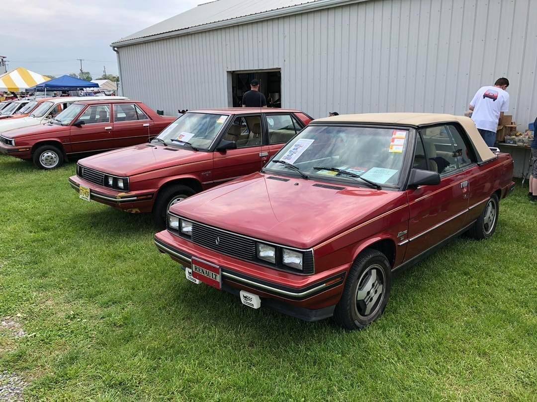

Seems like there is at least a small following for these,
All done well to survive given the image and parts support situation.
