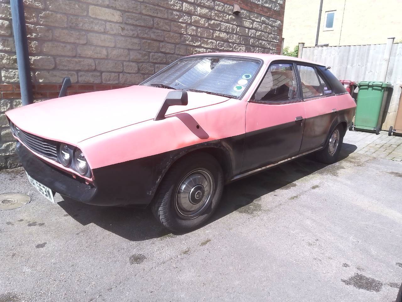

good to  hear the princess is on the mend! and both those colours look cool. but as you say metallics can be an arse!

Hate the mirrors,hate the lights,hate the colour combo,love the wheel trims 🤣
I'm glad we are all different

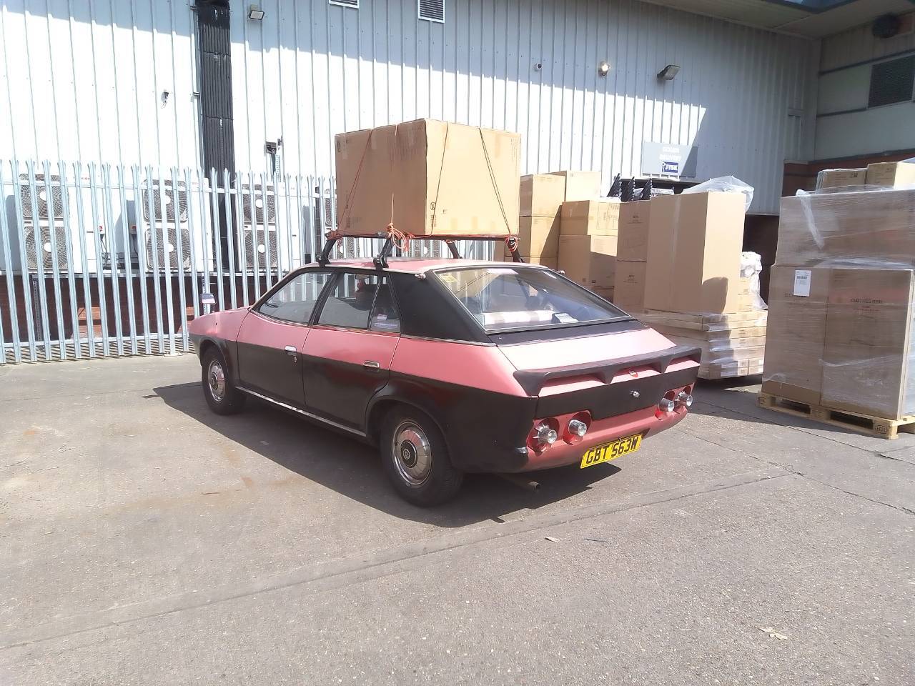

Agreed to help the housemate collect a new armchair to save them £30 delivery.  Didn't think to ask how big the chair was.  Luckily, I've got a roof rack and some hairy orange rope and I'm not afraid to use it!
If that's not a calendar entry I don't know what is.
thats bigger than those rooftop camping box tent thingy's !
How big are their arms?

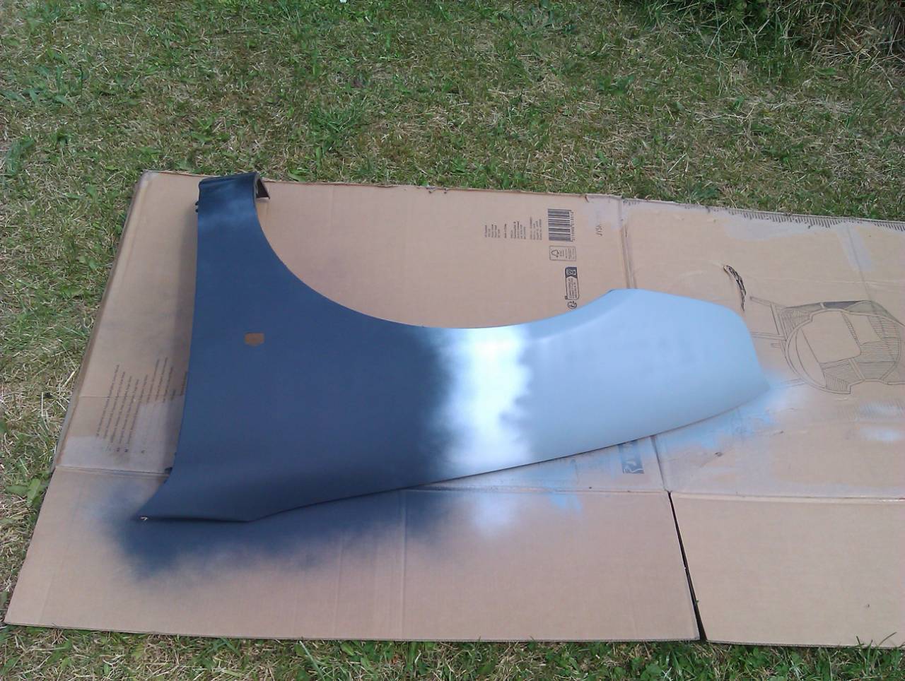

Unexpected free time and good weather? That means it's time to sample these paints to see if I like them.
First up, prime the donor panel, a dented up old Rover wing destined for scrap. Dark grey primer, a white primer barrier (no top coat on that one), and light grey primer. We weren't sure which grey would be best under the colour coats.

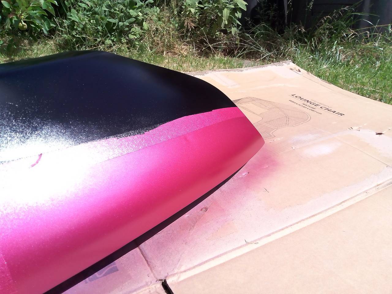

Next, tape it off into sections so there's reference for what primer is where, and hit it with some colour coats.  We're using Nissan Cerise and Peugeot Raven Black here.
The pink goes over the light grey much better and the colour pops more than it does over the dark grey.  The black doesn't really seem to care either way.  Interestingly, the black has quite a lot of green tint in it and that works really well against the pink to make both colours look richer.  The black looks blacker than the black gloss on the car, funnily enough.  The pink is also quite hard to photograph 'accurately' because depending on the light, the camera, and the viewing angle it can look pink, purple, or red.
Get the tape off and hang this wing up so we can see it in the orientation it'll be on the car, if we pretend this is a Princess wing of course.
Nissan Cerise is a total winner here for me.  It's such an interesting and vibrant colour, I'm so glad it was pointed out as being a potential candidate because I'm not sure I would have gone looking for it.  In combination with the Peugeot Raven Black the two colours play so well off each other that I don't feel any need to go looking for an alternative.  It's going to be quite an improvement over the current colour choices which almost look boring now.

Worth mentioning that the pink lays down incredibly nicely even out of a rattle can and is surprisingly forgiving for a metallic when it comes to panel imperfections.  The black not so much, that's even worse than the black on the car for showing up every little dent which is a bit worrying since the worst bits of the bodywork for dents and wobbles are all in the black zone so I've definitely got a lot of sanding ahead of me.
