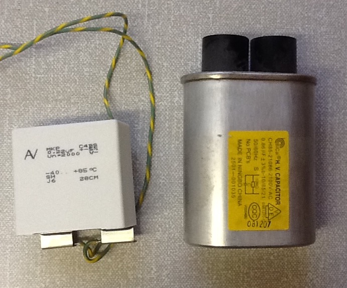

PhilA Posted December 20, 2018 Posted December 20, 2018 I was wondering why Cars dont just use regular high quality high voltage capacitors these days? (ie why do cars still use a capacitor desgined 50 years ago )Because money. The paper ones in a little metal can are cheaper to mass produce than polyester film, because polyester film requires some tightly controlled manufacturing procedures. The older style ones can be made with a spatula and some newspaper by the local children of whatever developing country you pick as cheapest to make it this week. Phil GrumpiusMaximus and LightBulbFun 2
Asimo Posted December 20, 2018 Posted December 20, 2018 This is the sort of capacitor I'd use if I had a car without electronic ignition. The smaller one is designed for " snubbing" duties, ie absorbing switching spikes in motor control equipment etc, the larger is from a cheap microwave oven. Both rated at 2kV. A few car "condensers" I measured once were in the region of 300nF but I have not found any hard information on what capacitance is actually required; it will be a function of both the particular coil and the maximum number of sparks per second. Anyway, back to the Princess. The rebuilt carb. will sort it I'm sure, clean fuel and healthy sparks permitting. LightBulbFun 1
PhilA Posted December 20, 2018 Posted December 20, 2018 They are technically tuned to the coil but anything from about 0.5 to 1uF will work adequately. Phil LightBulbFun 1

Squire_Dawson Posted December 21, 2018 Posted December 21, 2018 .18 to .23 microfarad apparently. LightBulbFun 1
PhilA Posted December 22, 2018 Posted December 22, 2018 That's an easy value to get in high voltage/low ESR film If it makes you feel better you could stuff one inside a tin condenser can Phil LightBulbFun 1
LightBulbFun Posted December 22, 2018 Posted December 22, 2018 That's an easy value to get in high voltage/low ESR film If it makes you feel better you could stuff one inside a tin condenser can Phil thats what im thinking, and surprised it aint the norm in car circles? pretty much what everyone and their dog does these days when it comes to valve/vacuum tube radios/TVs at least...

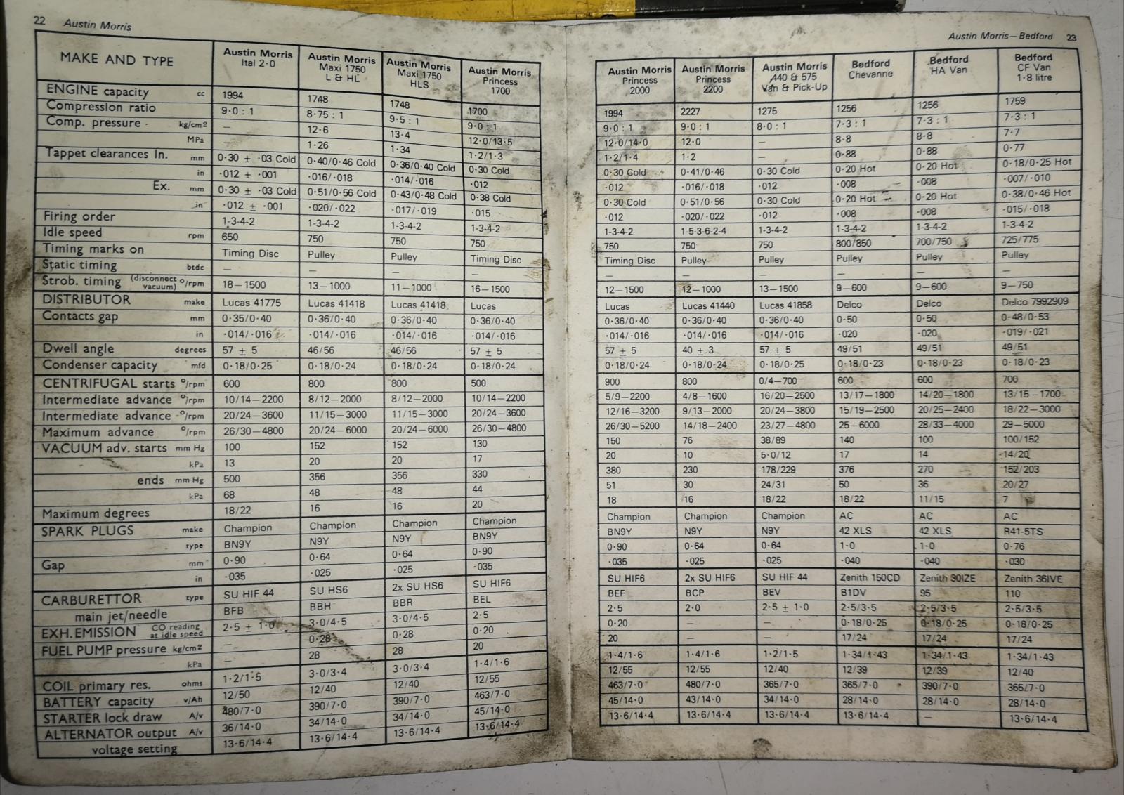

Zelandeth Posted December 30, 2018 Posted December 30, 2018 Guessing this is data you already have on hand, but seemed worth a quick post of it anyhow in case it contains anything useful. LightBulbFun and vulgalour 2
