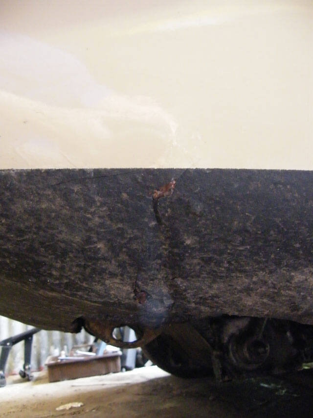

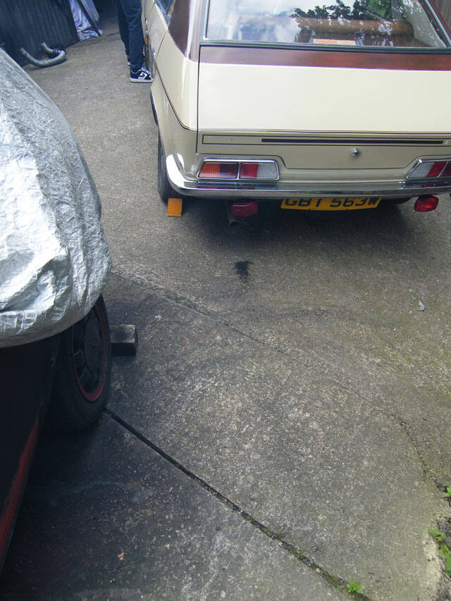

I did not get away Scot free with it either, so now both my front wings have battle scars. It looks better in the pictures, it's going to be a bugger of a thing to fix properly.
Worst of all, it's managed to make a mess of the arch trim which is made of unobtanium and was, until now, pretty much okay.

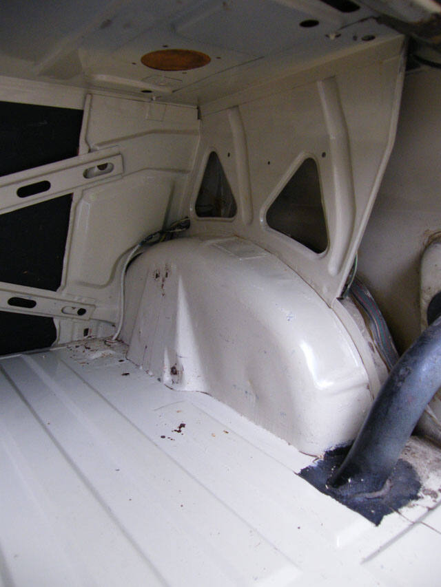

So, everything out of the boot I could give it all a vacuum to get the worst bits out. In the back corners there's a bit of surface rust which I'll go into detail about in a bit.
After a good dose of Cillit Bang to get rid of the grease, dust and other ground in muck, the main floor came up okay. It all got wiped over with plain water afterwards to get rid of any of the Cillit Bang that might be left so the (admittedly poor) paint wouldn't get unduly damaged.
The sides got the same treatment. The spare wheel well appears to have been repaired before and there was a slimy grease on top of the thick black paint that was a pain to remove and could do with a bit more attention yet. Also managed to partially clear out the drain hole enough for water to escape.
I need to fettle it a bit more to really get it spotless, but it's a lot better than it was. There's the odd bit of rust and glue staining and a few paint dribbles, but mostly it's just in need of some fresh trim panels.
There's some bubbling on this corner at the back. This side it seems to be little more than surface crust and I'll tackle it another day when I can be bothered (it has been a long day today). The underlying metal seems okay, but I am expecting some holing, I just hope that this isn't a structural area. I can't see what it covers, and from underneath there's no sign of a captive bolt or similar that I need to worry about so with a bit of luck it will just be boot floor.

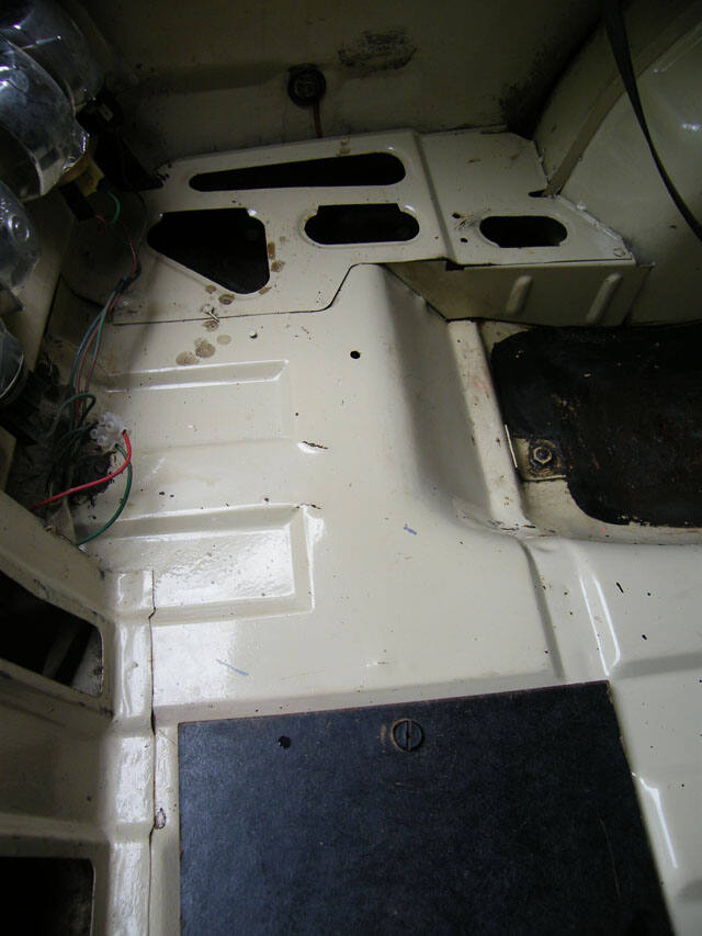

Other side of the boot before I set to work. The plastic cover goes over the fuel pipe and really helps smarten things up well.
I had to remove said cover as it had overspray and dirt ingrained on it. Gave it a jolly good scrub. I need to have another crack at it to get the last bits of paint off, but most of the time this is invisible unless for some reason you're curled up in the boot. After I'd scrubbed it with an old green scourer - quite useful for removing paint from plastic without damaging the plastic, unlike a new green scourer which can be too harsh - and soapy water I gave it a wipe over with some Autoglym Rubber & Vinyl to freshen up the appearance of the plastic.
As on the other side, this area has some corrosion. The difference is that this area has got a split in the metal so it's worse. Again, I can't see anything structural that attaches to it and the only interruption to the area is that wire which, I think, goes to the old in tank fuel pump (could be wrong). This area does need welding, I'm hoping it will either not fail the MoT or can be done before it if I have some cash before the 15th of September. As far as I can tell, it's outside of the prescribed area for suspension components and with there being no rear seat belts there's no prescribed area to worry about for that either.
Presumably because this side doesn't have the spare wheel, it was cleaner and easier to get up to scratch.
I didn't go overboard with the bit behind the plastic trim here, there didn't seem to be too much point.

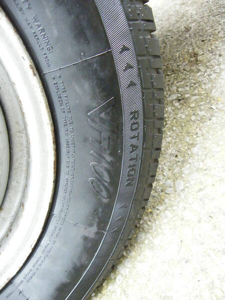

The other job today was to get that Kingpin off. Bank of Mum and Dad offered me a short term loan with favourable rates so I could go and get tyres organised. This old Kingpin really is shot, it shouldn't be anywhere near my car or the road! Had I been stopped by the Police I'm pretty sure it would have been fines and points ahoy.
We went to a tyre place in Mansfield (I've forgotten the name) in Dad's Carina. We didn't put the Kingpin in the car, instead we took the tyre that's fairly new but only holds 3psi. The place took the tyre off, sanded the rusty rim (cause of the leak) and put a new valve in for me for £15.
Brother pointed out that this tyre is directional, so it's on the correct side of the car. I'm hoping it won't leak again so I'll be checking on it tomorrow to see what happens. None of my tyres match; three part worns and one nearly new, all with good tread with that antediluvian Kingpin in the boot. Eventually, I want to replace all five tyres with good new ones or at the very least matching part worns, but it's all money I don't have right now.
