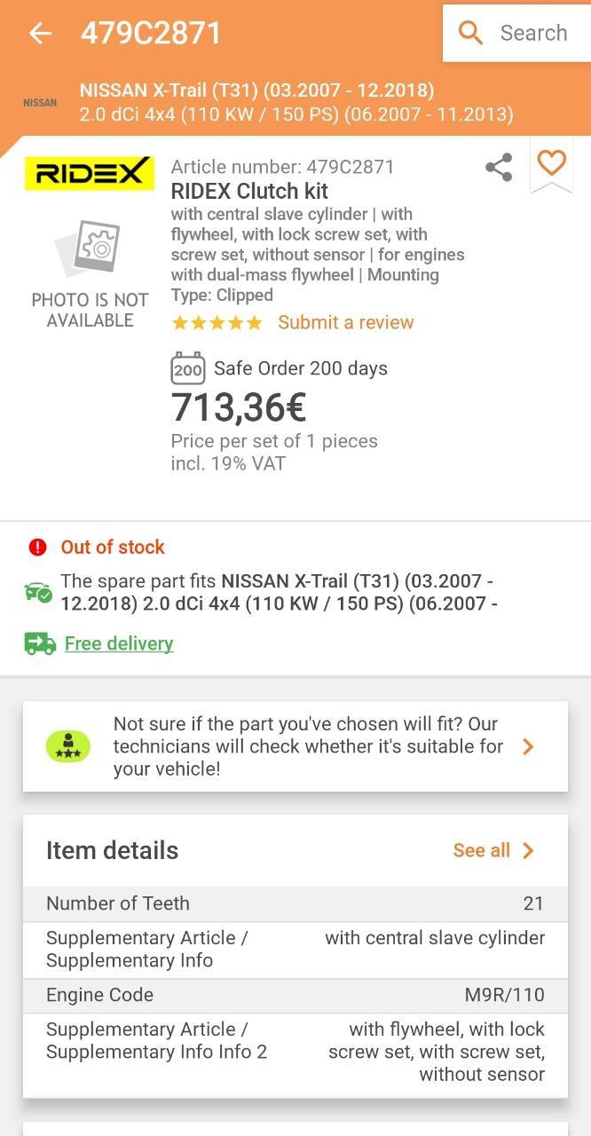

Wack Posted April 6, 2024 Author Posted April 6, 2024 Autodoc do a solid Flywheel kit Inc clutch for under £300, then it's just the slave cylinder and labour, still over a grand and I've lost the DMF and any issues that may bring I got the car cheap and apart from this it drives like it's done 30k not 116 I'm tempted to just drive it until it becomes undriveable then see where I'm at, I could do without a £1500 bill at the moment
Wack Posted April 6, 2024 Author Posted April 6, 2024 38 minutes ago, Bmwdumptruck said: Think I’d start by looking for the parts myself. Bought full Sachs kits for both my Sharans c/w DMFs for way less than these prices. Search for the part nos and then for the parts. The only issue there is if they supply the parts and do the job it's warranted for 12 months, if I supply the parts I might save a few quid but if something goes wrong then it'll be down to me There's no real saving on the parts autodoc are only £150 or so cheaper tor ridex? I don't think for a minute I'm being ripped off, I've used these guys for years, I just think it's the price for the job, These days you're lucky if you can find a garage to take a job like this on at all beko1987 1
artdjones Posted April 6, 2024 Posted April 6, 2024 It's not in stock anyway but Ridex is a generic make on Autodoc. So probably Chinese. I'd only use LuK, Sachs, Exedy, or Valeo. Wack 1
sierraman Posted April 6, 2024 Posted April 6, 2024 Ridex 🤣🤣🤣 Can’t understand going to the trouble of the Labour on a big job like that and fitting dog shit like Ridex. An acquaintance recently asked me to fit one of their EGRs, complete junk, didn’t fit and arrived cracked as we discovered as soon as the system was pressurised, the difference between the proper Pierburg one and the Ridex was palpable. I wouldn’t entertain any other clutches than LuK, Sachs or Valeo. Reason the garage won’t want to know is that the customer is supplying a crap clutch which may/may not be correct and ultimately when it’s craps out in a month affects their reputation. Bear and RoverFolkUs 2

Wack Posted April 6, 2024 Author Posted April 6, 2024 1 hour ago, artdjones said: I'd only use LuK, Sachs, Exedy, or Valeo. That's what they've quoted for, half the job is labour and that's at £50 an hour plus vat which is really cheap, a lot of garages would be charging £1000+ vat for 10 hours labour I've no intention of trying to source cheaper parts, it's drive it until it breaks then decide whether I fix it or they supply parts and fix it I really like the car, it fits exactly what I need at the moment, I only paid £800 for it so even at £2300 with a new clutch it's not a disaster If you can do the job yourself then it makes sense to buy the parts, maybe not ridex though 😂

artdjones Posted April 6, 2024 Posted April 6, 2024 4 hours ago, Wack said: That's what they've quoted for, half the job is labour and that's at £50 an hour plus vat which is really cheap, a lot of garages would be charging £1000+ vat for 10 hours labour I've no intention of trying to source cheaper parts, it's drive it until it breaks then decide whether I fix it or they supply parts and fix it I really like the car, it fits exactly what I need at the moment, I only paid £800 for it so even at £2300 with a new clutch it's not a disaster If you can do the job yourself then it makes sense to buy the parts, maybe not ridex though 😂 Autodoc are doing the LuK kit for €695 on the app today, so around £600.

Wack Posted April 7, 2024 Author Posted April 7, 2024 13 hours ago, artdjones said: Autodoc are doing the LuK kit for €695 on the app today, so around £600. This is all that comes up on the x trail, at that money I'd just let them supply the parts
