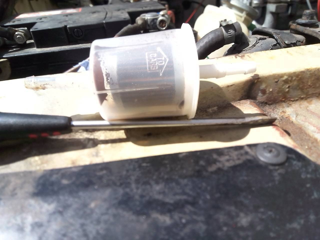

Then on to actual fixes, first up was replacing the fuel filter since some red sediment had been pulled through from the tank and the filter was looking pretty grubby.

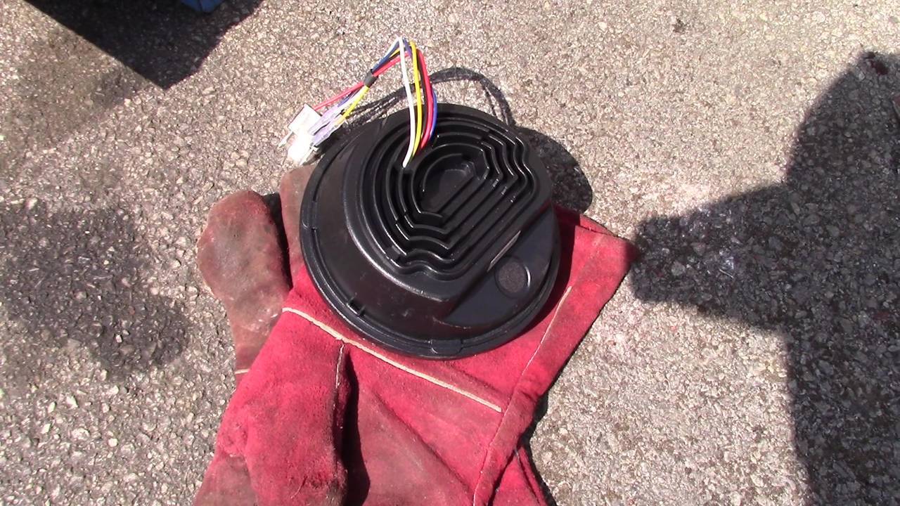

Had a go at fitting the LED headlights and have encountered some small issues.  Nothing terrible, I'm pretty sure it can be worked around, but these aren't quite as plug and play as they might be.  I do know these aren't really being sold as a twin headlight solution, so I did expect a bit of wiring shenanigans to get that aspect to work.  This is fine, it can be done.  What I hadn't expected was that they wouldn't actually fit without modifying the car a bit.
The headlights on the Princess are held in place with standard classic car adjuster bowls that locate on two screw threaded bolts and one retaining spring, like so.
The trouble is the shape of the back of the LED unit is such that it can't sit down in the adjuster bowl properly and the retaining ring can't be attached.  So, I need to chop off a lot of the adjuster bowl which I could do by the magic of having a spare set and this is why it's not hoarding.
A little bit of massaging of the metal to stretch it a little further and it does fit.  However, there's now nowhere to put the retaining spring that stops the bowl from falling off so I'll have to modify these further to accomodate that somehow.  That put paid to fitting these new headlights today, that's more work than I want to get into right now.
Then I tried plugging in the LED unit to the outer pair as you would any other headlight and found it wouldn't turn on at all.  It's only when I remove the twin headlight harness that runs from the outer to the inner light (inners are H1, and do main beam only) and plug the LED light directly in as if the car has only got single headlights that they work properly.  What did surprise me is that I actually do like how these look on the car, you end up with a mostly black front panel with the chrome retaining rings for the headlights and that actually looks very smart.  I couldn't mock it up safely for camera, too many bits to hold on to, so all you get is this shot of me showing just how much brighter the LEDs are compared to the halogens.  If they're this bright in daylight I should be fine at night.

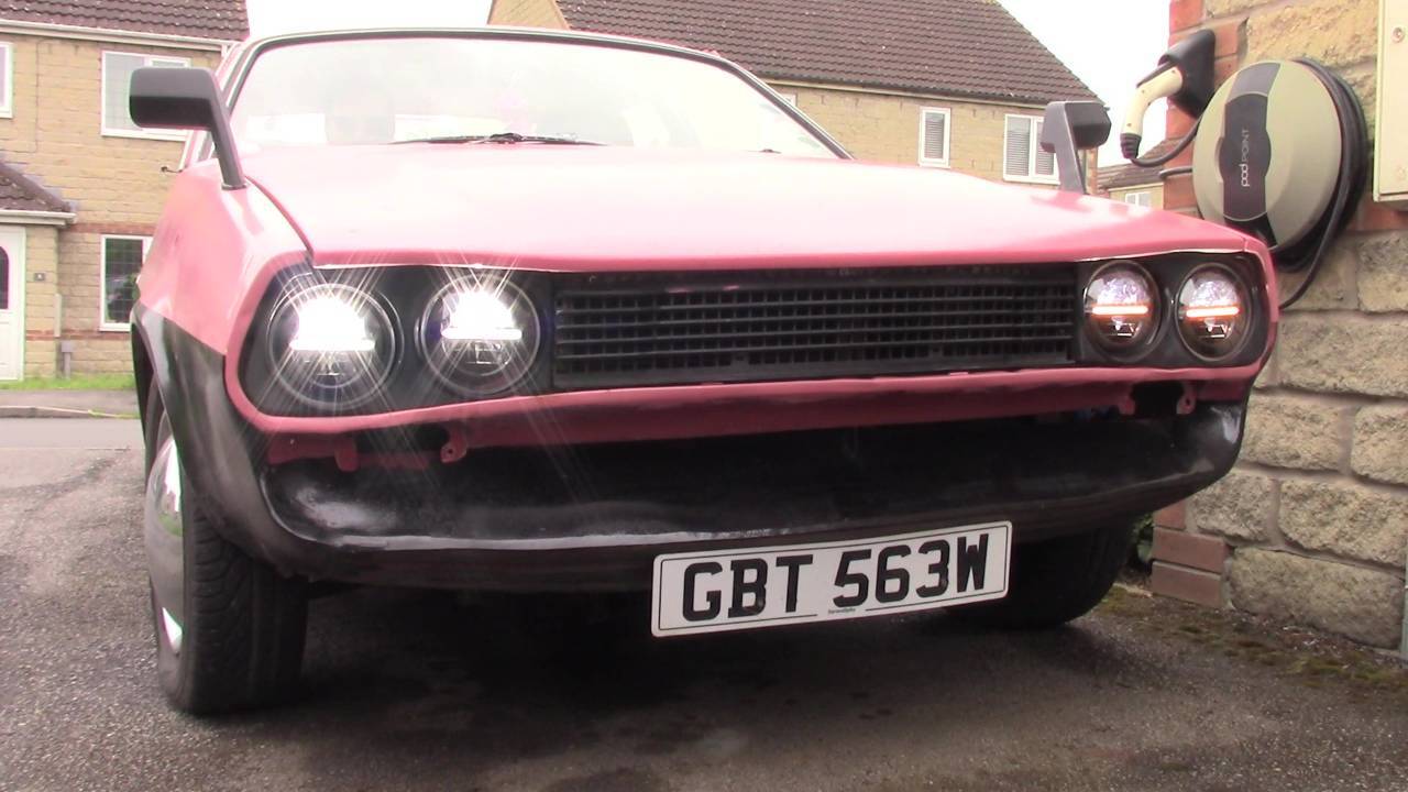

Sometimes, you just have to take a step back and have a think and that's what I did with this.  Why don't I just use longer screws to hold the retaining rings in place, thought I, and then I gave it a go.
Well, that actually worked.  It holds the headlight securely enough that I can wiggle the car with the headlight so I doubt it's going to be a problem!  Did the other side too.
Can't tell if the slight frown is an optical illusion due to camera fisheye and car styling, or if they're actually wonky, they don't look that wonky in person.  Trims are all sorts of wobbly too so that's not helping.  Anyway, by simply using much longer screws to hold the retaining rings these do fit and because the depth of the trim on the front of the Princess is what it is, there's enough space to push the headlights forwards a bit without it looking goofy.
Shall we turn them on?
Umm... yeah.  I reckon those will do and I'll have another pair going on when they arrive so I think I might be okay seeing at night.

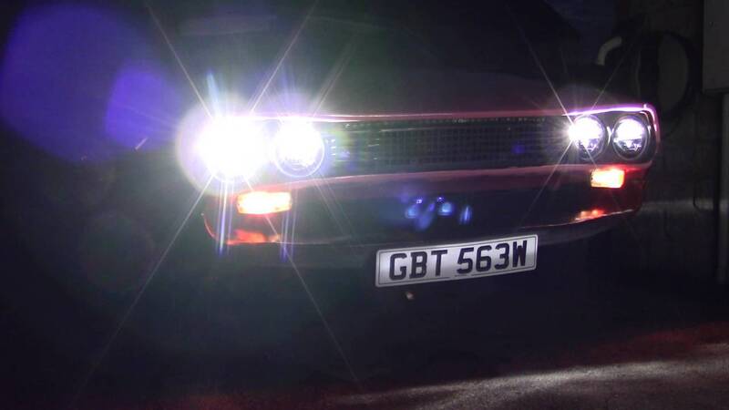

Well... it got dark so I could try the new lights out and wow, I can actually see.  When I was sat in the car to set off and turned the lights on I had to turn them off and back on again to be sure I was seeing what I was seeing, I genuinely didn't expect so huge a light output increase over a much better area.  The other nice thing is because they draw so much less power than the halogens the car in general just seems happier about the whole thing.  I found a dark car park to pull into so I could demonstrate with some photos, very aware of the connotations...
Phone camera didn't know what to do with a head on shot, focus was all over the place, but you get the idea.  Now, when I did the test trundle I did get flashed once by oncoming traffic and it's due to the oblique angle where the lights do dazzle.  They were turning across the road in front of me and I think they got hit by the dazzle.  Everybody else seemed not to notice.  They do cancel out oncoming wanker lights except for one German SUV I encountered so that too is a huge improvement.  I felt a lot safer because I could see more than I think I ever have in any car I've driven.
I didn't change the alignment and honestly I don't think it's far off where it should be if it did move at all.  I can see pedestrians at the side of the road much better now, and reflective signs show up at a more sensible distance than before.  The quality of the light is very blue, a lot of other headlights I encountered looked very yellow by comparison.

Today, the wiring for the second pair of headlights arrived so I fitted them and learned that it must be easy because even I could do it.  The only frustration is I can't wire the indicator and sidelight portions up yet because I could not find a single shop selling wire by the metre, I don't need a whole frigging reel of the stuff, I only need a metre of white and another of yellow... so that's an online order job.
I was a bit surprised at how much I actually like this.  Depending on where the camera is, the lights do end up looking straight or wonky, there's some weird optical illusion shenanigans going on.  I do think I would have still preferred chrome reflectors to the black ones but I don't mind these at all, I think they go well with that slab of black plastic on the front of the car.  When the indicator/sidelight portion of the LED units is wired up, those MG B units will get blanked off and I might move the numberplate up on to the valance instead of under it since there won't be as much clutter around it.
Dipped beam (the camera and the sloping drive is making everything wonky, they look even in person).
